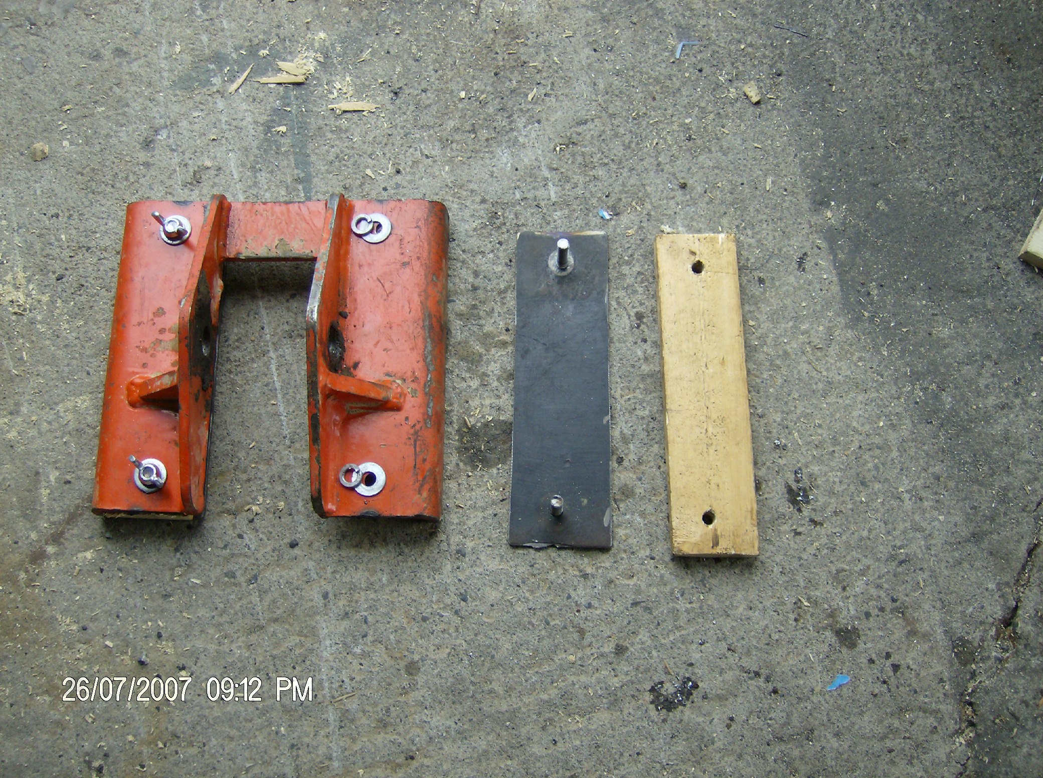

I lifted this idea off the forum here. Someone, cannot remember who, made some out of 2x6. These I made from laminated plywood, glued together and bolted on with 4" x 1/2" carriage bolts. For concrete use. When in soil, easily removed.

Great job on pads looks just like they came that way.

For use on concrete, you might want to counter sink those bolt heads or maybe cover the bottom with a piece of tire tread cut from an old tire.

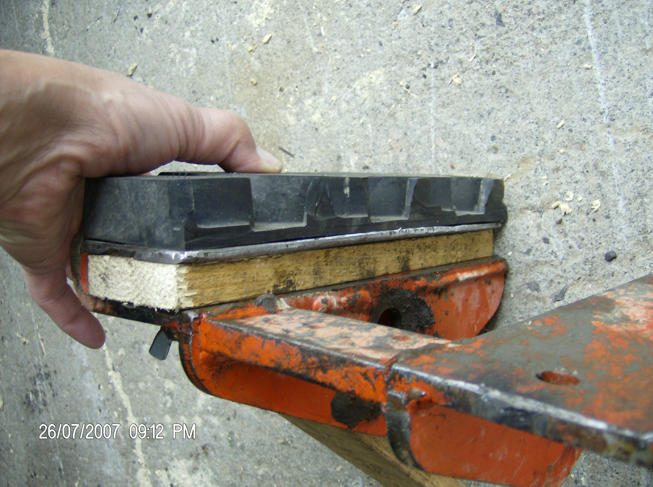

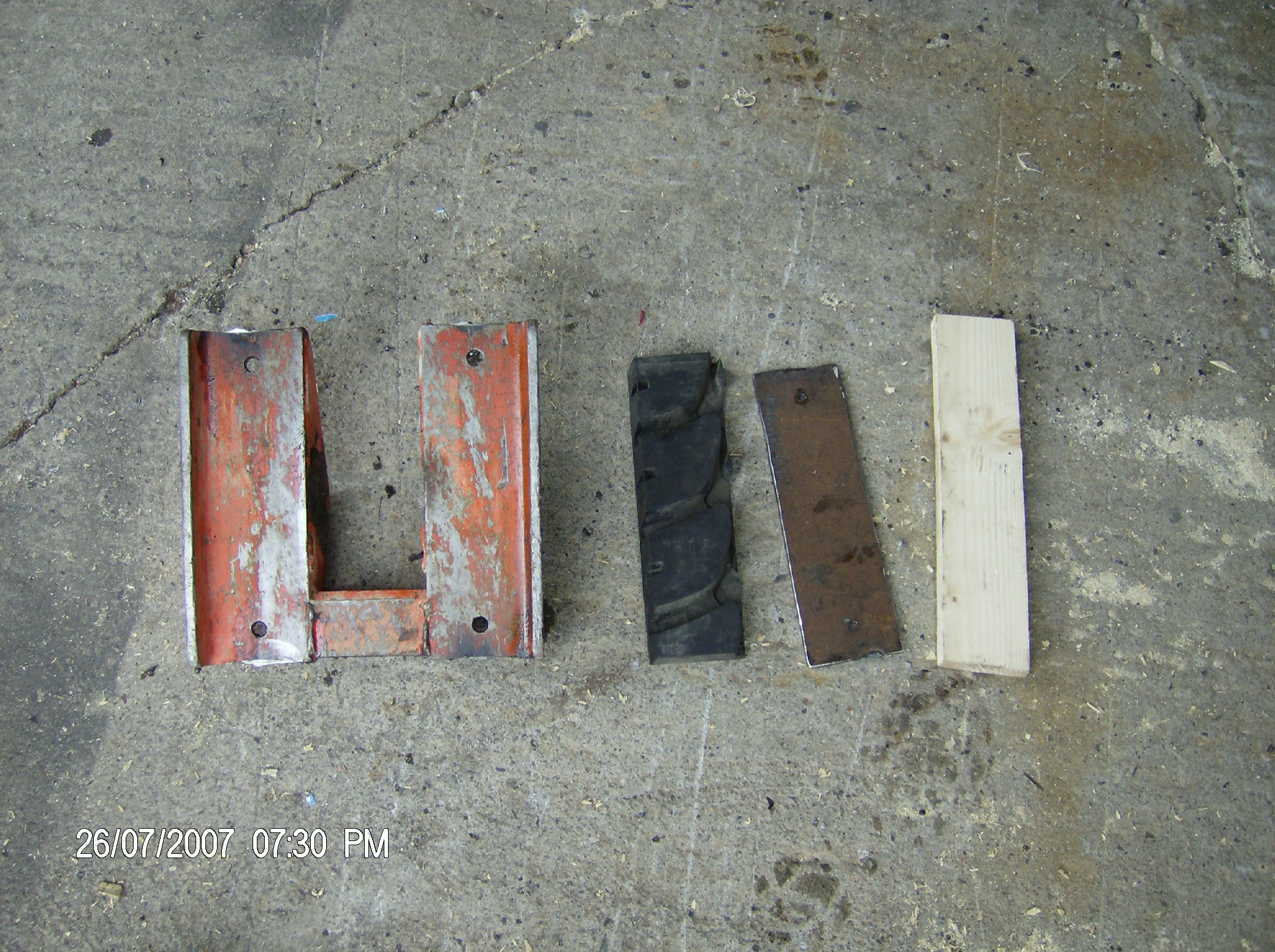

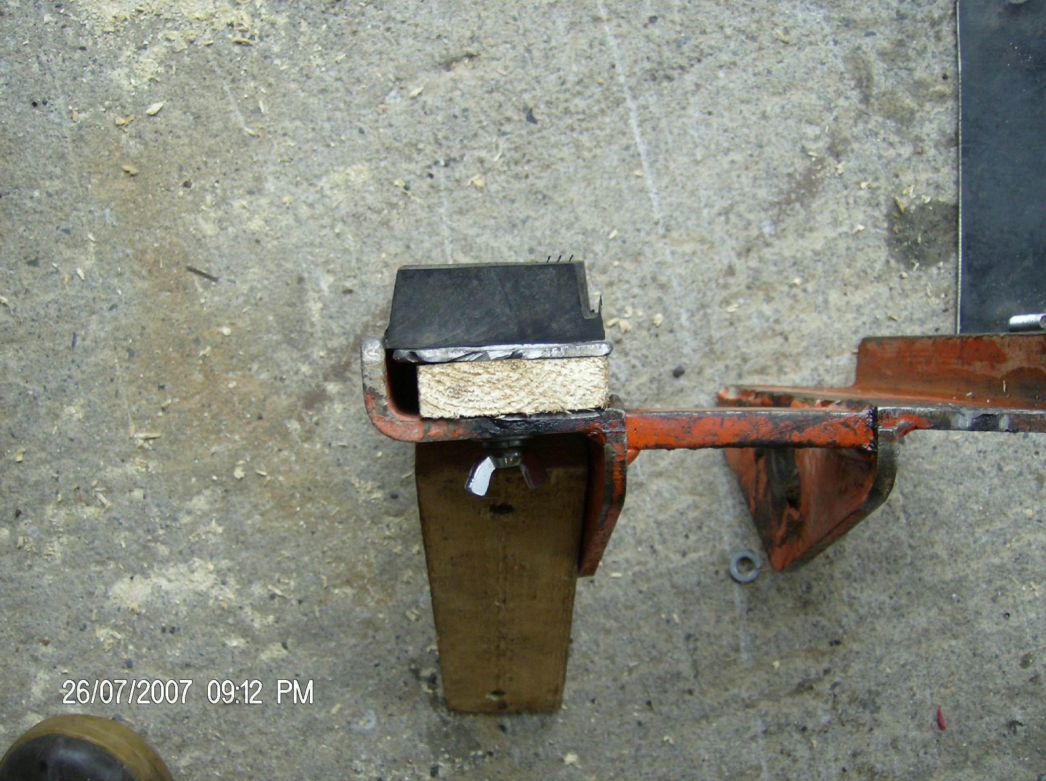

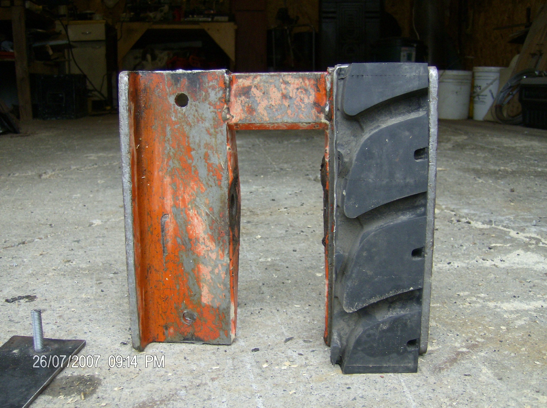

Good job , I made a set but used rubber instead. The rubber came from tire shop. It is the samples of different threads that they sell ,you see them on the walls of the store and they were throwing them out .
