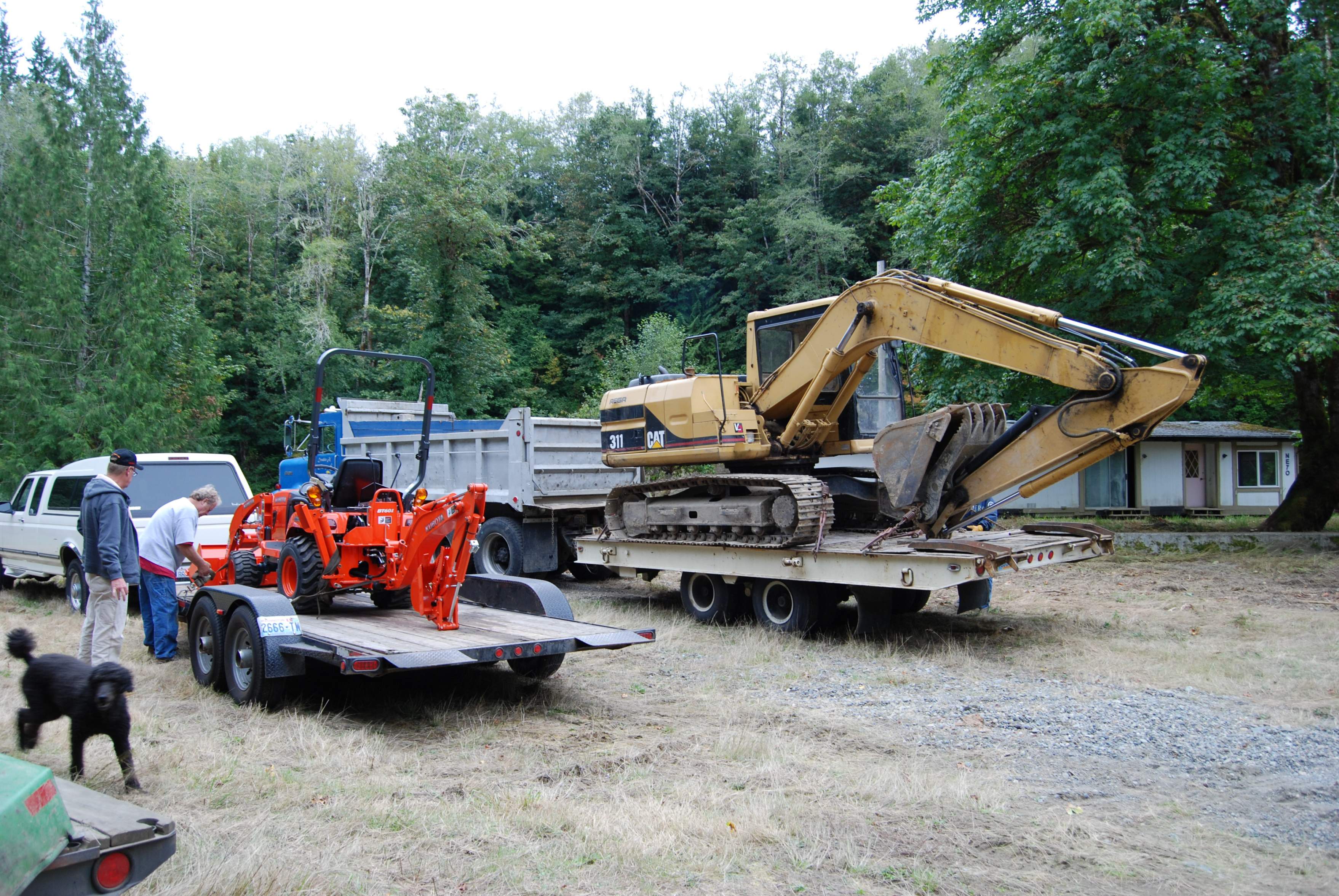

DSC_0006.jpgjThanks for all you coments. The dealer said 300.00+, which would be about 450.00 with tax and shipping.
My husband thinks the BX-25 is a Teramite but it's not.
It's fixed. it has a small dent in the dipper stick like a dimple but works fine.
We took it over to our friends house and they put it in the driveway on some blocks and took a large excavator and pushed down on the arm. It did nothing and the CAT went up on its back tracks. He did it again and nothing. finally he raised the bucket and hit the dipstick nothing happened so he hit it again and the thing bent right back in place. It was pretty amazing, I had my eyes half closed invisioning the worse but they put a straight edge on all sides and it is perfect.
I'm real sorry I didn't get to get any pictures but I do have one of the CAT that fixed it.
I hope I did the picture upload right.
No insurance.
Thanks for all you input.
