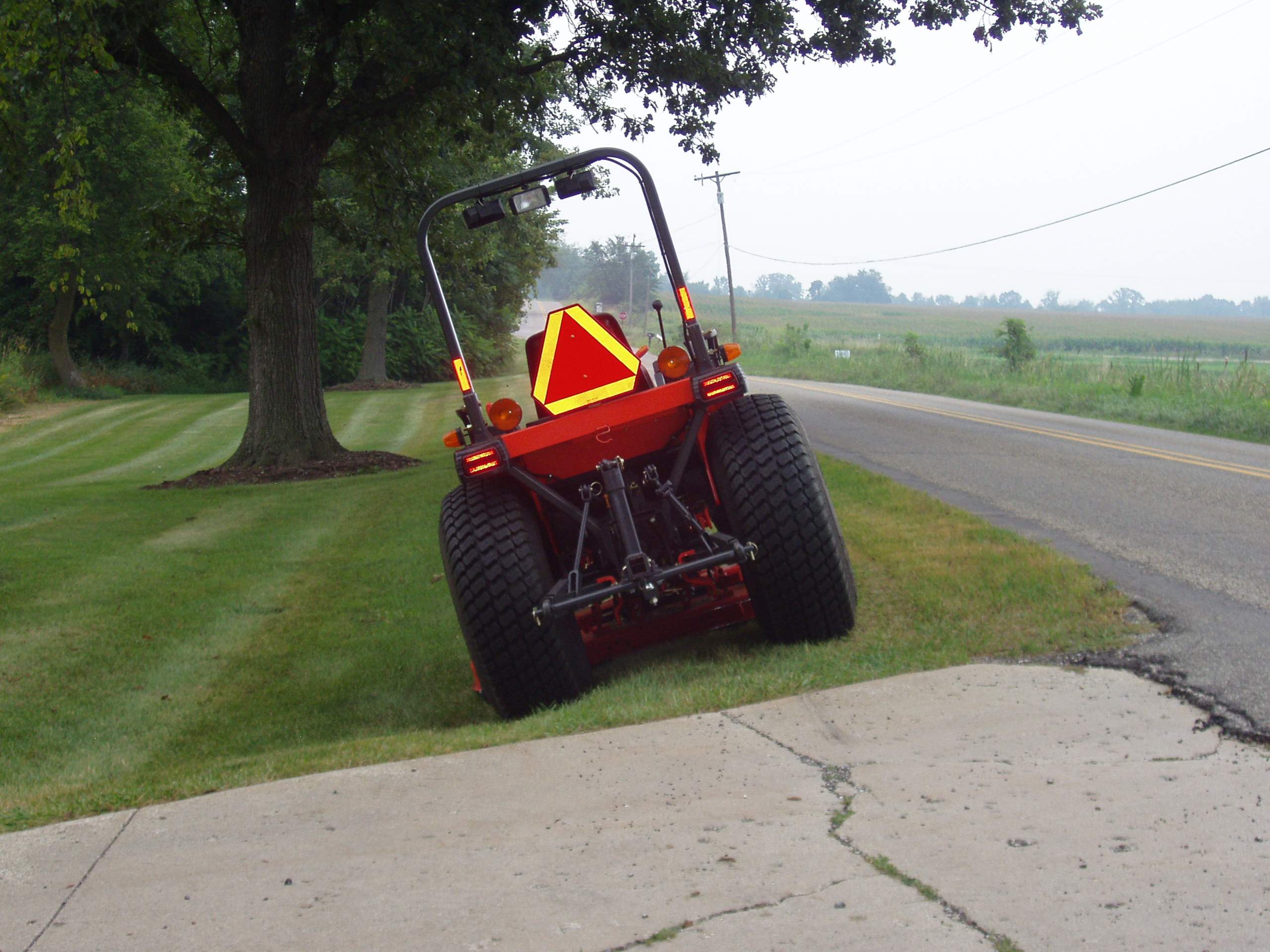

For stability on side hills and uneven ground I think a B2630 would be a good choice. I have Rimguard loaded turf tires on my B3030 and it feels very stable to me. Bigger and heavier is always better for providing a more solid platform. Everything has it's limits, but size does matter. You can put rear wheel spacers on the B2630 if you feel the need. The 14" ground clearance is a plus in my book. The MMM is easy to R&R. I have a 60". It just rolls under the tractor without a problem. The 72" should be just as easy. Good luck with your decision.
Here is a picture of my tractor on the steepest part of my property. While it was setting there I tried to push it and get it rocking to see I could get it to start to tip over. No chance. I couldn't even come close to getting the highside wheel off of the ground.

That 3030 is a good looking tractor even without the cab! From your picture, I'd say that slope looks like less than a foot over 5 feet (the width of your mower). That would be less than a 20% slope, right? That should be fairly safe, but the tractor does appear to be quite tipped, and, if I were on it, I would be creeping along carefully, feeling it out.

Thanks, timswi, appreciate the opinion!
