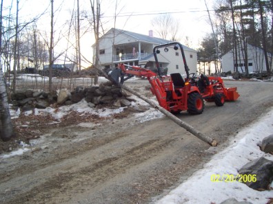

Did any one in new england get any wind over the week end.Heres a pic of my thumb holding up a blow down to keep it out of the dirt as i sawed it up.Shes all painted and pretty now.

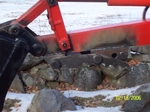

A closer look.

Lots of wind here. Blew my neighbor's roof right off his house down the road. The roof and the tree next to it ripped the wires right off the poles. Wires were wipping on the poles. It was nasty. We were out of power all day. I've heard folks over in NY by Lake George are still out of power and don't expect it to be back until Thursday! Very violent storm indeed. It shreaded our kids heavy duty swing set and blew the windows right out of one of our barns....ripped the light weight shelve set off the inside of our garage and everything with it.
/ bx-23 thumb testing #14
</font><font color="blue" class="small">( Did any one in new england get any wind over the week end.Heres a pic of my thumb holding up a blow down to keep it out of the dirt as i sawed it up.Shes all painted and pretty now.
ALAN )</font>
Yes but no damge in my yard
