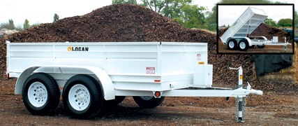

What kind of dump trailer did you end up getting? Was this a dump trailer to be hauled behind the BX23 or with another vehicle? I ask because I have been thinking of the same thing - a dump trailer would make for much less trips than hauling everything in the FEL bucket. Got any pics?
/ BX 23 and power questions #9
Jim, attached is a pic of the type of trailer I'm getting. Unfortunately, it was supposed to be ready yesterday but wasn't. I wanted something I could use as a highway trailer too. It is 5' x 10', elec/hyd pump, 7K GVW, elec brakes, large battery/tool box on tongue, ~$3300. I don't really plan to pull it with my BX cuz I have an old Dodge Ramcharger "ranch vehicle" that loves that kind of work /forums/images/graemlins/wink.gif
I had them put some D rings inside so I can trailer my BX if necessary.
