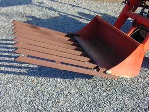

Hopefully!!! /forums/images/graemlins/confused.gif Here is a link to some forks a fellow TBNer made.. Hmmm how do you create a link to another thread? /forums/images/graemlins/confused.gif /forums/images/graemlins/confused.gif
In the Build-it-yourself forum, HomeBrew2 made a very good set of "brush forks" for his BX... The post was on 8/29/05

/ BX 2230 implement for compost pile? #13
Here ya go (attached).
Cheers!

/ BX 2230 implement for compost pile? #14
Thanks for your help!
#15
That setup looks great. Now... how to convince the wife that a tractor without a welder is like...hmmm
