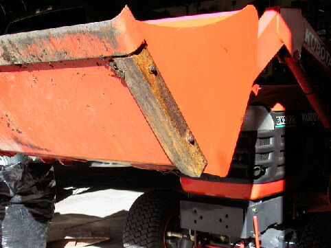

Tom,
Here's a picture of what I did. You can kind of see how I hammered a slight contour towards the rear of the loader. They are attached with two machine screws, 5/16" as I recall, through the side of the loader. I take these feet off in the summer for dirt and mulch moving.
I plow with the loader in the float position with a slight tip forward for the best scrape. While a rear blade would be a nice addition, the FEL works so well for me that it is tough to justify it. My driveway is about 150 feet long and fans out to three cars wide at the garage end. With these feet I don't scratch the blacktop at all.

Rock,
Thanks for the taking the time to take a picture and posting it. Looks pretty easy and if it does not mark the driveway, the boss ( wife) will be happy, and that is always a good thing!
I think I will try this before spending $100 for rubber strip on the bottom of the bucket.

Just an update….
Tried the angle iron on the edges of the bucket, it helped a bit, but still marked up the driveway. I replaced the iron with a 2x4 using the same bolt holes, and held the wood about a ½" below the lip of the bucket. It worked like a charm no marks and the bucket moves along on the ground. Helped the neighbor move 20 yards of top soil and then I moved 15 yards of mulch. Never new those jobs could be so fun! Mulching which took forever and killed my back was done in less then 2 hours. Thanks guys for suggesting the FEL, even the boss likes it and now see why I spent the extra $$ for it. This BX 2200 is just a fine machine!
