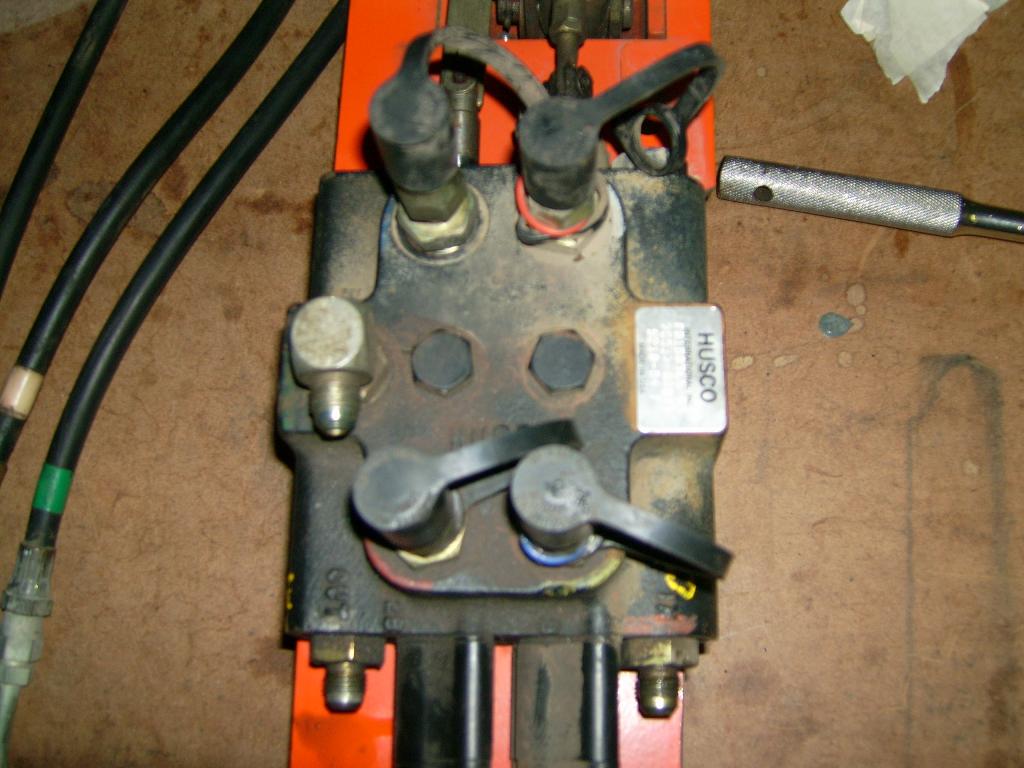

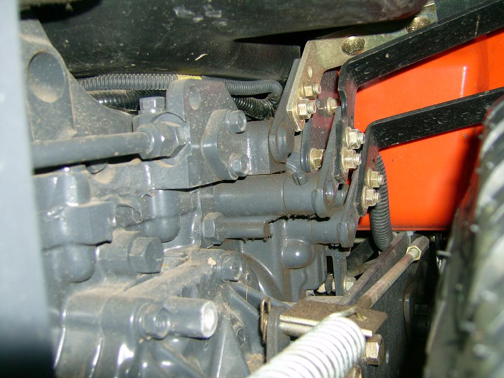

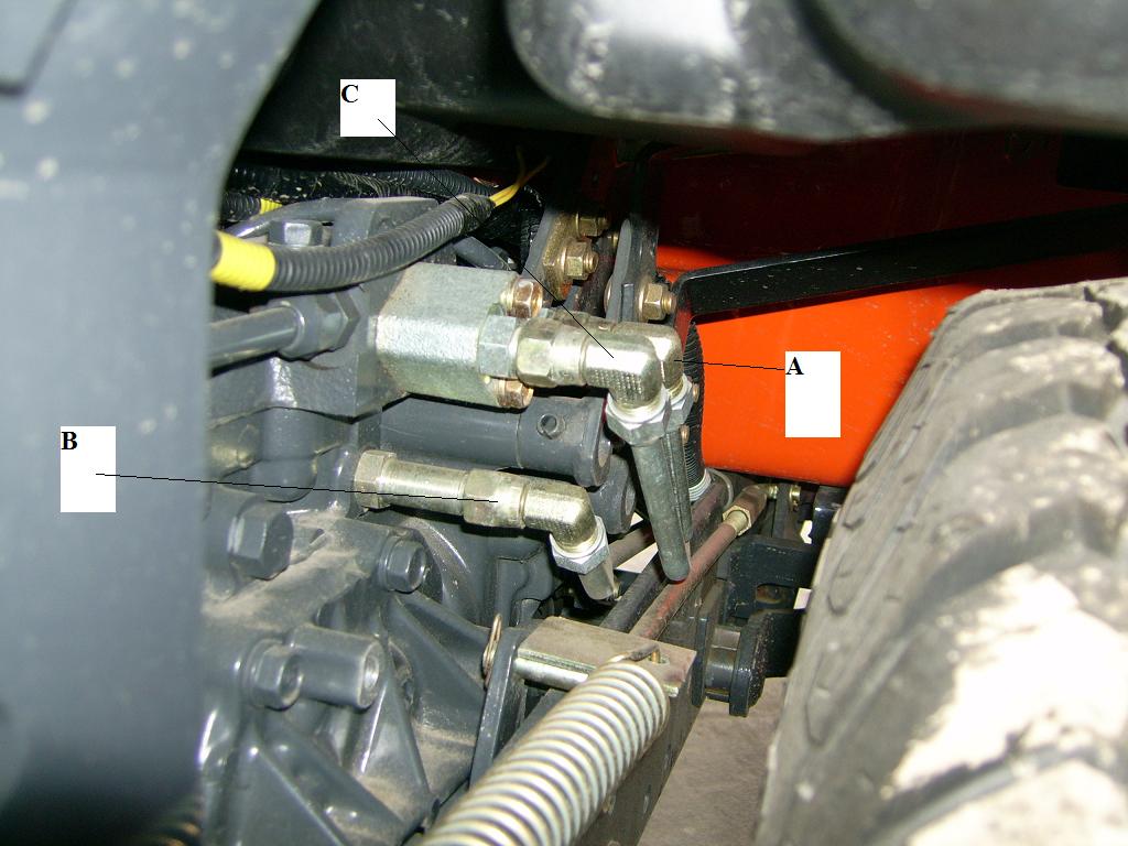

Hi all.
Iam trying to plumb a 4 way husco FEL valve to my BX. Attached are some pics of my tractor and the valve Iam trying to connect. Also included is a pic of a new tractor line connection with the ports marked A, B, & C. What I need to know is which port from the tractor goes to which port on the valve. 2 of the ports on the valve are marked in and out. I do have the block to mount onto my tractor as well as the hydraulic lines.
Thanks in advance for your help.

scarlo101, Here is a hyd schematic and a loader valve block valve info sheet. I hope this helps. I all so have a sheet on the Aux. hyd. valve install but I would have to scan it.

Using your posted picture, Port C would go to IN on your valve (power). Port A would go to OUT on your valve (return). Port C is the drain (to tank). Again hope this will help.
