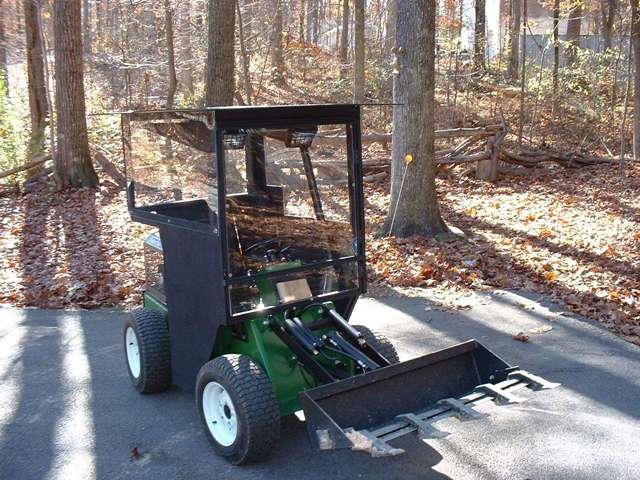

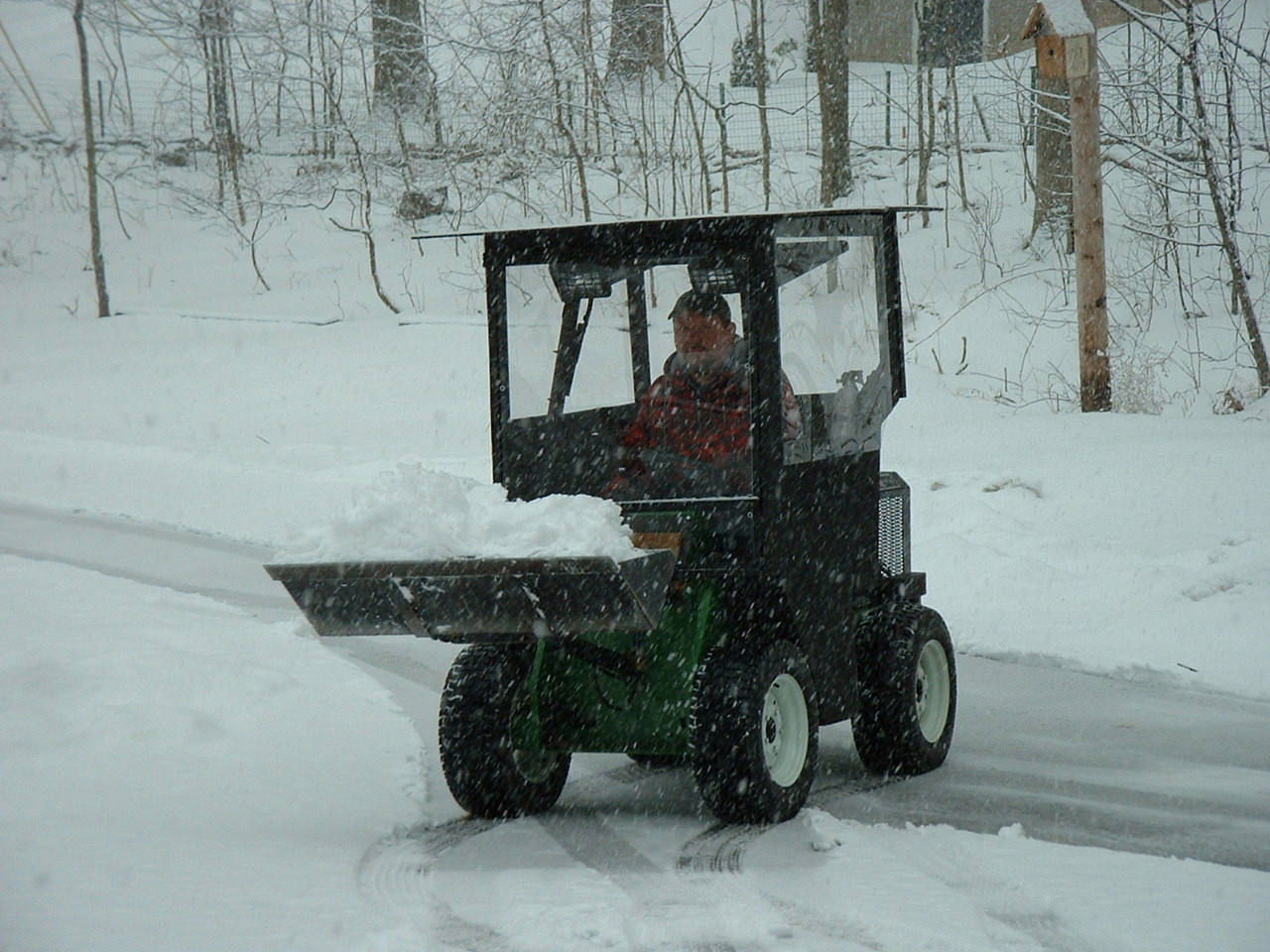

I know this is a Kubota site but, here are a few pictures of my little Power Trac 180 4x4. I sold it to my neighbor before buying the BX. I used this little machine the previous 3 seasons for everything from digging a pond to removing snow. It shows the homemade cab I built out of wood, it kept me nice and toasty warm. I had everything inside including a coffee cup holder, toolbox, walkie-talkie setup. You can't tell by the pictures but, plenty of room inside.

Barry,
I really liked the homemade cab on the Deere and something else popped out at me that I've read some threads about and meant to address. People ask why, if there is a potential clearance problem with the lights on top of the ROPS, didn't I mount them on the side or underneath? The side mount was out because I ripped the right rear amber flashing light off almost immediately after delivery, so paranoia set it. I tried the spots underneath the ROPS and not only got the 8 foot shadow of my head in front of the tractor, but also felt like the hood of the "much made fun of" snowmobile suit was melting into the back of my brain. I get plenty of light from the top mounted halogens and just find that I have to adjust once in awhile for hitting larger tree branches, etc. Are your halogens mounted, as they look, in front of your head? I like it. John

Hey John,
on the Power Trac you see in the picture, I mounted the same set of halogens that I now have on my BX. They were mounted to the front of the ROP´S as you can see inside the cab. On my BX I mounted a set like them to the front of the canopy that I made. They work well there with the exception of a little vibration that I will sure up this spring. The BX has been setting in the garage most of the winter. I taker out once in a while to keep the battery charged. When the weather breaks I have a lot of plans for customizing the little bugger to meet all of my needs. I will have to take some pictures with the lights mounted for you this weekend. They come in great for doing loader work and removing snow. I can see everything, even back in the woods they light up the whole area.;) I also have one mounted on the back cage for lighting up behind me. Just a note I rarely have the front stock lights on along with the work lights. I don't want to drain the battery down. And after using them a lot. I let the tractor run for a while to recharge just in case.

Barry, Good job on the lights and I'll look forward to seeing the new mounted lights. I tried mounting forward of the bar, but my head height was just close enough to either be bumping them all the time or getting the giant head sillouette in front of the blower. It's hard to see in the pictures I've posted, but I mounted the square halogens forward (again for just a tad bit of added clearance getting into the garage) and I was able to mount a round spot light underneath the ROPS facing to the year. I have that on a separate switch for the backing needs. The forward Halogens come on with the headlights. As these projects go, I thought yesterday would be a good time to have my neighbor, who was going to Sears anyway, pick me up a new quad post battery with higher CCA's, etc., so he did. We went to mount the new battery, set it on the floorboard of the Kubota and watched helplessly as we stepped back to get a wrench as the thing slid off and fell about 8 inches to the ground and cracked the outer plastic casing. Then we notice the small piece of left over ice chunk sitting where the battery had just been! Just one more day in the life of Dyer, retired! The Sears guys were very good about replacing it saying, "Well it does have a 3 year, no questions replacement warranty with it, so we can probably replace it within the first 3 hours o.k." I took it because it was hard to blame anyone for the predictability of it all, ha! Dyer, retired

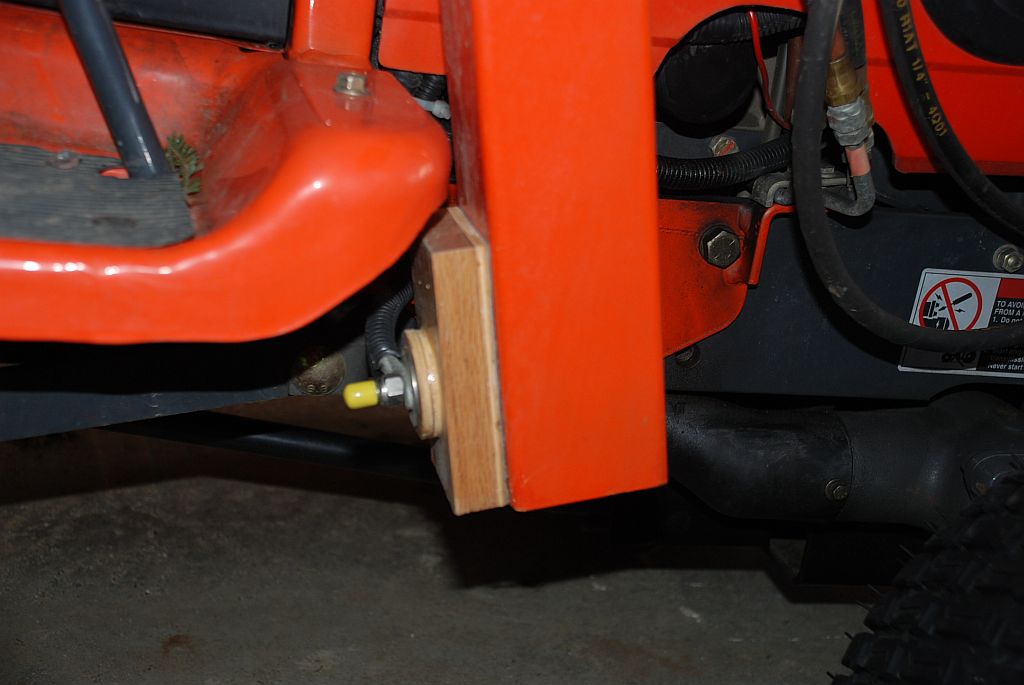

BarryH,
These are the shots of the jumper post I put on to allow me access without removing the dust screen in front of the battery. I just ground to one of the frame bolts. The block of wood is attached to the frame post with Scotch foam tape and has been on there for 3 years, so I guess it made it out of the weather just enough to hold up. Now with the new battery and better maintenance charger, I'll probably never need it again. John

Like your battery jump post smart move. I take it there is no way it could accidentally touch metal and short anything out? I would have it all covered just to make sure. Good idea and a great way to access the battery. You mentioned surgery what did you have done if I may ask? Hopefully it wasn't to painful and your feeling better now.

No problems with the jumper post in 3 years. I have rubber cover on most of it and nothing ever has the ability to get down and short it out, so far anyway. I think I will cover it a little better now that I probably won't find the need to use it as much with the new battery and maintenance charger on it's way.
