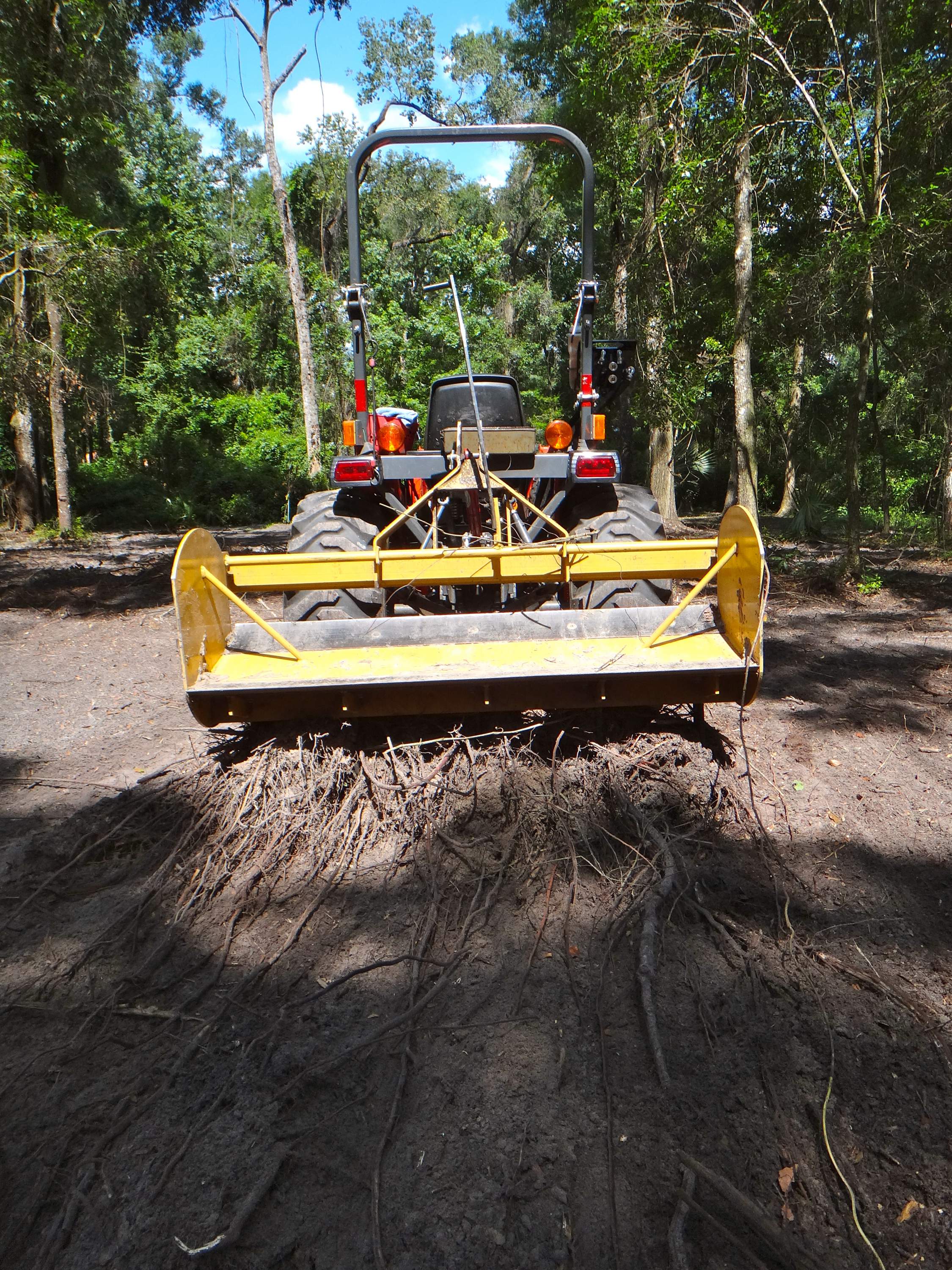

My Kubota B3300SU has a rear tire width of 59". I pull a 60", 630 pound Bush Hog (brand) Rollover Box Blade.
In Photo #1 it is moving dirt. In Photo #2 the rippers are down and it is tearing out wild grape roots.
