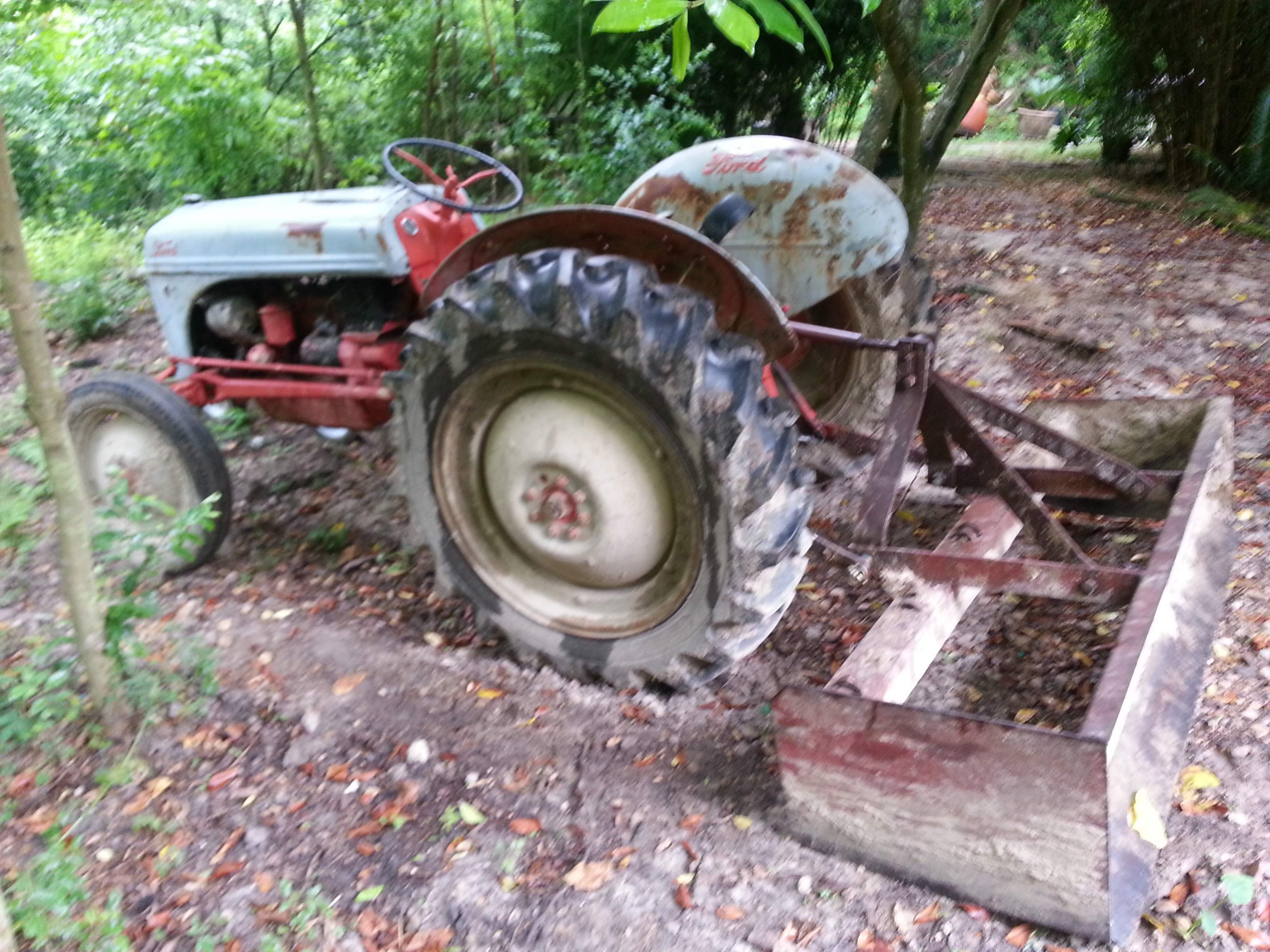

Thanks agin for all the help.

It'a a 8N, sorry I was told wrong. View attachment 323591
Great looking old gal. Spend some time with that box blade and get used to how everything works. Adjusting the top link and the side link takes practice. You'll be able to do a lot with it.
By the way, it looks like the rippers are missing from the box blade. They go in those slots along the square tube at the front and are for digging into hard ground. If you didn't get them with the tractor, you may want to look around for replacements.
   / Buying my first tractor. Help pointing me in the right direction please.
#16
I do have them just not using them ATM. I like the old tractor for sure and have already done a ton.
