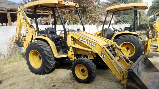

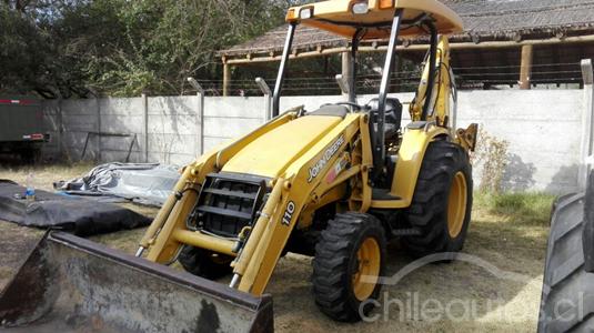

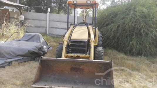

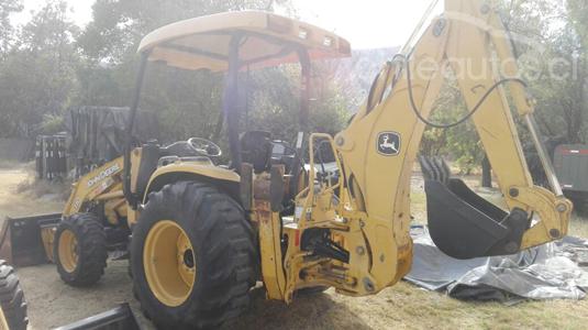

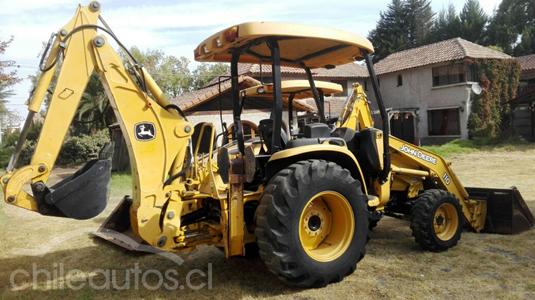

Hiring out bigger tasks is an obvious option and was my first thought, too. But one of my plots is a day trip from the next rental opportunity (at least one that I know of) and machines are only rented out with operator and paid by the hours (generally around 35-40 US$ an hour, machine plus operator). If it arrives trailered (an option that not all rentals have) I will have to pay for the truck plus TLB time during transport process and if a TLB comes un-trailered it takes forever. So if I cannot finish all heavy machine task in one block or if I find that after the main work is finished something has to be added or improved it will cost me another two days of machine just for getting the machine to and from my plot. The other consideration was that many jobs extend over days but require only machine assistance for lifting something or bringing material once in a while (e.g. building the bridge over the creek) during which the actual working hours of the machine would be minor. Nevertheless I would have to pay every hour the machine and the operator sit and wait...
You may say that for the money that an own machine costs you can pay a lot of hours. True! But I made some rough estimations on how many machine days I would need just in the construction phase and came to the conclusion that this could already cover 2/3 of the acquisition costs. Of course you have to add fuel and maintenance costs, but then it also shows that tasks always take longer than originally expected. On the long run, working in the woods etc. I am pretty sure that it would pay off within few years (actually after around 100 working days with a machine that costed me 27.000 US$). This under the condition that the machine lasts a couple of years and repair and maintenance costs remain reasonable.
Concerning time savings my experience is that if I hire out earth movement jobs I have to be present most of the time at the work site anyway. There always happen unexpected things and I never had an operator who understood from the beginning what exactly I wanted and they generally do not care too much for collateral damages. Plus, when renting out I feel more stressed by the time pressure and by the fact that I have to give instructions for getting the result I want, but at the same time being careful not to piss off the operator. I have not been working with such a machine yet, but my job is mainly in front of the computer, so I enjoy physical and outdoor work for a change and I imagine that doing those jobs myself is more fun and less stressfull and may provide better results (which all remains to prove). I believe that earth movement will always be a considerable portion of the tasks, so a TLB with 3PH and PTO may really be the way to go.
Concerning the JD110 TLB for sale in Chile: After some back and forth it showed that the seller is a professional re-seller who imports used machines from the US. Does not really strengthen my trust in him with the story he told me before. In fact he seems to have three JD 110 TLB on sale of which one does not have third loader function so I discarded that one. From the other two one has 3600 hours and is from 2004 and the one that I described before has 2950 hours and is from 2007.
He did not answer specifically yet, but I am pretty sure that none of the machines has 3PH nor the 3 rear remote hydraulics with diverter, nor hydraulic thumb. How complicated would it be to add those elements? He offers an additional trenching bucket, but that will cost extra...
I do not know how I could see if the backhoe has seven functions with the boom mounted hydraulic couplers? I count 5 functions: left/right swing, boom up/down, dipper up/down, bucket rotation in/out and the stabilizers up/down. Or does that mean that there should be four further couplers (2 pairs) available that need to be situated on the boom? One pair would be for the hydraulic thumb and the other? Attached the photos from the ad.
I am pretty sure that I could take a mechanics with me to check the machine if only I knew a good one? never owned a construction machine, so I never needed a heavy machine mechanic.
I doubt that there are maintenance records, taking into account that these machines have been imported second hand
I have to admit that I am somewhat reluctant to buy a machine with almost 3000 hours, I have already too many things that require constant repair (and I hate to go for accomplishing something but at the end of the day I only did repairs on my tools...) I will try to find out if the guy could eventually import a machine with less hours and a configuration closer to what I want. Apparently, he has someone in the US who looks for and buys these used machines...

If they are imported machines then you will be paying all the import fees as they will be included in the cost.
You might contact JD to inquire about buying & importing a used machine through a dealership. Perhaps there are returned leased machines from JD that could be available for resale. This might also give you broader range of type and size of equipment available.
3000 hours on industrial equipment that has been properly maintained is probably about 30 -40% of life expectancy for the equipment. .????
on the local unit available follow your instincts. There is always another tractor available.

I have to say that the JD110 is a great sized machine for a farm but without a 3 PH it is just a backhoe. I have a Kubota B26 and am amazed at the work it will do. It isn't the fastest machine for digging but it is strong for a 26 HP 4000 pound machine.
I bought mine used with just 68 hours for $20,500 about 5 years ago and it has done a lot of work for me. It wont be as fast or strong as the 110 but they come standard with QA FEL bucket, 3 PH (lift arms and attachments might be extra though if you are buying new). Mine came with the lift arms although I have not installed them since I got it. I have a much larger tractor for my 3PH work and only use the B26 for back hoe work. I am sure that a B26 would handle much of the work you are needing done. I assume an L 45 would be much better and faster but I have never used one of them, but in most instances, bigger is always better.
A hydraulic thumb on a backhoe is almost a necessity since it increases the uses a lot. I use mine to pick up trees, stumps, rocks etc rather than using my back muscles which aren't as strong as they used to be.
The biggest thing to look out for with a TLB is loose or extremely worn pins in the swing arms, dipper and bucket. These can be hard to replace if worn excessively. It is very easy to see by just working the backhoe to see how much slop it has. A little is to be expected on a 3000 hour machine but may not be a deal breaker if not excessive.
Leaking hydraulics is another item that can be expensive to fix if on the cylinders. Leaking hoses can be pretty cheaply replaced but might be a little time consuming getting the old ones out and new ones in since they all should run thru the booms with little to no hoses hanging out like the one in one of the photos.
