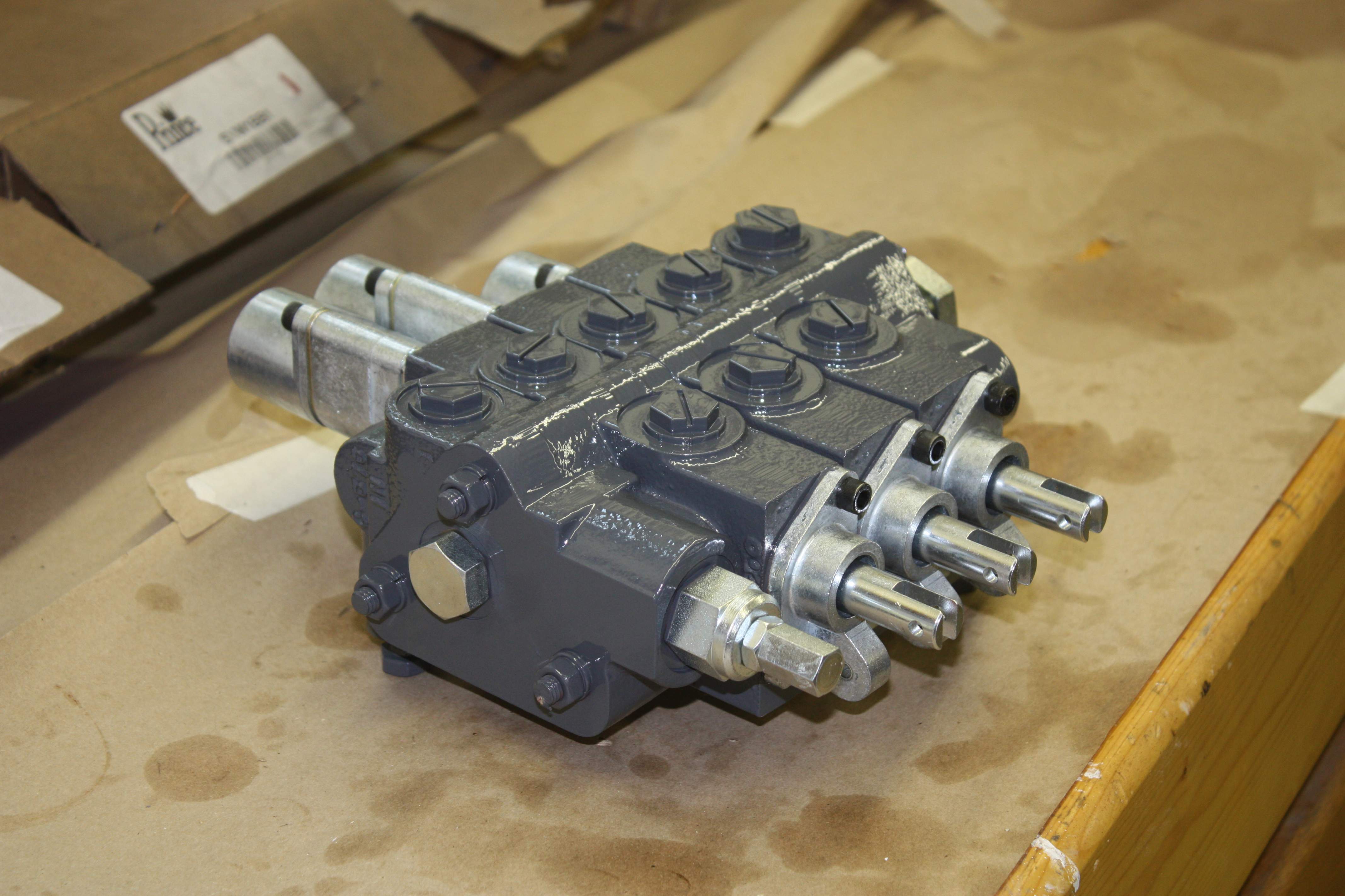

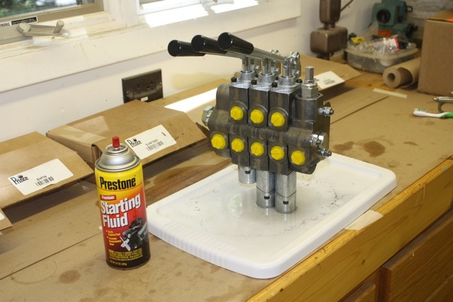

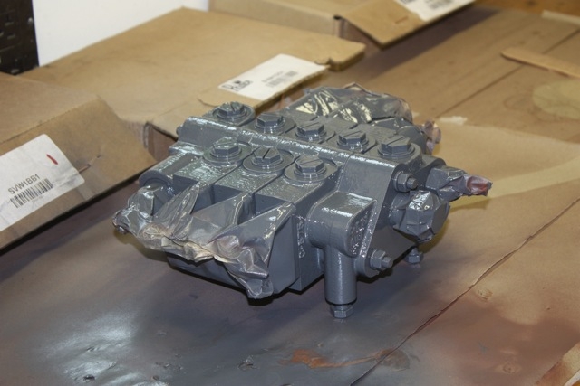

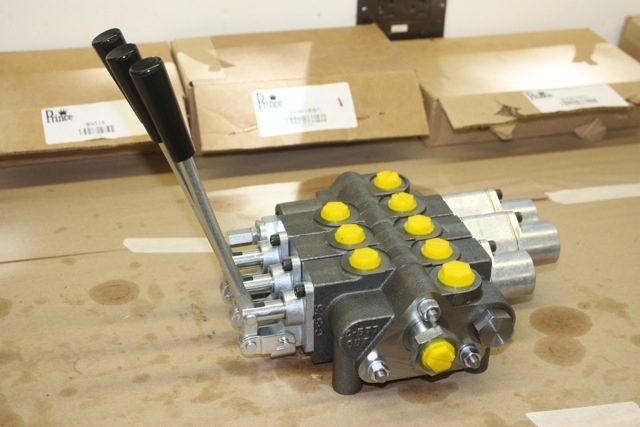

Attached are photos of Prince SV valve I bought to add rear hydraulics to my B2710. Here's what I ordered, it has 3 valves made of these part numbers:
2- SVW1BB1 Dual acting spool, 3 position spring return with detent
1- SVW1DD1 Dual acting spool, 3 position plus detented float
It was $383 with shipping.
It comes shipped with each section individually boxed, there's 4 o-rings between each section and 3 tie rods that compress the whole stack together. Here's some photos of putting it together and painting it. You can see the shipping boxes in the background. Each section is in a plastic bag covered with oil, and the casting is really rough, so I washed it with starting fluid so I could get all the oil out of the little spaces between the castings. Then I masked off the aluminum and finished parts, and primed and painted the unfinished casting gloss gray to match my ROPS. Next step is to build a plywood mounting plate so I can experiment with how to mount it before I make something out of steel.

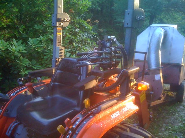

I have a three spool SV (spring returns only) on my B2910 (also painted Kubota gray :thumbsup:)
It's currently mounted (vertically) to the ROPS on my left side ..... but I'm planning to move it over to the right side and further back (and hopefully keep the SUDT drool off the tractor :mur:) ... since it's easier for me to turn to my right when looking back.

I was thinking vertical on the right side, but I was concerned it will block my view when I turn around to get a good look at what I just ran over.
Yup - you need to maintain a clear view of what's happenin' in the back ....
Didn't think about the drool factor.
Go have a peek at the valve for your FEL around the QD's ..... if it's anything like mine, you'll get the idea ;)
I'd like to put it off to the side of my right arm, above the 3pt lever, but the tractor runs into a lot of low tree branches, and there's not much room there to mount anything. I've already knocked off a few flashers, they're not cheap but nothing like damaging a valve.
Yeah .... that would be ..... pricey .....
So I was going to try mounting it vertically on the inside of the ROPS.
That's how I have mine mounted - inside the ROPS (but on the left side)
Also I used a piece of 1/4 steel plate as the mounting surface - which is on the outboard side (the valve is inboard of the steel plate) - so it serves as a bit of a protector of sorts ....
I'll see if I can snap a pic later today and stick it up here - you be able to see the positioning .... and the drool issue ;)

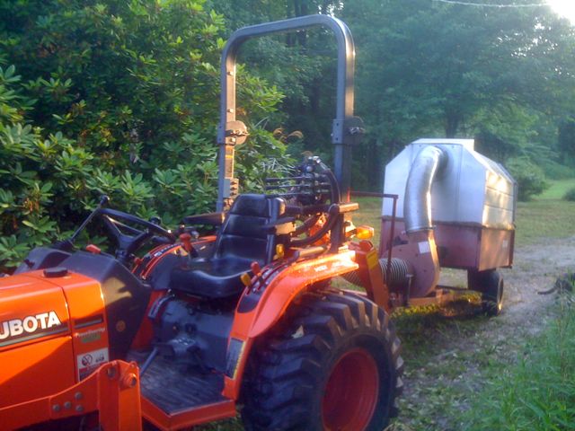

Some pics of the mount I welded up for the Prince SV valve I'm using for my rear remotes. It's made out of 1/4" wall 2" square tube and a piece of bar stock (maybe 2 1/2" x 3/8" or 7/16" by roughly 5" or 6")
I drilled out 2 holes in the bar stock to match the two bolts in the ROPS and then picked up a pair of longer Grade 8 bolts (inch, not metric) at TSC that were close in diameter to the originals.
It's been a sturdy mount, but it needs to be on the right, as that's the side I'm more comfortable turning to ...... lower down to avoid blocking my vision ..... and further back to allow easier access for attaching/detaching the lines ....... and to avoid hydraulic drool on the machine (most of the grass that is on the rear below the valve is there because it's stuck to the tractor by hydraulic oil) ....
Not sure if I will keep the vertical orientation or lay it horizontal .....

What is the little box mounted on your right ROPS?
/ Buying and assembling rear remote valve #10
Good eye :D
It's a plastic, weather-proof project box that I installed three toggle switches (with rubber covers) in - the top switch and bottom switches control the front and rear work lights on the removable light bar that mounts on the ROPS.
The middle switch controls power to an accessory outlet (cigarette light socket) on the back of the tractor that I use to power the 12v electric pump on my boom sprayer.

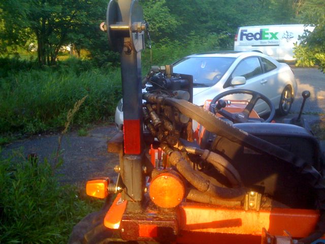

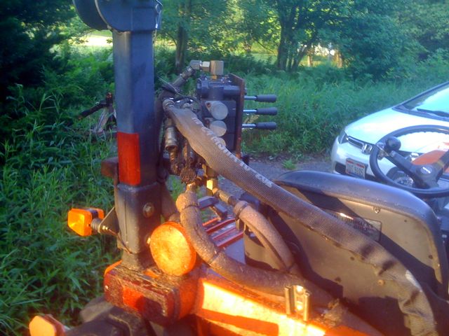

here are some pics of the way I mounted my valve.
the valve has 3/8 qd's but I have a set of 1/2 qd's on the power beyond to be able to plug in my father in laws splitter. and I don't need a valve with detent since the power beyond has pressure all the time
What sort of gear are you hooking up to your valves?
I was wondering if you found that location to be very convenient/accessible, but I guess it depends on what you're using them for and how often from the driver's seat.
I'm still undecided about how to mount mine... the layout of the valve bodies vs. goofy lever throws doesn't do much to help.
/ Buying and assembling rear remote valve #14
I have to agree with you on that. I've been looking at various valve asemblies, and none of them are really convenient for where I want to put my valves.:(
/ Buying and assembling rear remote valve #15
so far I have hooked up a top link and a snowblower deflector and rotation and also a splitter on the 1/2 qd.
the qd's are very close together but it hasn't been a problem yet, they are two way qd's so I can pull or push the outer sleeve to hook them up.
I turn to the right when I blow snow so that just seemed to be the logical place to put it and I wanted it on the inside for protection. the angle on the back plate gives my shoulder more room but three valves is the max with that angle because it does come close to the seat.
I like it .... think that may be about where I'm gonna relocate mine to ...... :thumbsup:
