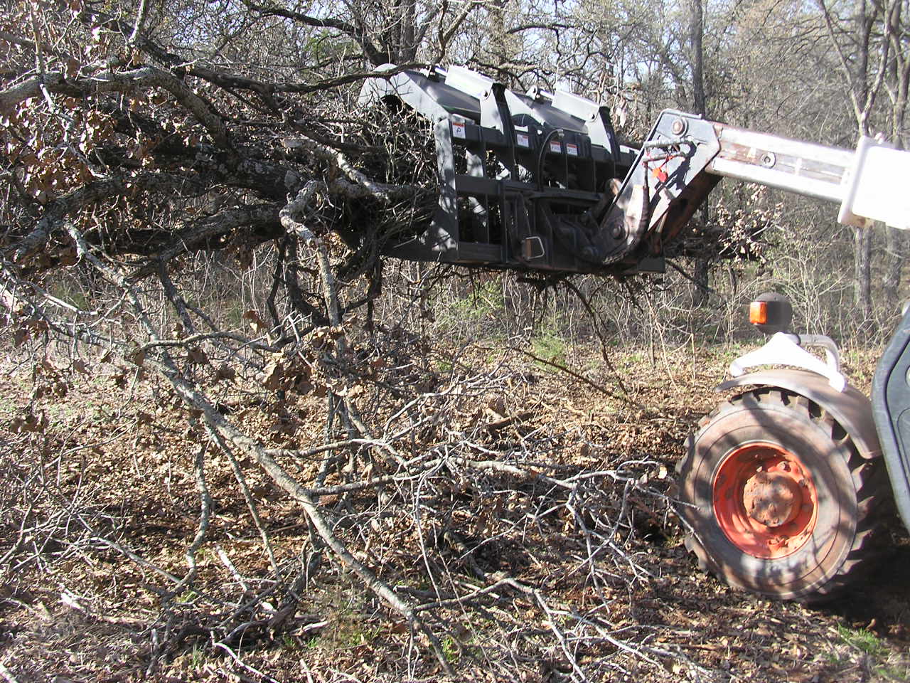

It also runs a vibratory roller well and I've seen a lot of other attachments like harley style rake, box blade, grader, etc. I imagine you can find a lot of uses and the best part is, you can use it when you don't want to tear the ground up. For example, I took mine to a job that normally would only have my Bobcat on. I needed to carry a lot of brush to set up for the mulcher but it's been raining. Job needed to get done and toolcat barely left tracks. My bobcat would have torn the place up.. I used the grapple that's not rated for it (industrial fork grapple) but it worked very well.

Also to the guy who has the monster grapple on the front? How have you not bent or broken your lift arms? Besides being very careful?

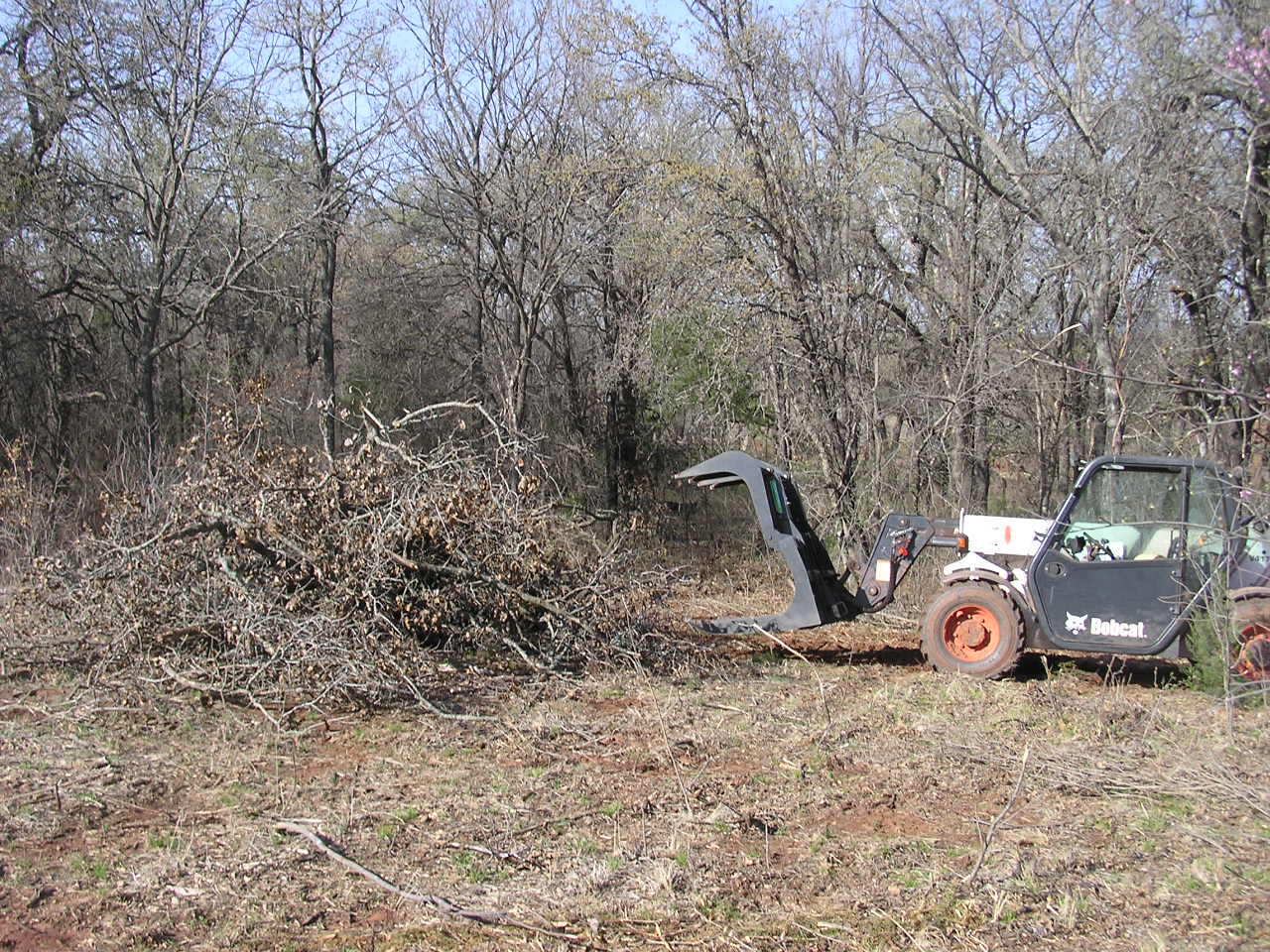

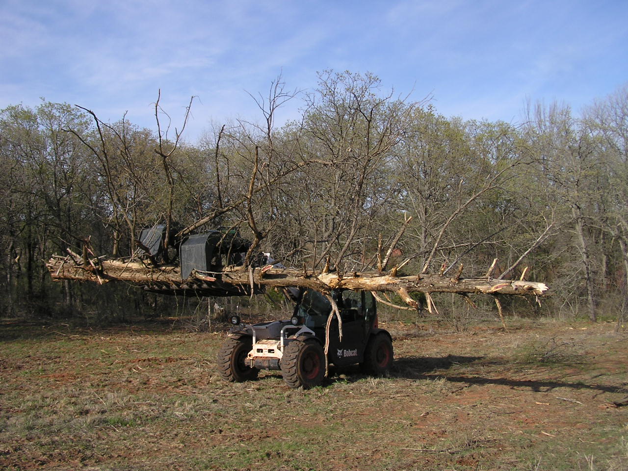

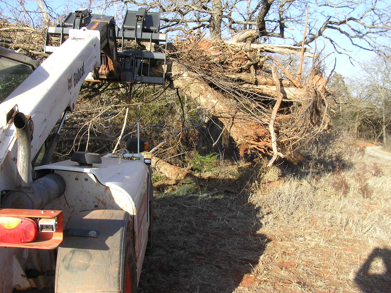

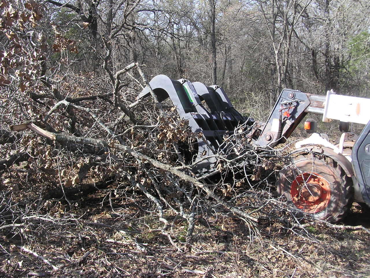

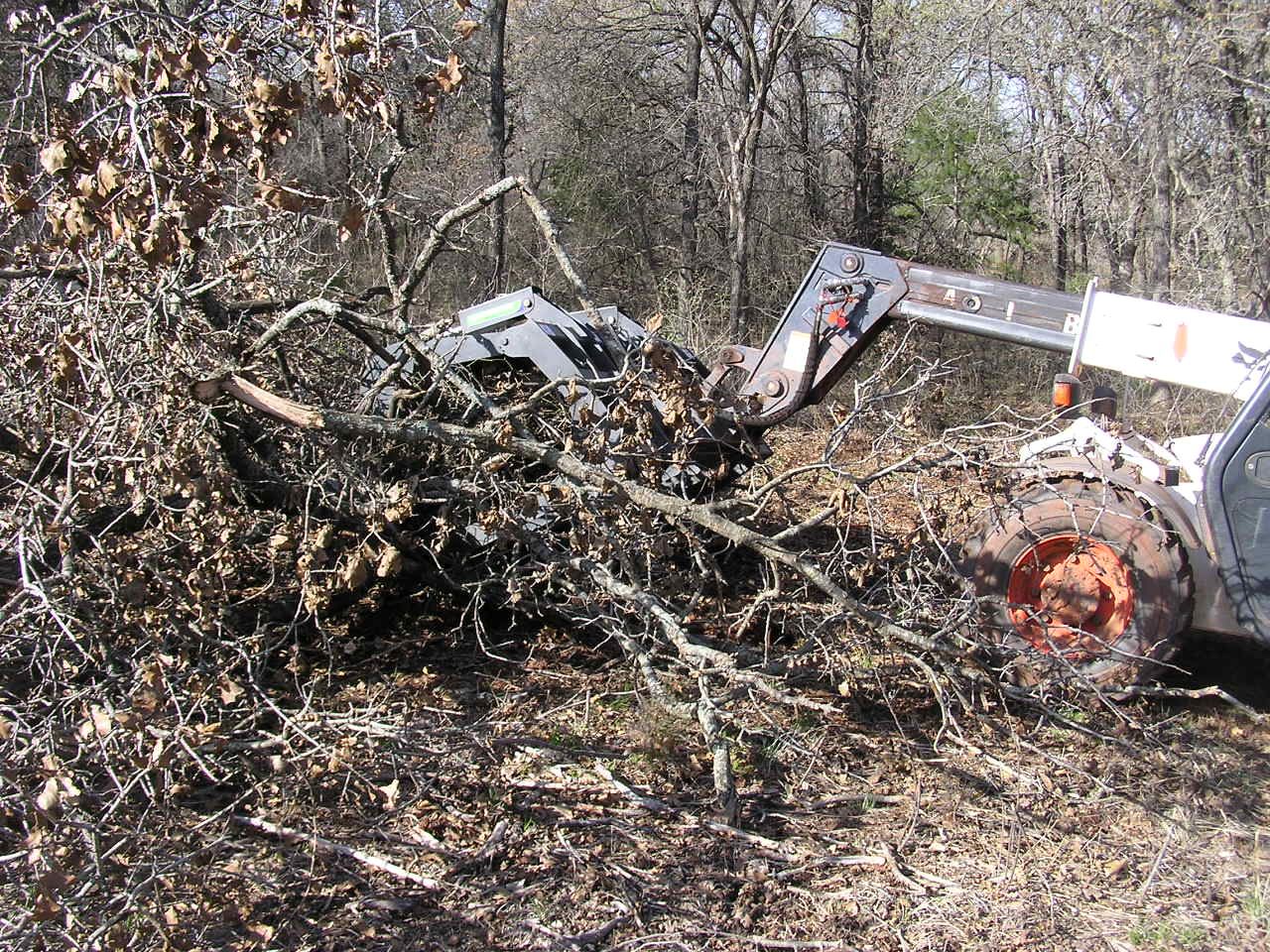

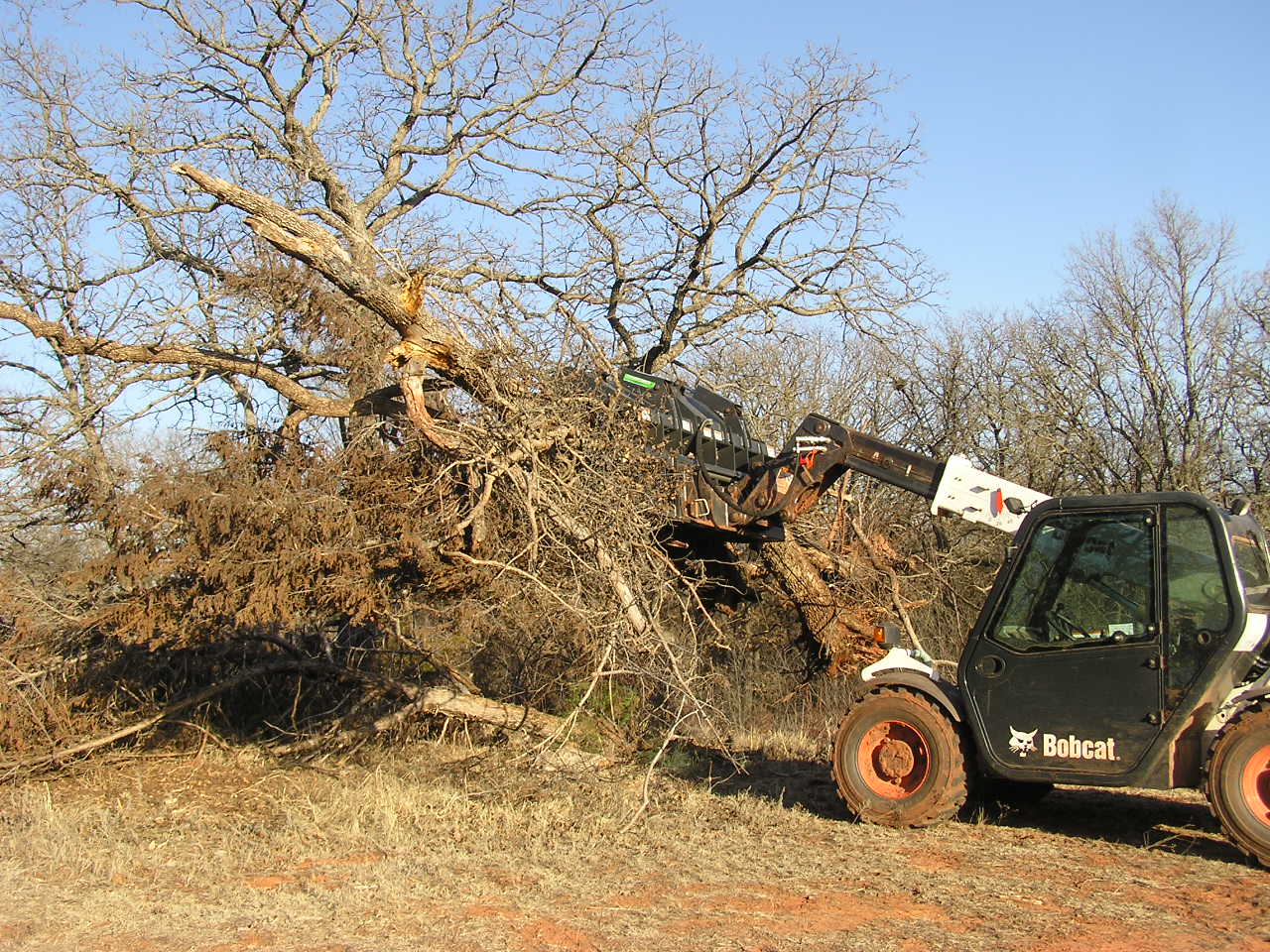

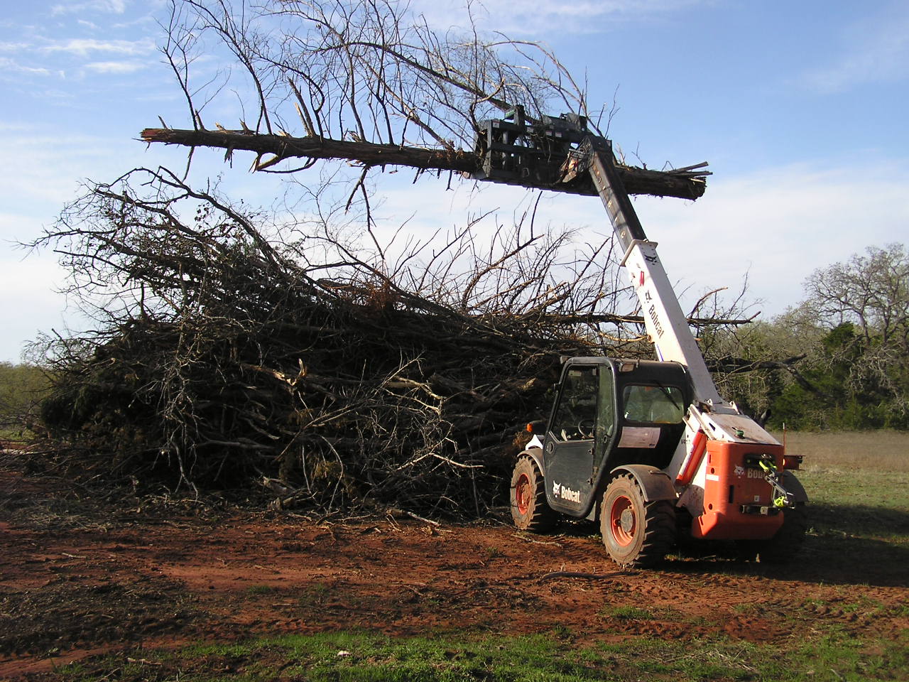

I put the Monster Grapple on the Versahandler for the heavy work. :D
The Versahandler is 6' wide, 6.5' high and 13' long. Tire size is 14x17.5. Top speed is 15.5 mph, drawbar pull is 7,000 pounds and it will lift over 5,000 pounds!
