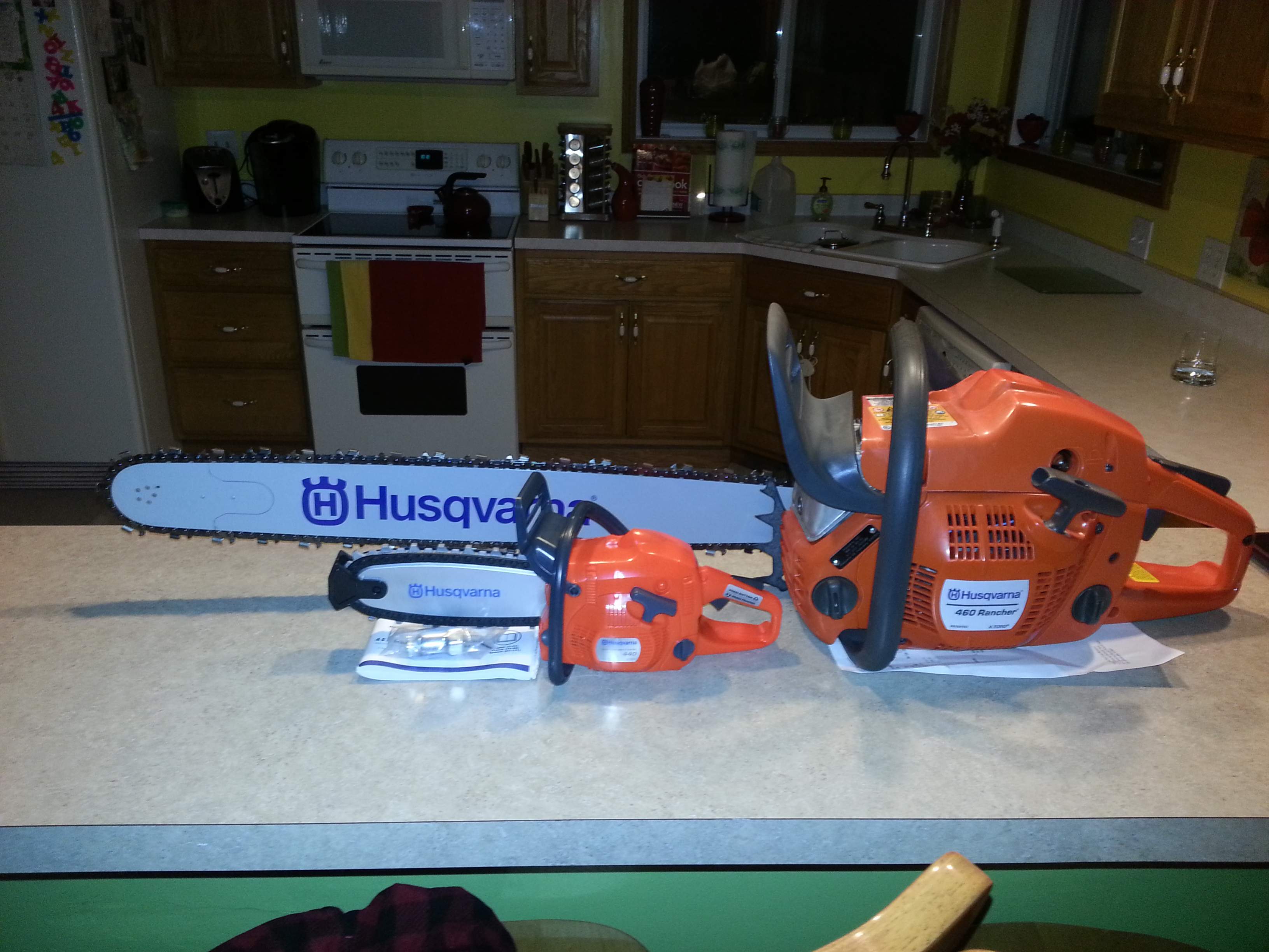

That's a nice looking saw! Should have all the power you need, and you can't complain about that price. Good luck with it!

I'm very happy with it. Its my first new saw. All my others where owned by my Dad or Grandpa.
My 2.5 year old Son also got a new saw as well. :)

I like your sons saw. That's starting them out right.
That 460 looks very familiar. I actually prefer 20 inch bars as when I let it hang from my hand it comes close to the ground which means less bending over when cutting up small wood. I'm 6 ft 3"tall so a 18" bar might suit you better if your more average size.
Take heed of the advice about not letting it set with old gas in it. Keep your left hand firmly on the grip at all times and never hold your head over the plane the saw would kick back through if something caught. You can look at it from the side just as well.
