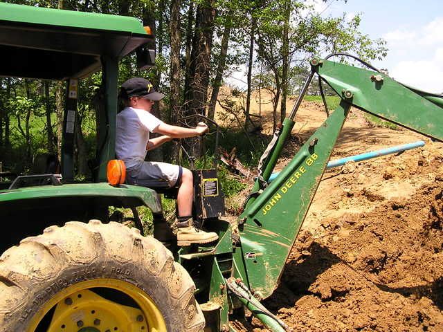

The below pic is of my son "in the dirt" with her a couple years before I sold her.

Take a close look at the back of my backhoe above and you can see the chains attached to the ends of the turn cylinders.

I would like to see photos. Michael's photo does not quite show them.

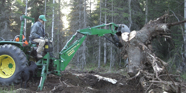

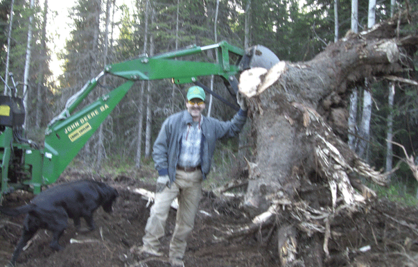

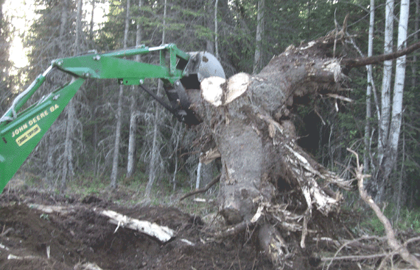

The 8 series of hoes are powerhouses! I loved my 8B that I had on my 970 for the past 3 years.
I dug some stumps that were downright scary big! I'll try to post a couple of pics with one of the bigger stumps that I dug last summer.
'Course the thumb attachment did help a little but...

OK.... let's give this another go! Or maybe it's go number 5 or 6 or... well, I've lost count of how many times I tried to crop these things!
Does using *.jpeg file types make things easier?
Anyways --- the JD 8 hoe is a great workhorse. You'd have a great time; er... you'd be able to work HARD if you get one for your 990.
AKfish
Oh yah, I'm 5'10". So, that stump is pretty fair sized!

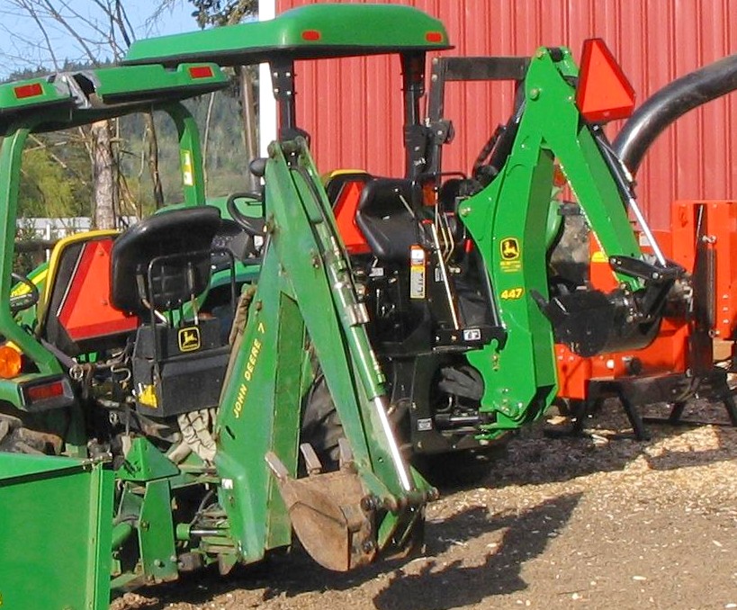

dirtworksequip said:
I think Deere no longer uses this type swing system on the newer style hoes.
Correct. JD has not used that swing design since the earlier JD7s and
apparently JD8s. Dual swing cyls since then on 7, 8, 47, 48, 447, 448.
