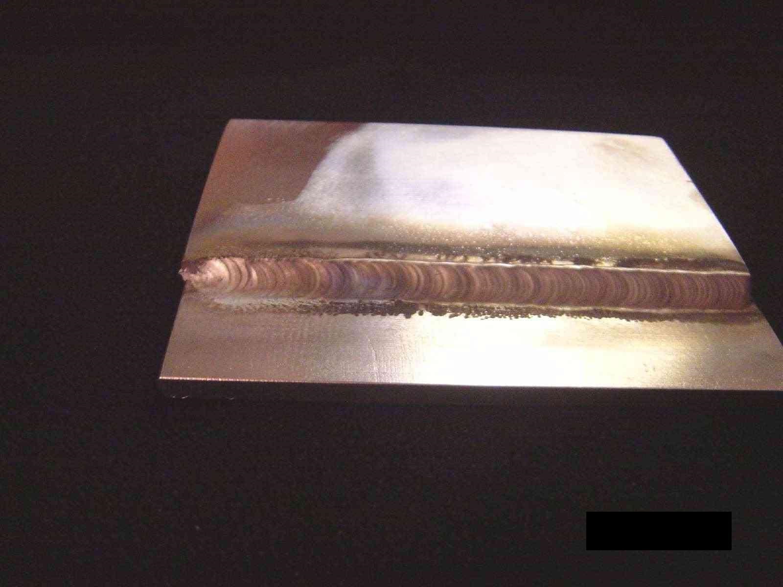

Will I be able to tig aluminum with it?
You can, the aluminum has to be very clean before welding. I use 100% helium gas. This weld was made on DC, with 100% helium.

Thanks Shield Arc,
Is it also possible with argon or is helium a must? If i need to pay $200 extra to get another bottle it might be cheaper to get a ac machine if i ever see one.
   / Buy Lincoln v250s #4

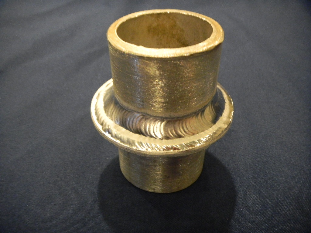

I would recommend getting an AC Tig welder. Helium is very expensive, and you have to use more CFH. Because helium is so light.
This aluminum weld was made with my Miller Dynasty 300 on AC.
