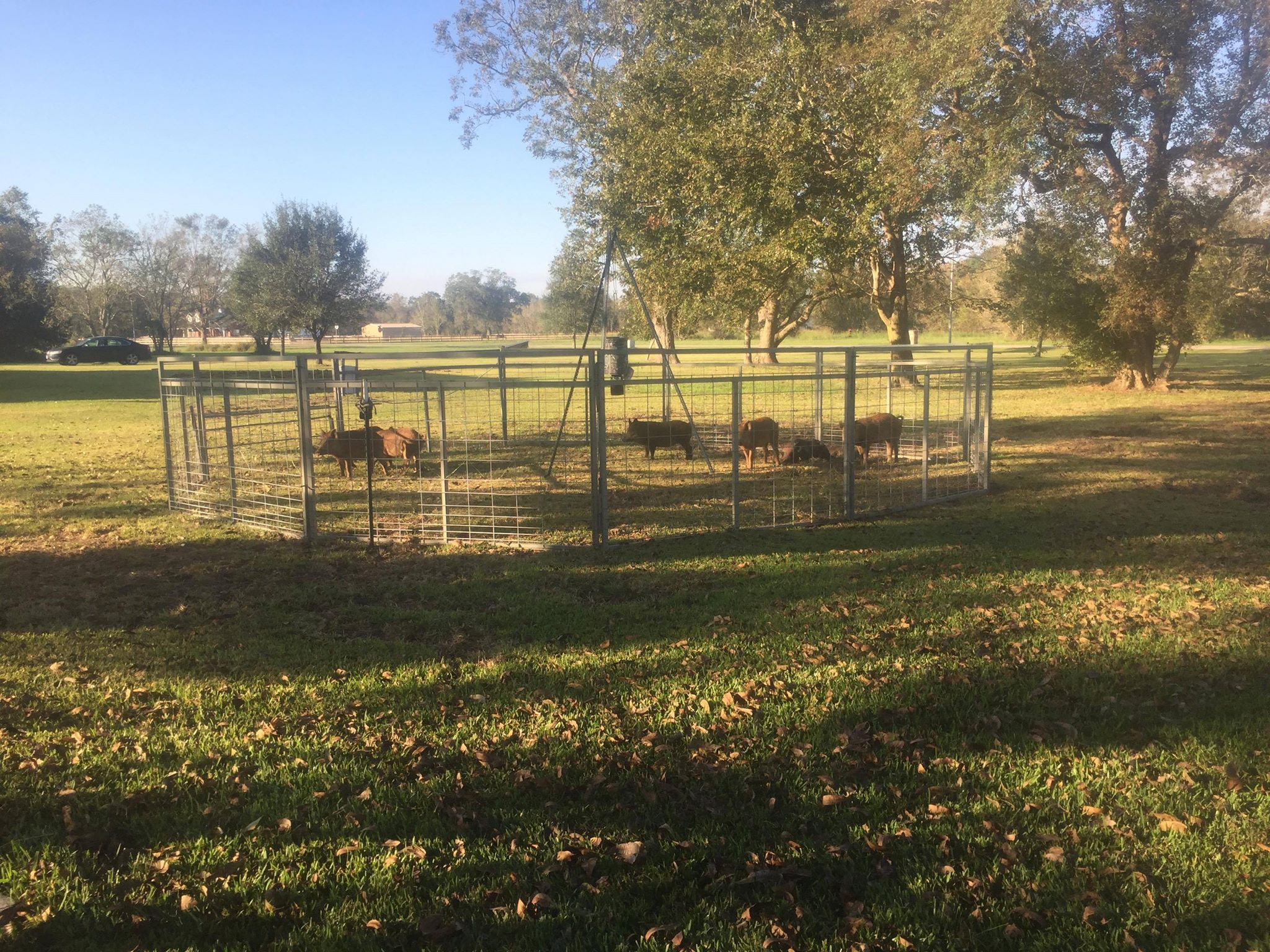

We've had fun taking more preventative measures by trapping the dang hogs. I hope that soon I won't have to bush hog our carpet grass any more, or at least not several times a week. See photo of a recent success.
talk about a pig roast, that's a lot of hog meat!

That’s a lot of bacon in that pin!! Wish I was close enough to help you out.
