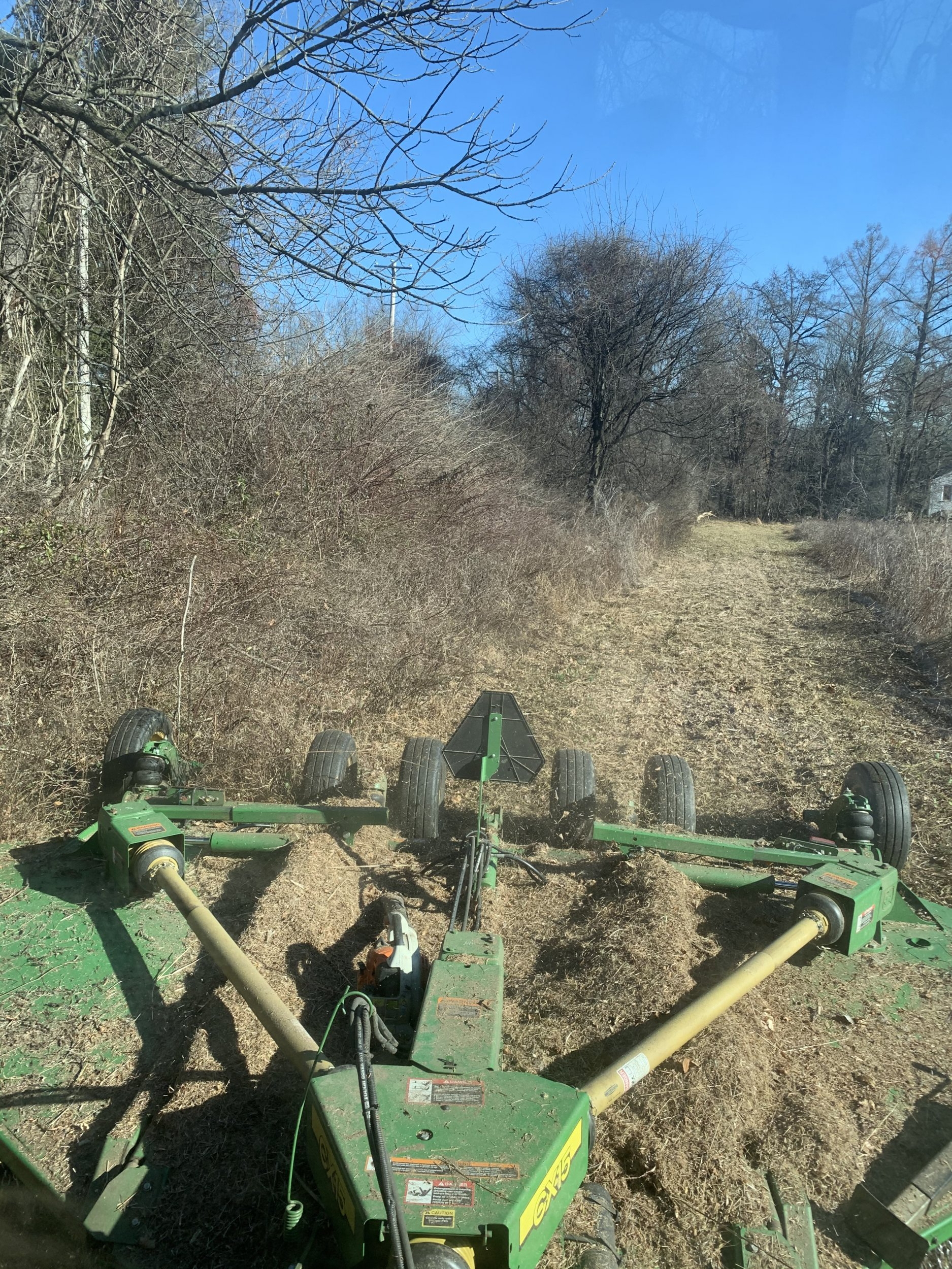

Here’s some typical more complicated ground to cut with power lines, fence lines,
railroads, etc. It slows you down, so hourly helps you make more money.

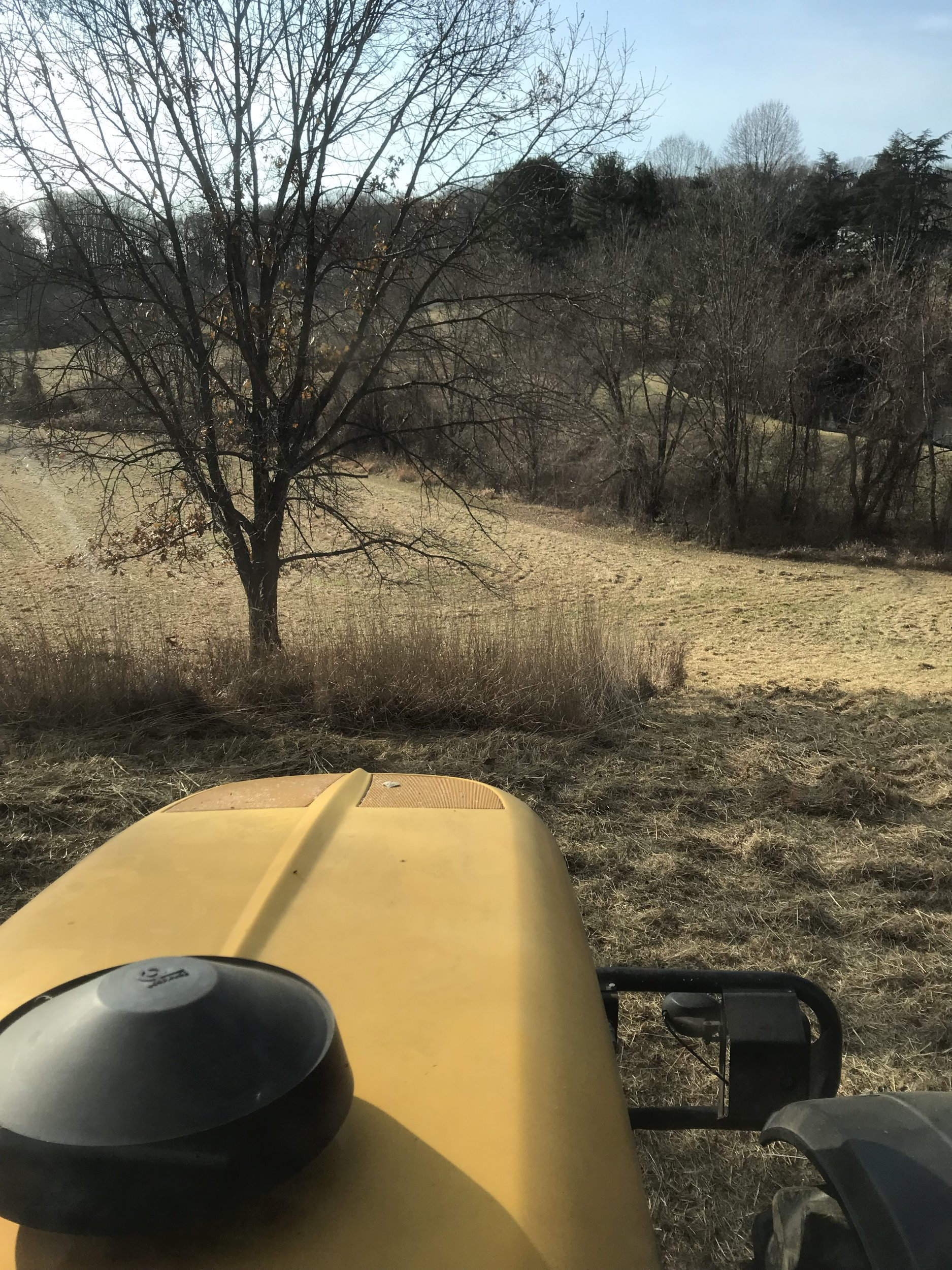

Here’s a hilly meadow with trees and a creek at the bottom. Probably takes an hour to do 2 acres. I wouldn’t want to mow 2 acres for $35/acre…... $70 would be far too low.

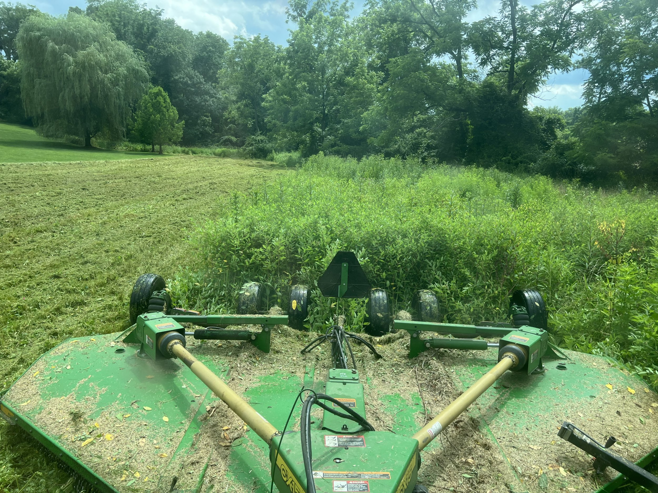

Here’s a 20 acre easy field to mow, except the cut-in at the right side. Generally I can mow at top speed and there’s few obstacles.

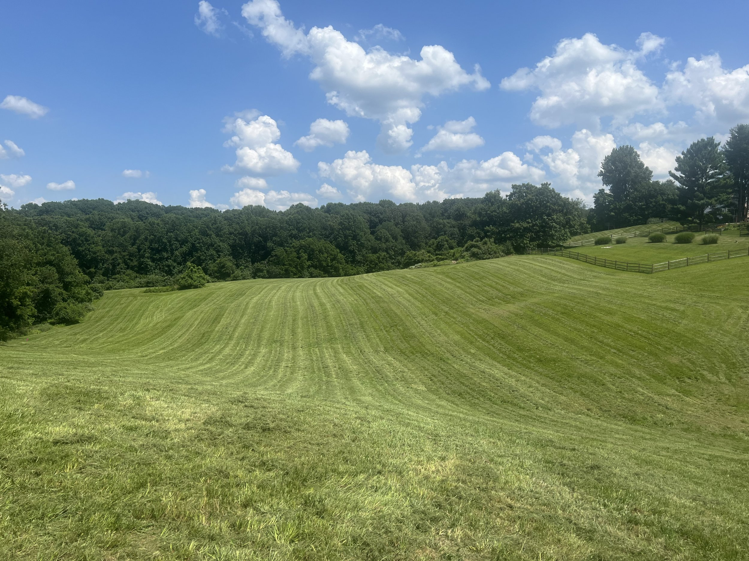

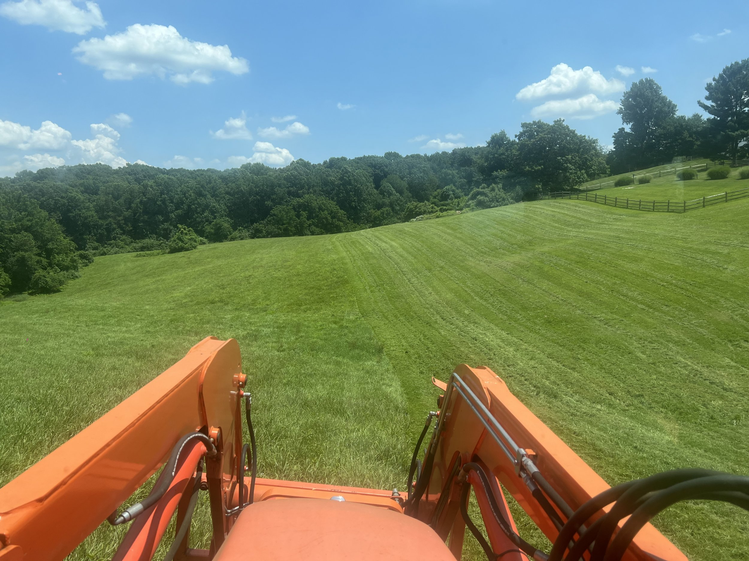

Below: finished product
Below: Here is much rougher crop (browned out goldenrod) along trees and fence lines. Would not want to mow this on a per acre because it’s much slower than the meadow above.
Below: Here’s some soft ground I cut loaded with noxious weeds. Can’t go too fast.
