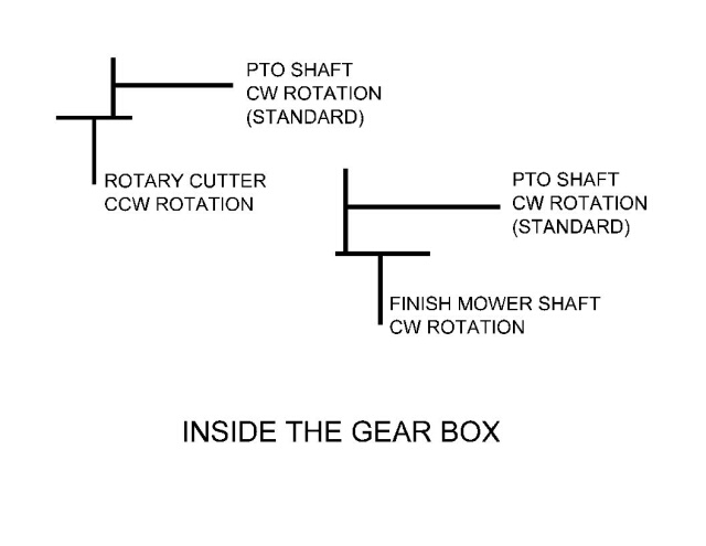

At least theoretically, ALL brush hogs should rotate CCW. And it ain't got a thing to do with the brush hog. ALL PTO's rotate clockwise (save for that one Kubota, B6100???), when viewed from the back. And pretty much all brush hog gearboxes are nothing more than 2 bevel gears. So you get a direction change there, the brush hog will always turn CCW when viewed from the top. Unless the manufacturer opted to use a more complex gearbox, and there is no good reason to.

Bird this has been driving me crazy. I don't even own either of them. I found some parts diagrams of a rotary cutter and finisher mower gear boxes. The only difference in how the different direction is accomplished is by placement of the input bevel gear. After comparing the two diagrams and seeing the placement of the bevel gear I was still unsure. Now, no laughing.... I VISUALLY proved my point to myself by using axles and bevel gears on my Legos. Pretty sad a 29 year old is still playing legos. Attachment show it far better than I could ever explain.

Derek, I haven't gotten into that deep thinking yet on this topic./w3tcompact/icons/laugh.gif I don't know whether the gear boxes are different or not, but perhaps one consideration is the fact that you only have one spindle to turn with the brush hog; i.e., direct drive from the gearbox, while the finish mower has the direct drive out the bottom of the gearbox, then a belt to turn multiple spindles (blades). I've never thought about whether the belts reverse the direction or not. I guess it wouldn't be very difficult to remove the belt cover and see which way the output shaft turns on the finish mower (if I cared enough to do it/w3tcompact/icons/laugh.gif).
