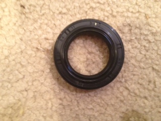

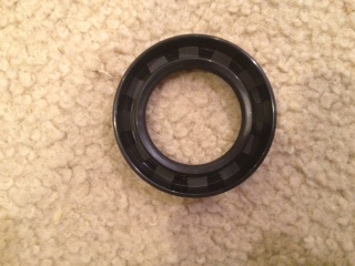

I have a Howse 400 bush hog, upper seal went bad. I have a new seal, just not sure which side installs toward the gearbox bearing. one side of the seal is flat with the part number on it.
Thanks

   / Bush Hog upper seal #2
the right hand pic goes towards the oil
