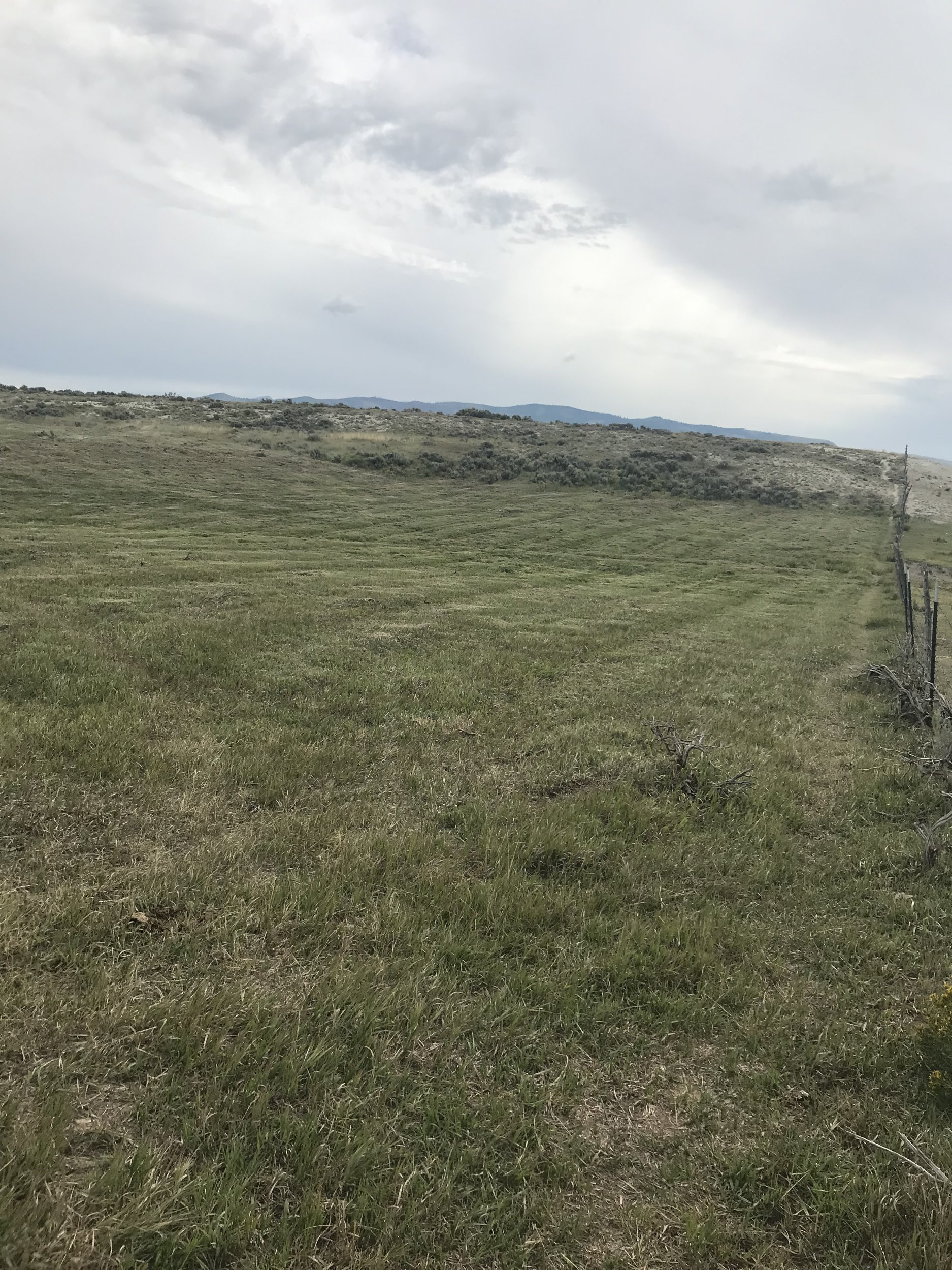

Me and the machine and my wallet. My ground is very rough and hilly. And I am mowing sage right now. If I went faster or bigger I think I would break something. A 12 or 15’ seems huge. I like the tucked in 8‘ dual. I don’t have much flat area. Yesterday’s mowing
