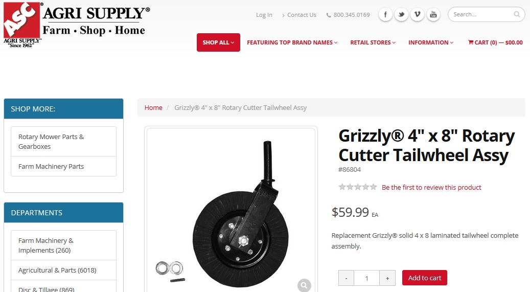

Thanks for all the comments, I do appreciate them. I decided on the Bush Hog 7008 mainly because of the offset capability and also because our local dealer has them in stock. It is also good to support the local economy when you can. Everything Attachments has the King Kutter blade HD-RB-96 I was looking at. It looks like a great blade but I think the offset will be more important to my application. Airbuscuit's idea of a tail wheel would be very helpful for the ups and downs. Also the picture of the old grader he posted with the axle and two wheels is intriguing. Well it is off to the scrap yard for another adventure. Perhaps a front axle from a riding mower, who knows what lurks at the scrap yard!
   / Bush hog or King Kutter rear blade #16
Congratulations! Here's a good price if you need this component.
