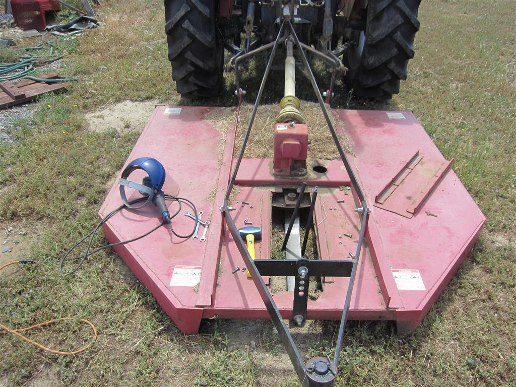

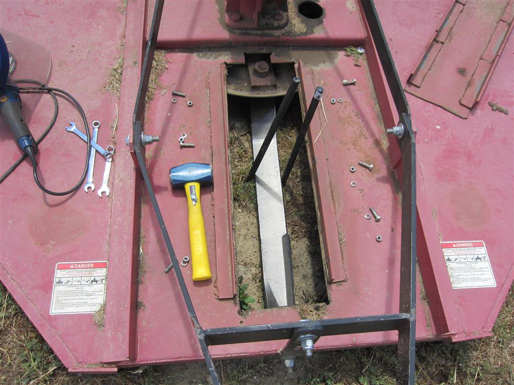

Is there any downside to drilling a couple of drain holes in the pan of my Bush Hog SQ48? When I took it apart because the blades were rusted to the pan the top of the pan was full of crud and of course rust. Anyone try this? I was also thinking of fab'ing a cover plate for the blade access hole to keep water out.
I cut a 6x 18" hole in the top of my Hawkline 6 ft hog to make blade sharpening easier. The piece removed became the bolt-on cover.
Works fine.
Good luck
