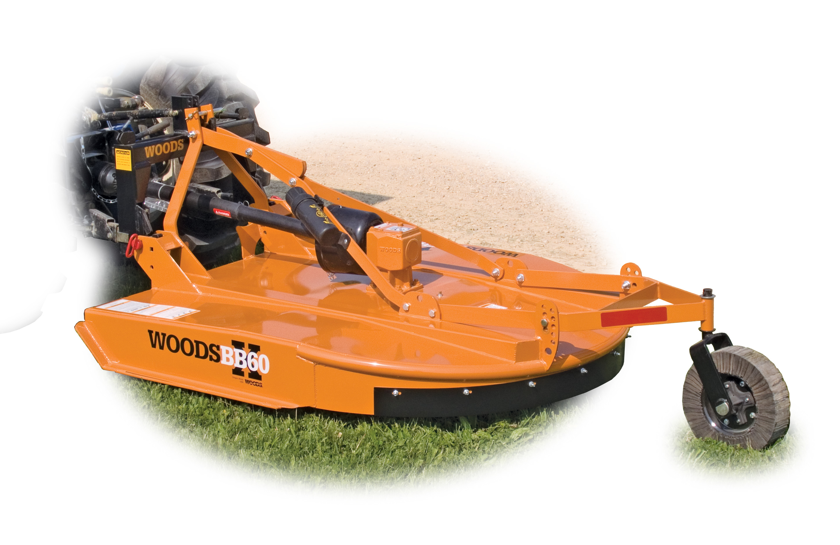

The new Woods models come with a plastic shroud around the slip clutch. Now lets be honest, how many people found it a pain in the you know what, when adjusting the slip clutch or doing maintence, and just took it off. If it was left in place it would probablly help to keep the weather out.
