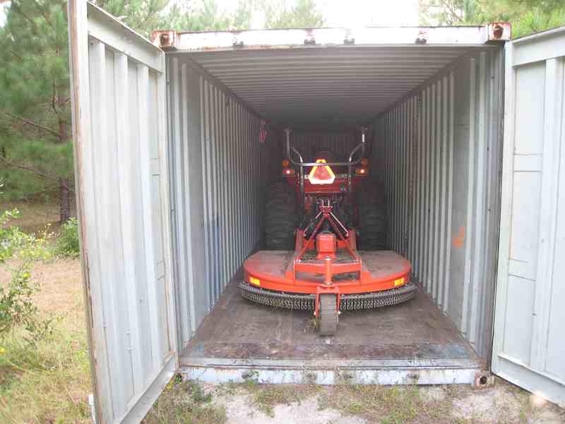

I have a Woods Brush Bull 72". It is considered medium duty, but is very substantial. It has an adjustable internal baffle that I moved to front and added the front and rear chains where it had heavy rubber before. I think that the rubber shields were very adequate. I included picts
