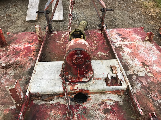

This maybe my only option as no one can identify the beast.

That's how I would have started my search to begin with.
And it don't even have to be exact.
I had a bushhogging 306. Blades were $40 each. Found a guy on eBay at the time selling alot of old obsolete blades that were discontinued. $5 a blade. Found some.that we're the same width, same thicknesses ,(1/2"X4") but they had 1/4" more offset and we're 1/2" too long.
Offset wasn't any big deal (though I wouldn't want less, because when things start to wear you can crash a blade up into the deck). As to the length, a few minutes with the chop saw and they were the right length.
Blade bolts...same deal. One size fits MANY cutters.
I have dealt with tsc King kutters, a bushhogging sq84t, bushhogging 105, bushhog 305, modern sunshine 5', imc 6'.....they all take the EXACT same bolt

LD1 is right. You should be able to just use a heavy air wrench and get the blades and bolts off. Then you can measure, shop around for blades and get exact right size & type bolts. Blade bolts typically require shocking (to me anyway) amounts of torque. On the order of 600 ft-lbs. With some luck you'll find all you need at TSC. I would not reuse those bolts unless you just cannot match them.
