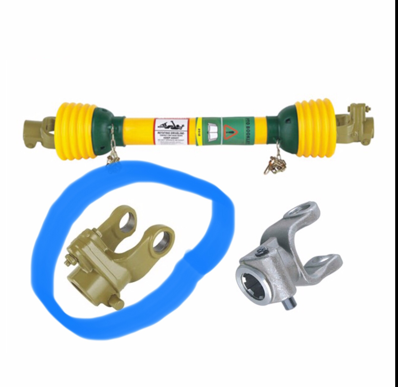

Does the PTO shaft look like this where it connects to tractor?
If the bolt is sheared, the mower’s PTO shaft will slow down, but you may think it’s the tractor’s PTO shaft that slowed down when it really hasn’t.

All fluids, filters etc. were changed just last year. Not many hours ago. Fluid supplied by the New Holland dealer for the tractor. The shear pin is not broken, I took it out to check. The nut holding the bush hog blades on still has the retaining cotter key intact.
