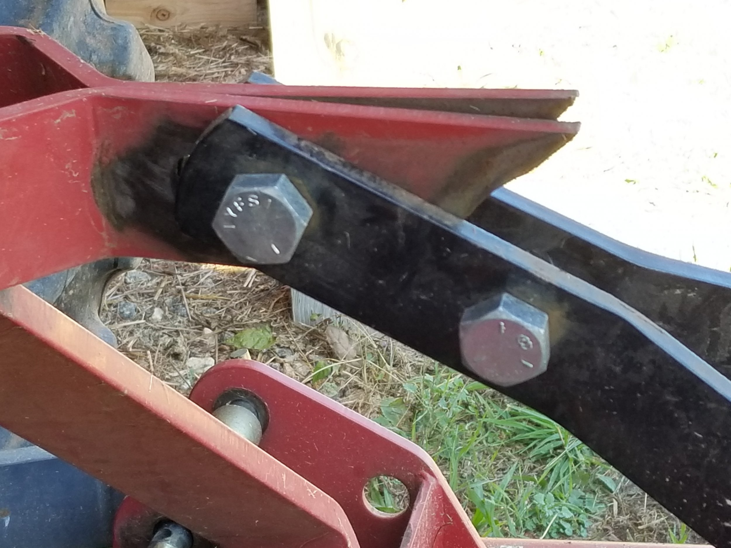

IMHO the 3 pt center linkage on mower isn't pivoting as designed. My 1st guess is bolt with nut in photo too tight & preventing any designed pivoting of hitch components. Please post a complete view of mower top link attachment to confirm

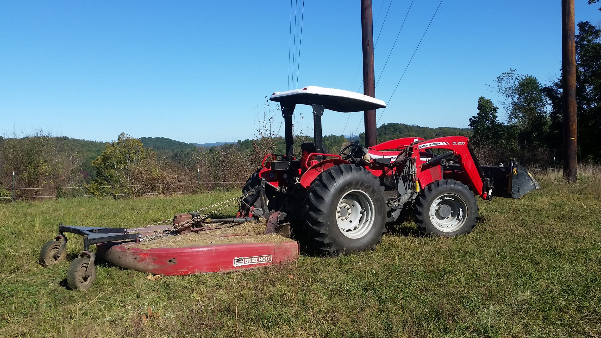

My primary Bush Hog is a model 297 (photo below.) I had the lift straps break on it too. The circumstances when the strap broke was excessive bending backing up into brush and small trees. In my case the break was at the weakest place in the strap -- namely where a hole has been drilled and where the max bending also occurs. The hole seems to have been for mounting the instruction booklet container/plastic tube that they are delivered with these days.
In my opinion the steel straps from the factory do not make sense for rough and tumble widely varied use of a bush hog. Maybe in cases where it is high volume use (cutting corn stalks, crop debris, etc.) but not the hilly farms and pasture fields.
I switched to chain, not for the top link but rather replacing the factory lift straps. Never a problem since. I use rubber straps and one bungy for tension to avoid the chain slapping around. I think you will find most old hill farmers use chain. Another reason I replaced the straps rather than the top link with chain is I want to keep my hydraulic top link in place for essentially all tractor work.

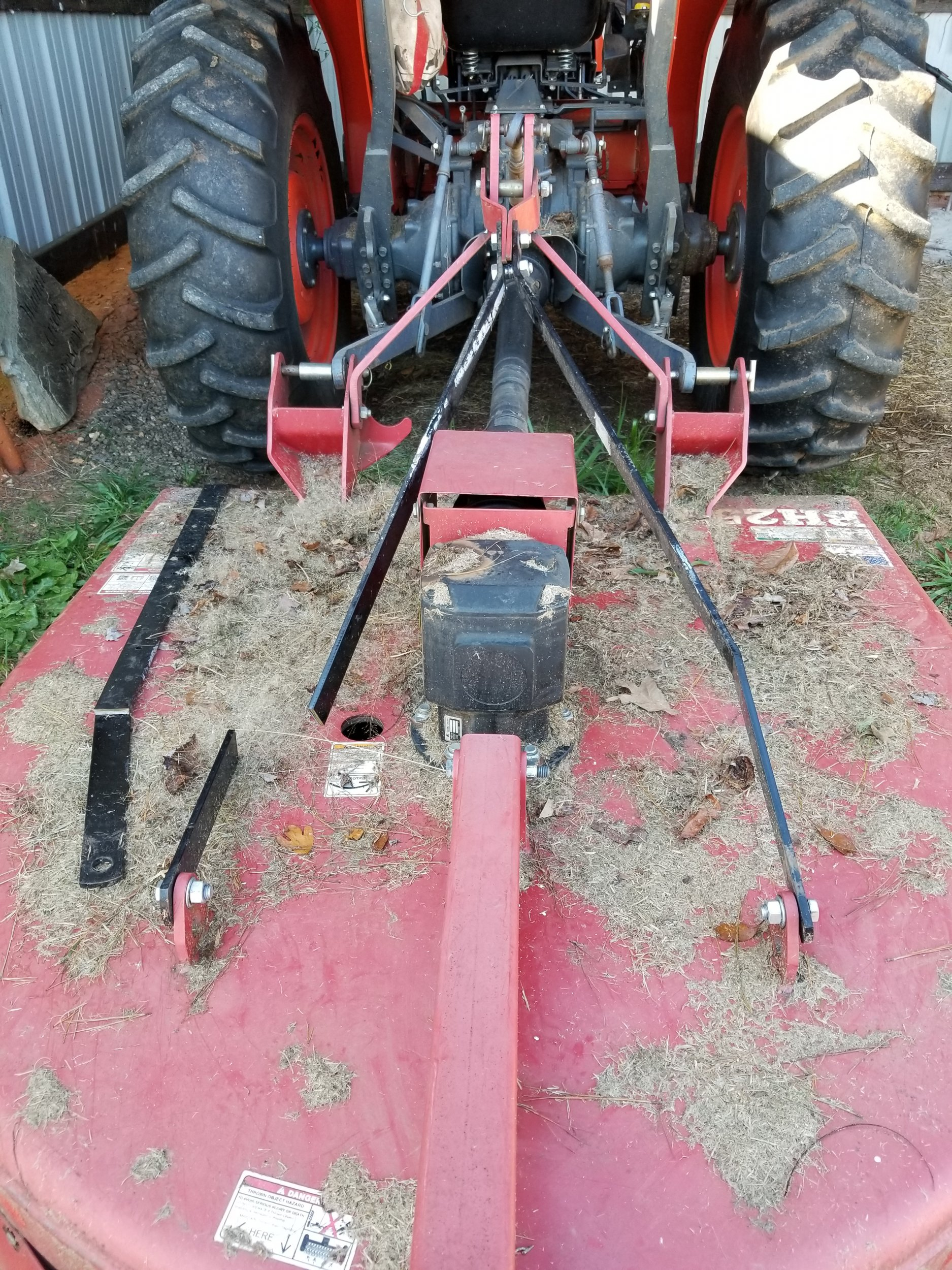

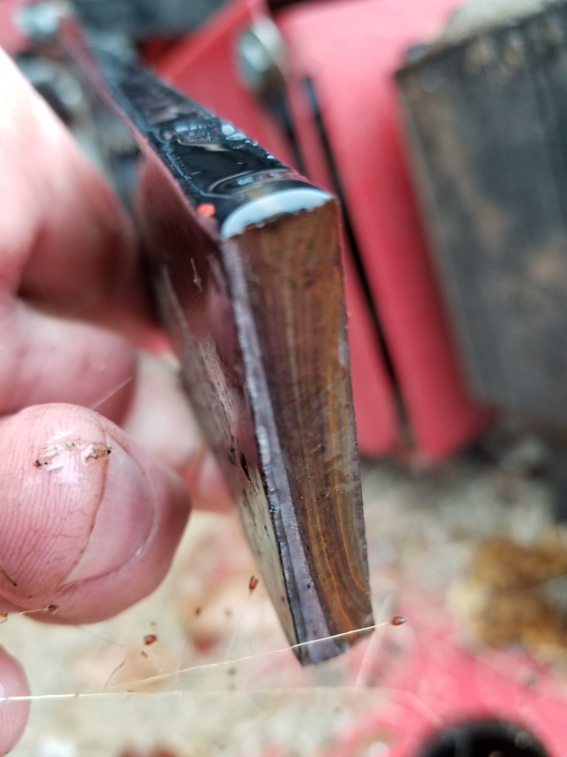

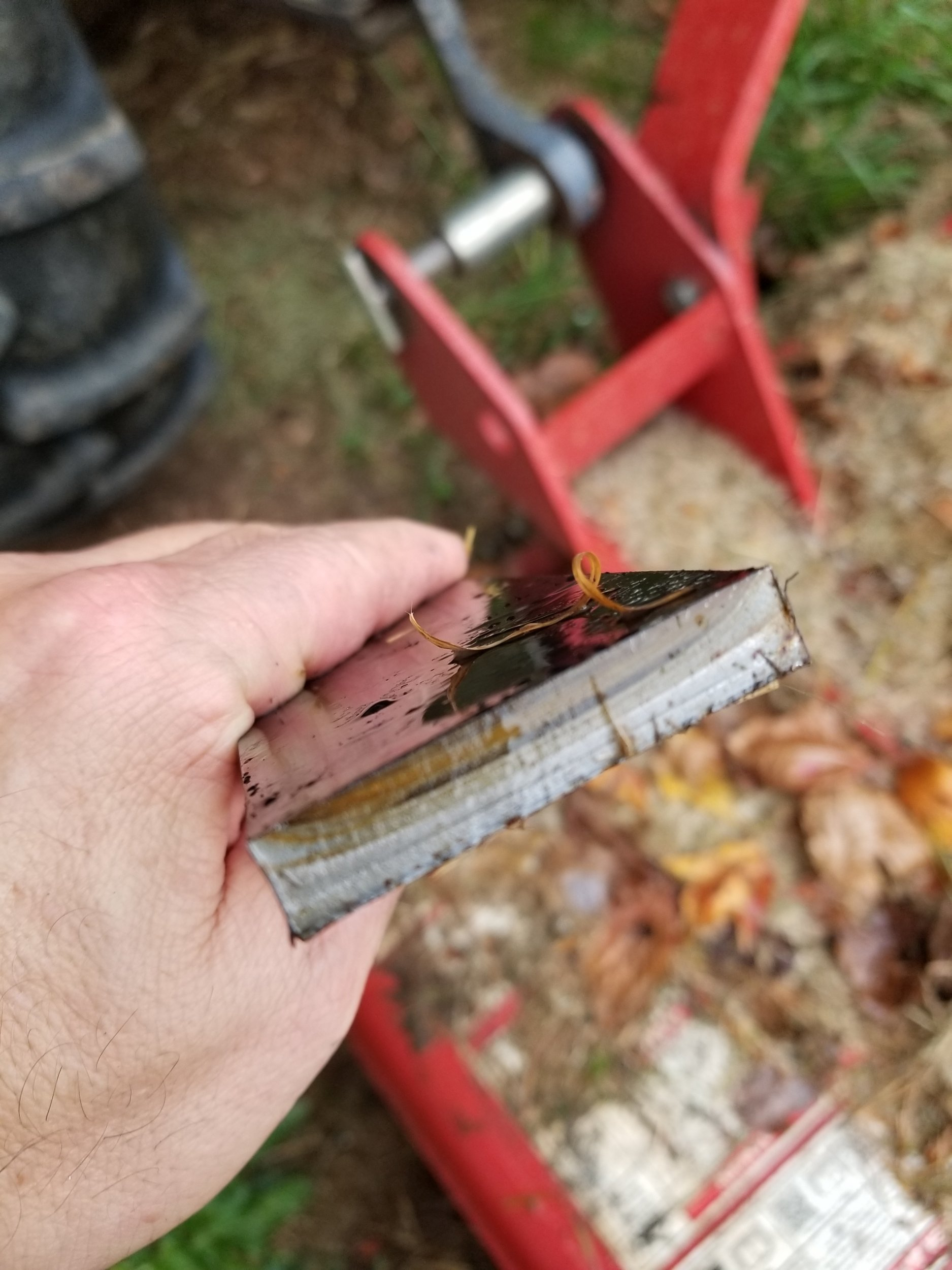

I take care of some equipment for my neighbor, fixing broken things and maintenance. He has a BH25 that has broken the yoke bars a number of times and I was trying to figure out why and it seems a manufacturing defect. Where they stamp the bend at the factory it seems its somewhat shearing the steel. 3 of them have broken this summer. This last one only made a couple laps around the field. So I investigated the break a little closer and can see there isn't much metal left to break.
Anyone else had/have this issue?
The pics of the broken ends are two different yoke arms.

Those straps must have pivot or some way to "give" when the tailwheel tries to raise the mower. In you pictures I just can't see how the top of those straps are fastened to the A frame If they are bolted solid and have no give they will break, It should be a single bolt through the top and loosened so it can pivot, allowing the A frame to move. Others have replaced the straps with chains even some have cut the straps and welded some chain for the A frame to pivot

Can we get more pictures of the setup? How the top link attaches?
In my opinion I'd say 1 breaks it is a manufacturing issue.
3 break in one season and it is more likely to be a set up or use issue. Unless the 3 came from the same batch, manufacturer, etc.
I's take them to an experienced welding/machine shop and see what they say the cause of the break is.
To snap a bar like that is highly unusual.
Also, were those bars replaced and where did they come from? Was the first break an original one?
Looking at a picture of the BH25 the bar looks to be angled where it bolts at the rear and not straight like his appear to be.

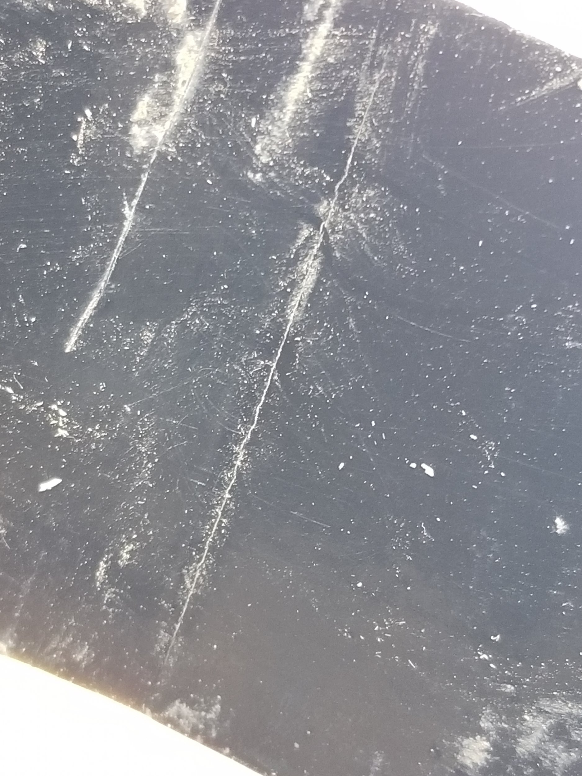

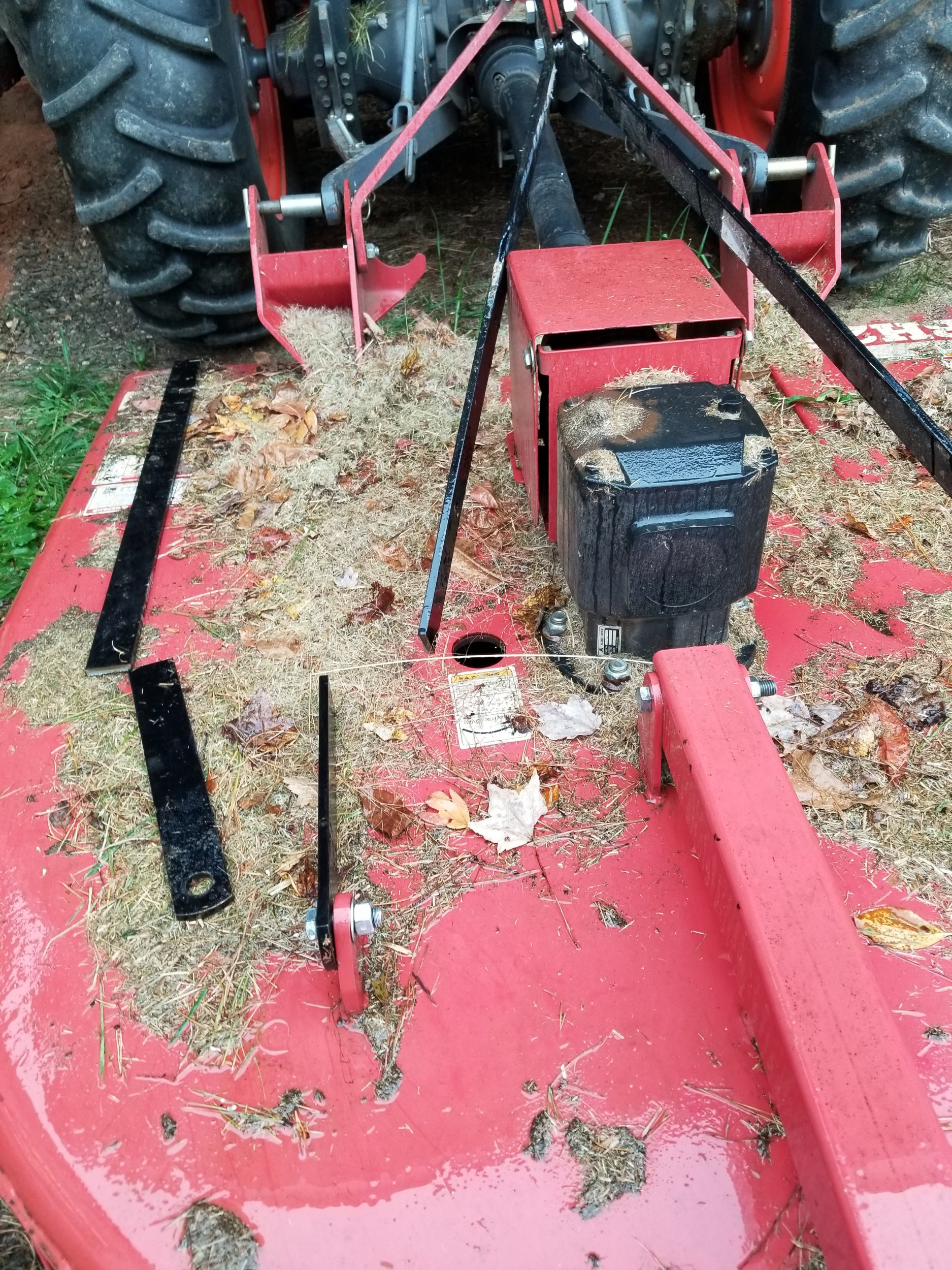

Got over there this morning to look it over again. I don't see anything wrong with the set up. The top link has the right amount of play and moves freely. The bolts holding the bars are loose enough to provide free travel. The main yoke that attaches to the top link swivels freely. Nothing wrong. Here's a few pics.
The one pic is of the other bar that's not broke and a close up looks like a crack in the paint right at the bend line.
Hes picking up new bars today and taking the broken ones in with him. They already said in the past they won't do anything but they asked him to bring them in for "inspection".
Personally I would just go with chains. It was my thought before even asking here. But he's not real keen on the idea. If he brings the broken bars back I'm going to gusset and weld them.

I see torch marks on the back end of that toggle/flex link and there shouldn't be any. Has it been shortened enough so it aligns with the failing bars? If they are aligned and parallel in tension the link won't work as designed in compression.
The fore/aft centerline of that flex link needs to be at a lesser angle from horizontal than the center line of the black bars.

I notice that the BH25 was manufactured with sudden/sharp bends or kinks at single places on each strap. My 297 straps (as well as those on a smaller 5ft hog) do not have pre-determined bend spots but rather are continuous with no 'kinks.' While mine broke at the weakest point (where a hole had been predrilled) yours broke at a predetermined kink point.
In my mechanical intuition mode, I say that design change means that ALL the breaks in that model hog straps will be at that bend/kink. I think it is a designed-in breaking point for no good reason (well, a poor decision.) The older non-kink designs flapped around a good bit when not under tension and PROBABLY the idea in the design change was to reduce that flapping around and thus minimize fatigue. The kinked ones are no doubt stiffer and tend to flap a lot less. I think they created a fresh problem while trying to fix another. Shame we have no way to directly ask the Bush Hog design engineers (and let them know really.)

The pivot link allows only so much travel. Is he backing up to steep banks or something similar that would bottom out the link? Or operating with the link already well into its travel?
Even with the link bottomed out the 3pt should allow the deck to get pushed up. So there shouldn't be that much force through the bars, just some fraction of the weight of the mower. Clearly that's too much for that bend but it should be ok with some reinforcement.
