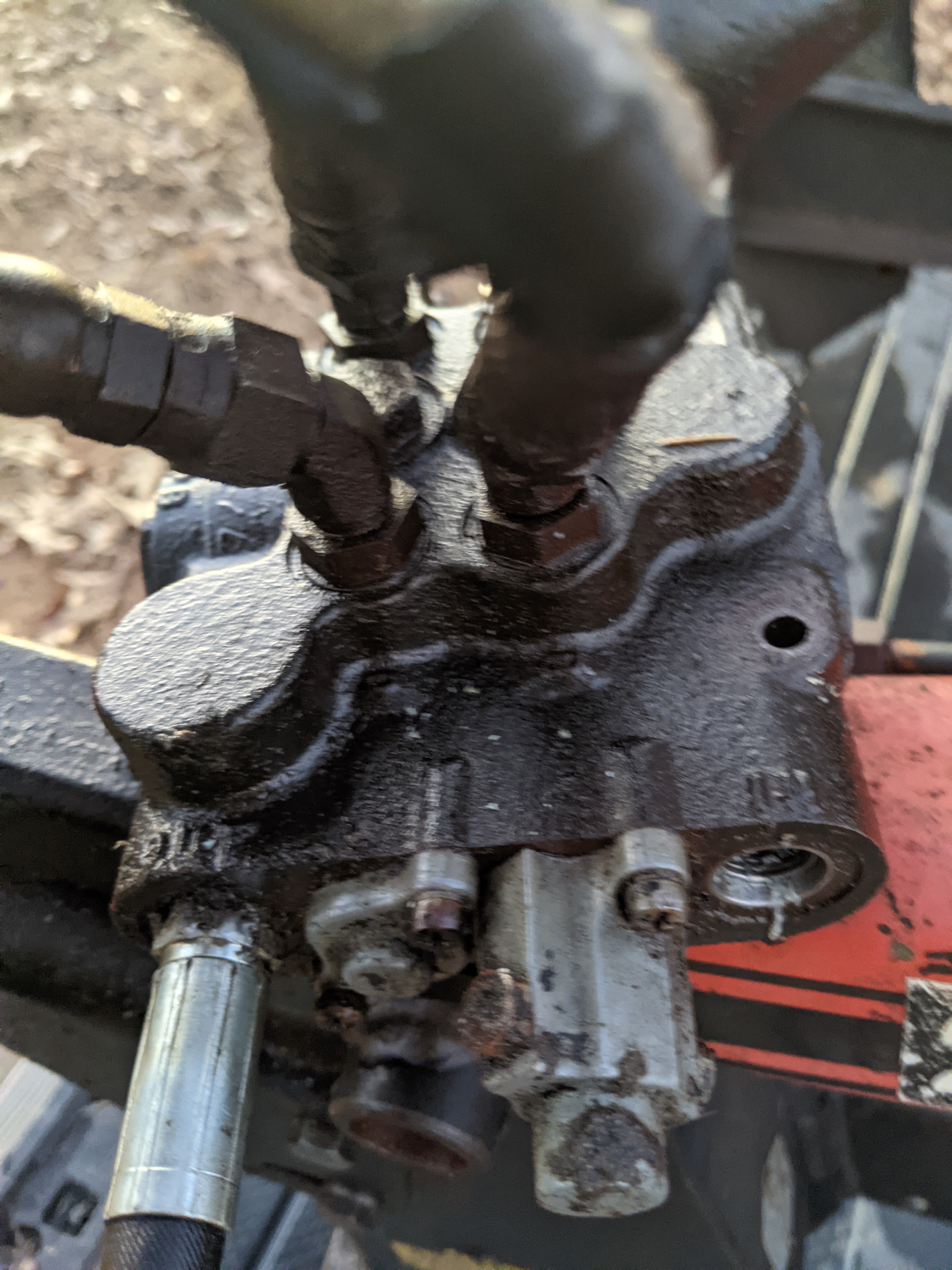

I have a 2 spool valve on my Bush Hog 2250qt loader that I need some specs on. I've done several searches with no luck. It's a Dukes Fluid Power 3527wg. Is it open? Pressure relief? I just don't know what I have. I'd appreciate any info you can give on it.
   / Bush Hog 2240 QT loader #2
Sam

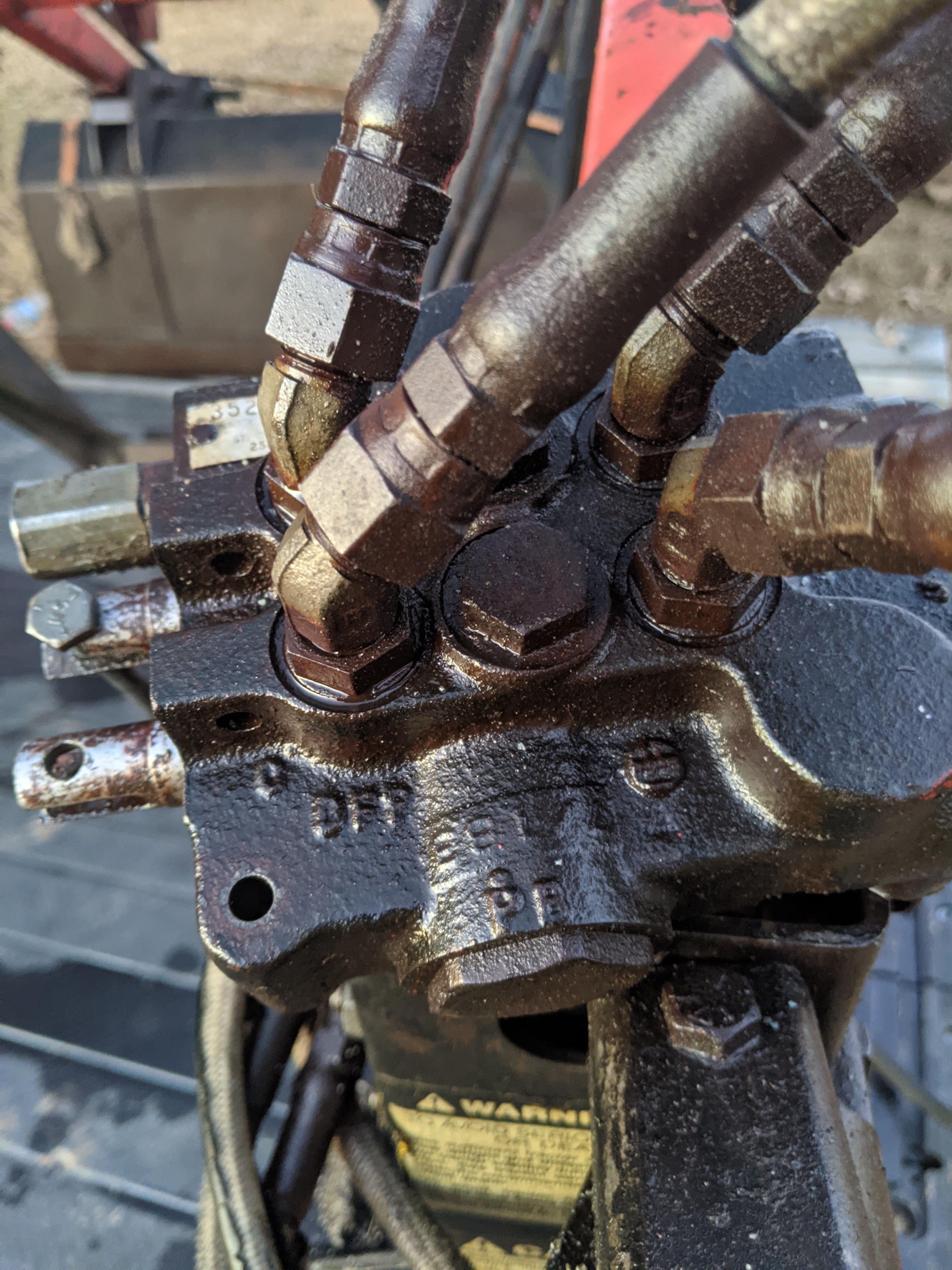

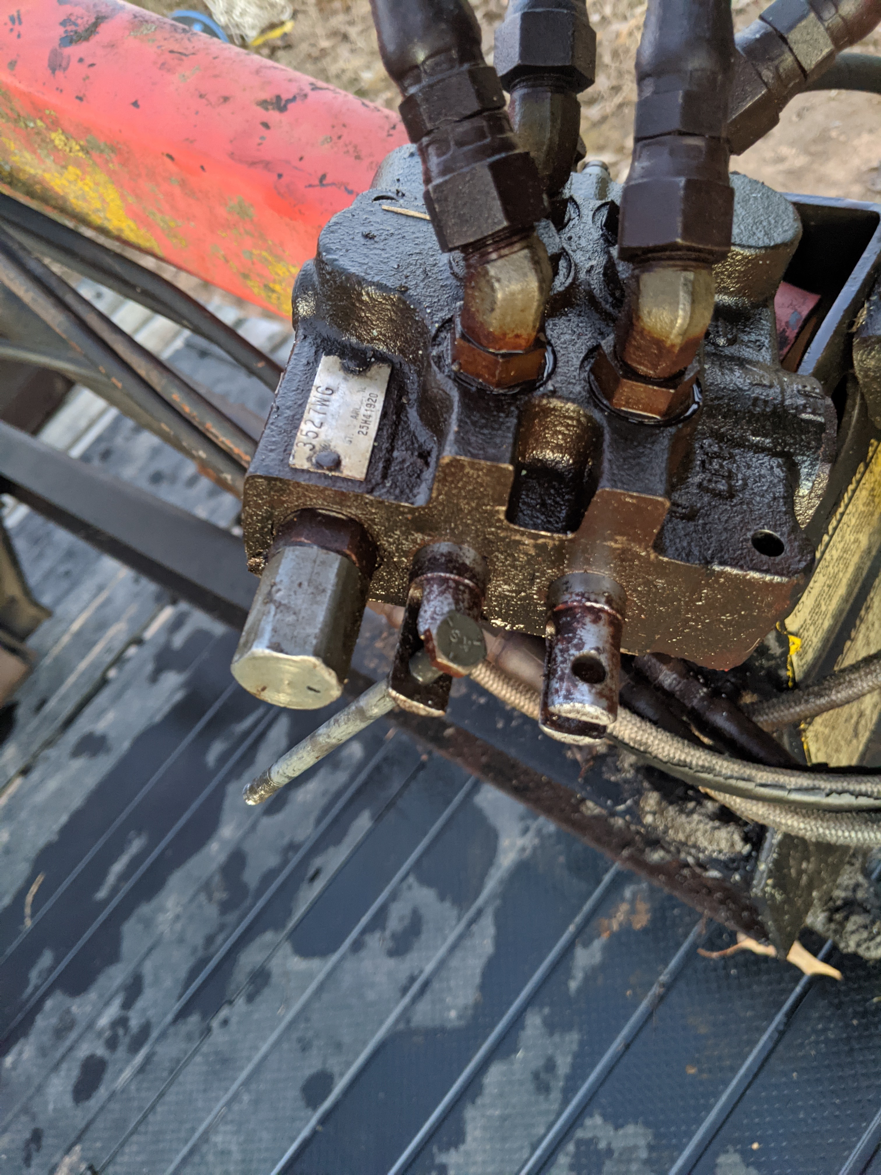

Can you post a few pictures of the valve from different angles. I suspect that based on pictures we can determine if there is a relief in the valve and possibly whether open or closed center
   / Bush Hog 2240 QT loader #3

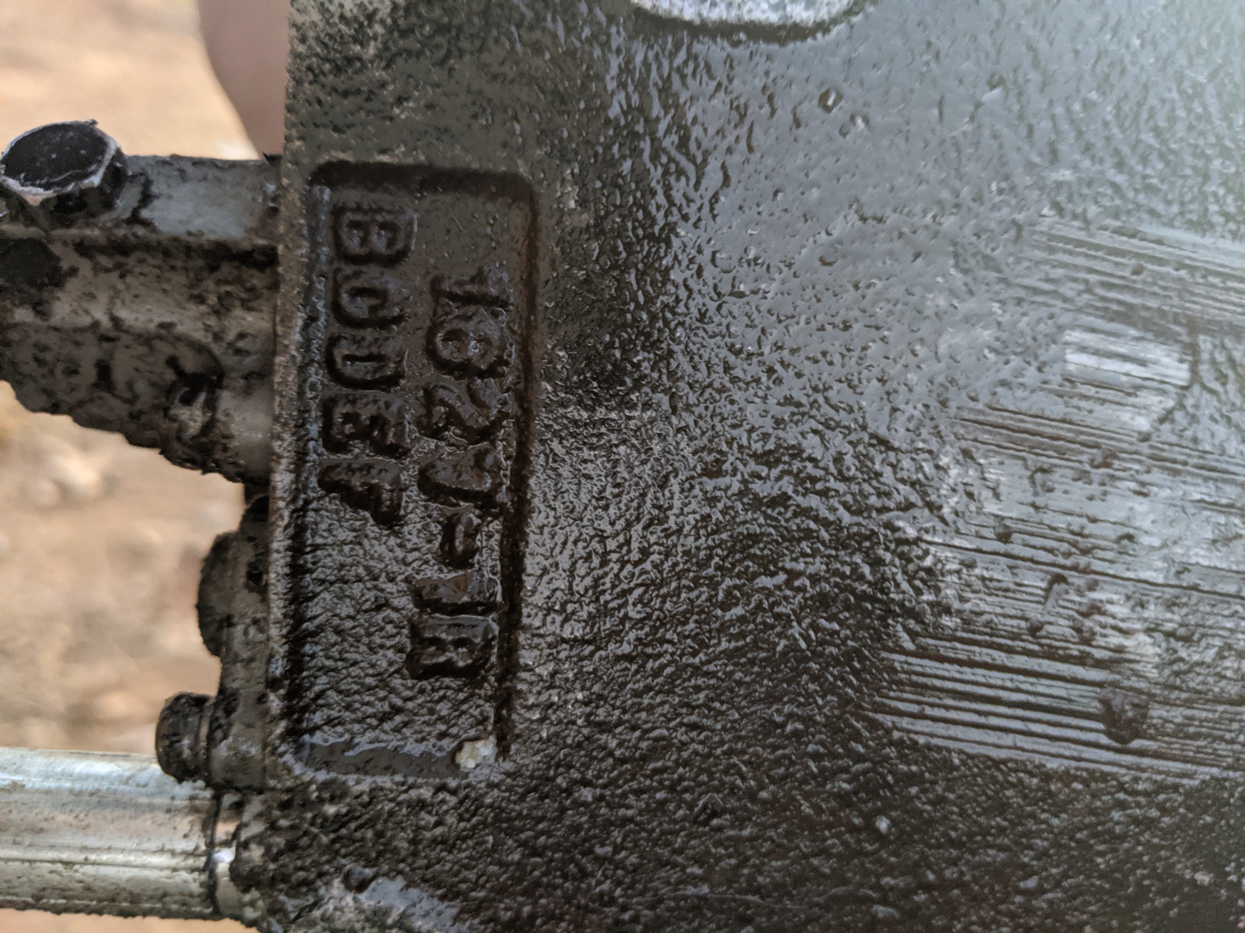

Make sure to get pictures of any casting identifications by the ports on the valve.

6 ports or 7? If 7 it is an open center valve with Power Beyond. If 6 it could be a simple open center valve or (less likely) a closed center valve. Apply compressed air to the pressure port with the spools centered. If 6 ports and air exits the return it is open center. 6 ports and no air exits it is closed center. 7 ports and air exits the PB port it is OC with PB.

Here is a picture of the tag. I'll snap a few more this evening and post them. I'll also do the air pressure trick and post my findings. Thanks
