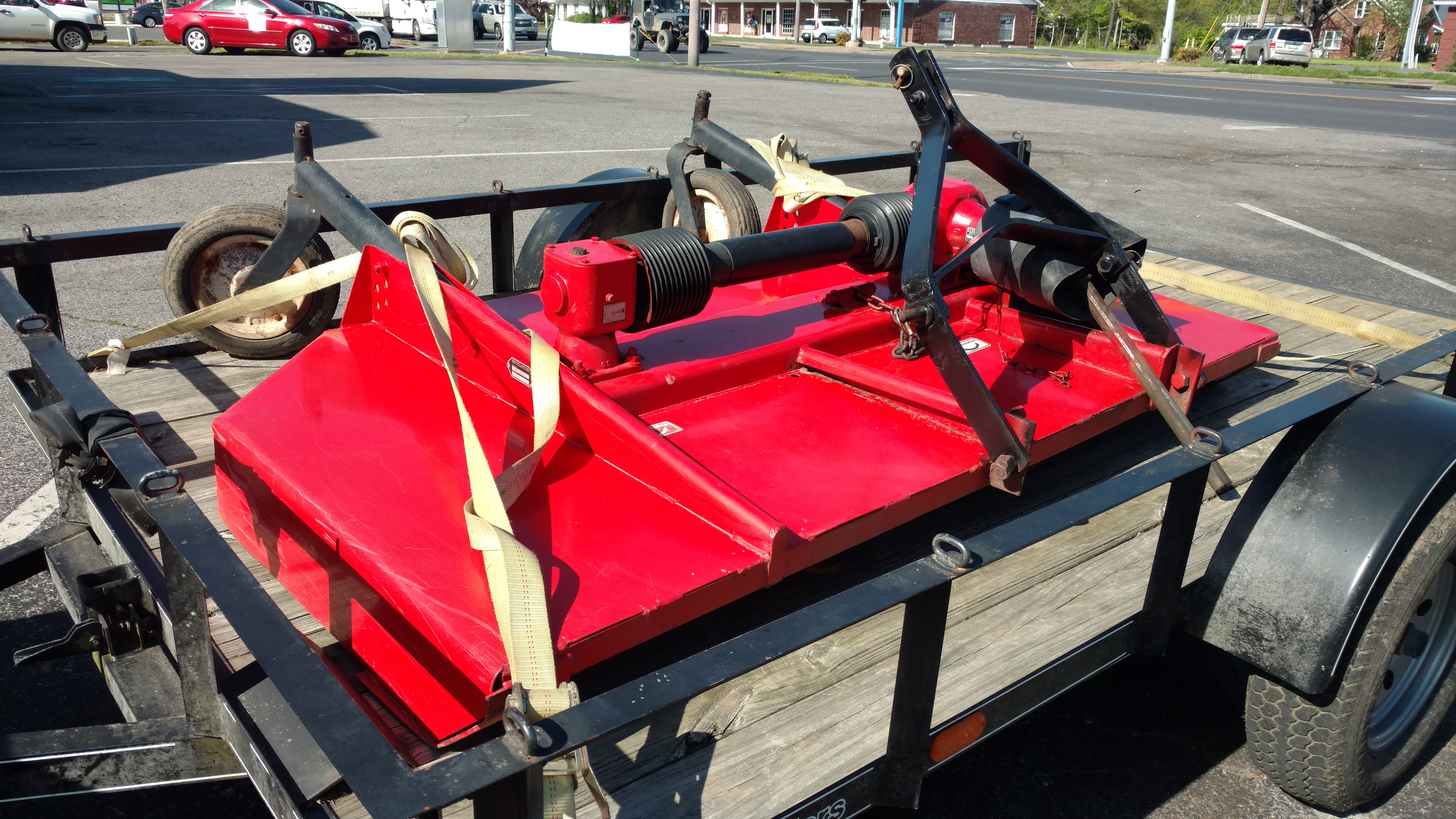

I saw one last week for the first time but it was scrap due to using it as a heavy brush cutter and I saw this one on Craigslist when I double checked the area postings and saw this one and hauled it home this afternoon. Looking forward to trying it out soon. At this point I see it as a finishing mower without a belt. :)
Below is the link I read in detail before purchasing.
SQ84T Series Rotary Cutters
The seller showed me his collection of old post twin cylinder era John Deere's. He used a factory produced LPG 4020 to load this cutter on to my trailer. He refills it from his home propane tank.

As one can see in the first post the 3PH A Frame was somewhat twisted and welded well it broke. While it can be rewelded the thing is still twisted. BH has revised the A Frame hitch and a complete new one is around $400.
A guy up the road is where I first saw a Bush Hog SQ84 twin spindle rotary cutter but the one he had a lot of patching on the deck due to being used in too heavy of bushes, etc but I remembered he priced it un repaired for $500 so I went back to look at it. At some point in past repairs someone had put the improved hitch on it so I offered $400 for his SQ84 and he took it. It has all four blades on it and all the gear boxes turn freely and was complete with PTO's and slip clutch and both rear wheels are intact and serviceable. While this new style 3PH A Frame was still relative straight I had it beefed up and got it back today. I like my first SQ84 so now I have a complete set of spare parts and a new improved hitch on the good one in the photo.
