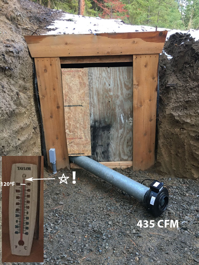

Well today I did a little testing. I directed to duct towards the "intake" end of the genset, that's all I could do with what I had (time & materials).
489148d1479965958-burying-generator-vault-into-bank-img_7231-jpg
With it closed up, (& 435CFM fan running as shown) the temperature quickly rose to beyond the range of the thermometer. The load on the generator is 160watts of lights, a 40A battery charger. So the generators barely working at all, just running it's engine.
489149d1479965958-burying-generator-vault-into-bank-img_7236-jpg
I ended up running it like this, with the plywood just to deflect noise. There's snow on the ground, this can't work in the summertime. Gonna need a lot more flow, I'm wondering if 1500CFM isn't enough. Maybe in the summertime it just can't be in the vault. I think I'm going to have to use one of my signal wires for a remote (temperature) alarm.

Build a temporary wall 3' in front of the door and a couple feet wider so the sound coming out of the open door hits the wall and bounces up. See if that helps. Think an L shaped passageway like in front of a public restroom door.
   / Burying a generator vault into a bank #75
I think you need to vent from the top or near and with a larger diameter fan maybe on a thermostat. I installed a 16in dia. louvered fan in my greenhouse and it really moves the air. It is fairly quiet with louvers. Something like this... Commercial Shutter Fan - Exhaust Fans | Greenhouse Megastore
Probably going to cost you about $200 with a controller/thermostat but you could mount to upper end of door with no ducting and allow for some draw at the bottom. Maybe the intake has a mesh vent to keep the hardy critters out. Forgive me... thinking out loud.
   / Burying a generator vault into a bank #76
...I ended up running it like this, with the plywood just to deflect noise. There's snow on the ground, this can't work in the summertime. Gonna need a lot more flow, I'm wondering if 1500CFM isn't enough. Maybe in the summertime it just can't be in the vault. I think I'm going to have to use one of my signal wires for a remote (temperature) alarm.
In general, an internal combustion engine needs two sources of air, cooling air in and combustion air, and 2 more vents to remove air cooling air out and exhaust. In your situation you need only 3 since cooling air into the vault and combustion air in can be common. As you discovered, just pumping air into a closed chamber is not really going to cool anything since there really isn't any flow.
You need to both run your exhaust outdoors and allow a place for heated cooling air to leave. The air inlet can be constructed from plywood since it only handles ambient air. A square or rectangular cross-section plywood tube 4' long will do the trick here. Set it up with the ends closed and air inlets on the top or sides. Force the air flow to make 2 90 degree bends, which will allow the air to flow, but will attenuate the sound. If you got some of the sound deadening material used to line plenums in hot air heating systems to put inside the duct that would be the cat's meow. I would use galvanized heating duct for cooling air removal, since it is going to be hot. Again 2 90 degree turns, and here you really need the sound control since the duct is metal.
For the exhaust, I used steel exhaust pipe and a tractor muffler, but you could probably get by with gas vent pipe like one would use on a hot water tank. Although, routing the exhaust through a muffler does reduce sound levels.
The HF fan at 1500 cfm was low for my genset, which was larger than yours. You might get by with it, but if I were doing it again I would go larger.

What you lack is cross flow ventilation to eliminate hot pockets. Hot air naturally rises, so allow air in at the bottom and exhaust through the top. You need enough air volume in cfm to eliminate the temperature rise. The turns in the ducting help reduce the noise, but need to be lined with a sound deadening material. The ducting needs to be large enough to handle the job.
I would agree with Curly Dave that a muffler and exhaust would be best if the genset is stationary. About half of the overall heat is exhaust. A large muffler is fairly cheap. Using a muffler and a 1500 cfm fan/exhaust ventilator should fix you up.
