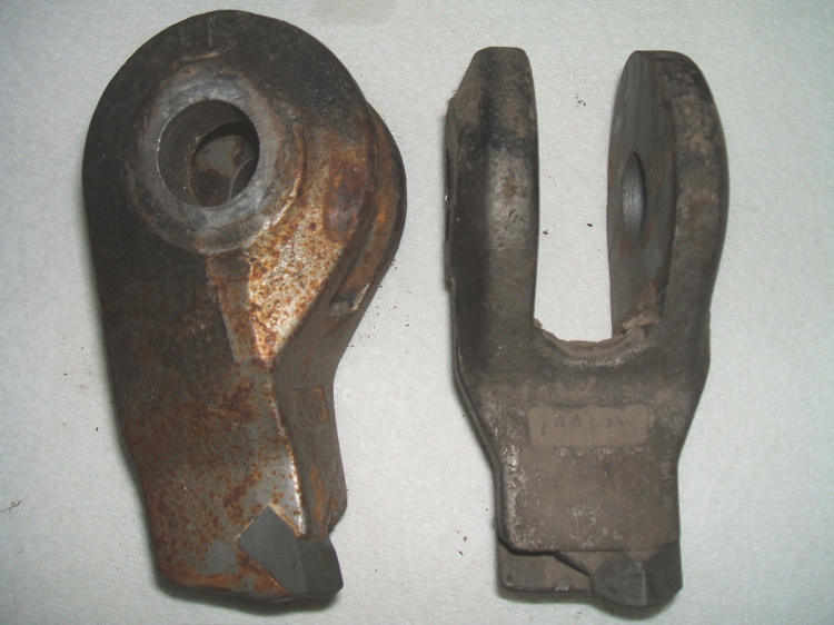

My first season of mulching with a RC100/Fecon head has come to an end due to snow. My jobs have generally been cleanup and thinning on relatively rock free terrain. During aproximately 500 hours of use, I replaced a dozen teeth as soon as there was any carbide breakage. In my case, all were only half broke (1/2 of the double carbide tip) and initially I replaced two teeth when only one was broken. The broken tooth would be replaced as well as a good one on the other side of the drum. The last three brakes were replaced with wore teeth with no breakage.
The broken carbides all appeared to share the same thing: poor brazing or none in the area where the carbide fell out.
At this point the head runs smooth and looks like it will go another 400 hours. I am considering taking a rosebud to the teeth where 1/2 of the carbide is broke, removing the good half and the broken half, then re braze two good tips in a holder.
Has anyone out there done this before? What about the use of hard surfacing rod behind the carbides to slow up erosion? Does anyone out there know the source of the carbide tips used in these hammers? My guess is that they are European due to the 36mm nut and bolts used.

Do you have a picture of those teeth and holders? At seventy five a piece, it would start to get interesting enough that a CNC machine shop might be able to duplicate them (maybe??) I had a discussion with a stump grinder guy here that had the same problem. Only his teeth were in the $15 range, and carbide for the blade was about $10, so it didn't make sense to buy the carbide and still have to put a torch to it. Time alone would eat up the $5 difference, but your talking a lot more leeway, unless something is different about them.

Sandman, here is pic of two teeth (bull hog). I haven't made any attempt to replace the carbide inserts yet but I couldn't do any worse than who built these. No apparent brazing where the carbide decided to leave.

rebrazing teeth is or can be economical. usually carbide defects are warranty
issue . as i recall all the teeth are made by the same guys in germany.
if the carbide chips(small) keep running it, wear it out!
not a big difference overall. 1 tooth isnt going to make a difference.

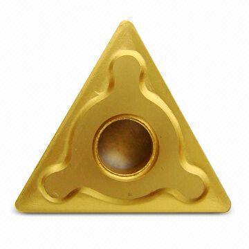

Are you saying that Fecon has come out with a new product that lets you change out just the actual carbide and not the entire mount holding the little piece of carbide?
I've been wondering for some time now why the carbide couldn't be as easily replaced as it is on metal working machine tools.

I thought stumpjunkie was implying that Fecon had come out with a new carbide holder that allowed you to simply replace the carbide by unbolting the old and then bolting on a new carbide insert, instead of having to replace the entire hunk of metal that the carbide is brazed to.
Something like this is what I'm talking about:
