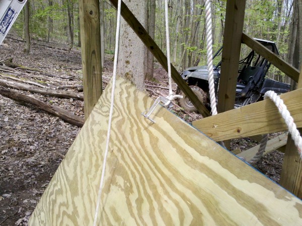

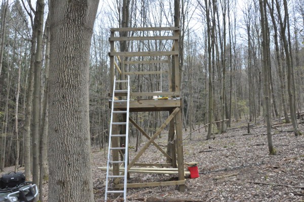

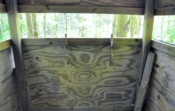

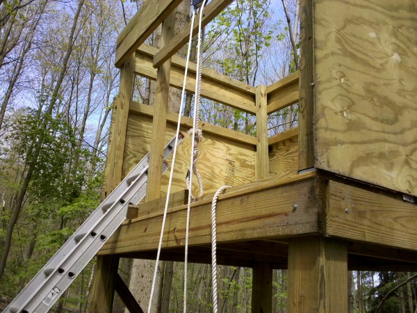

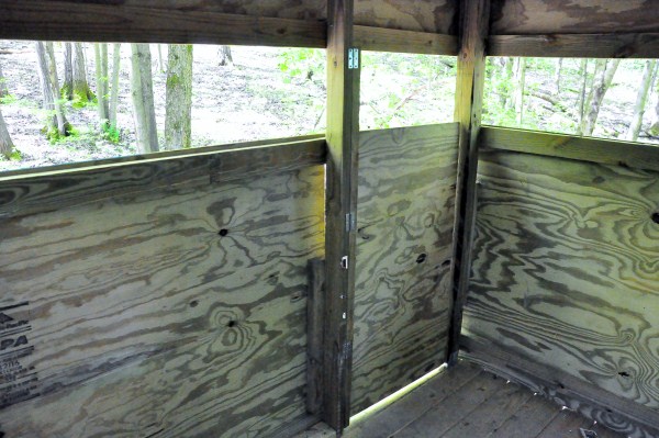

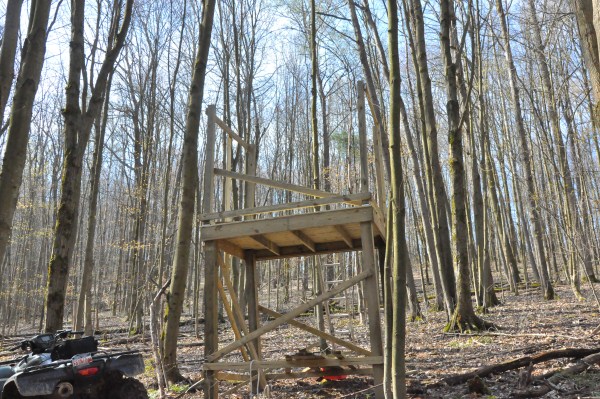

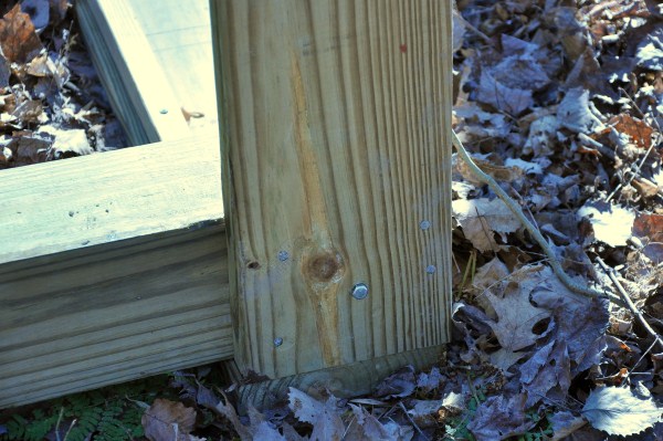

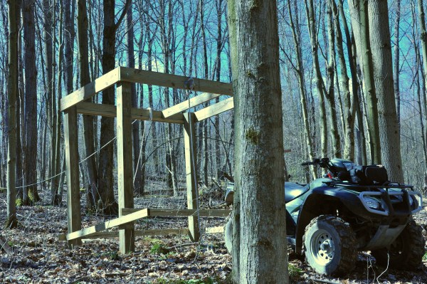

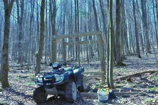

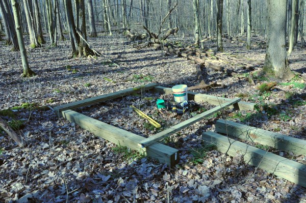

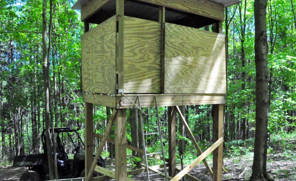

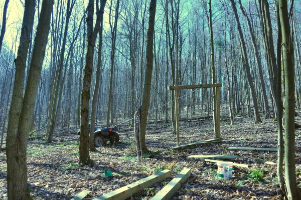

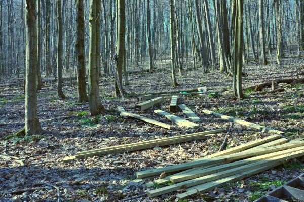

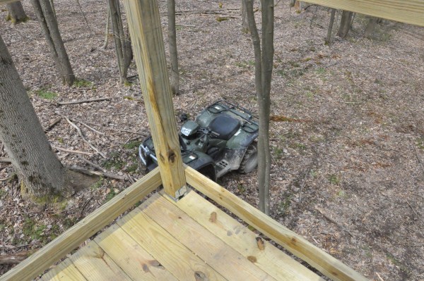

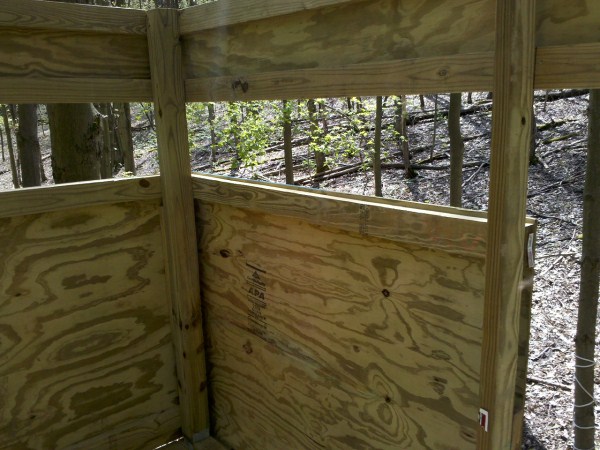

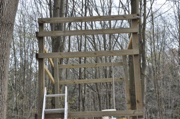

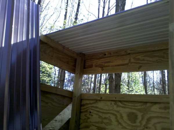

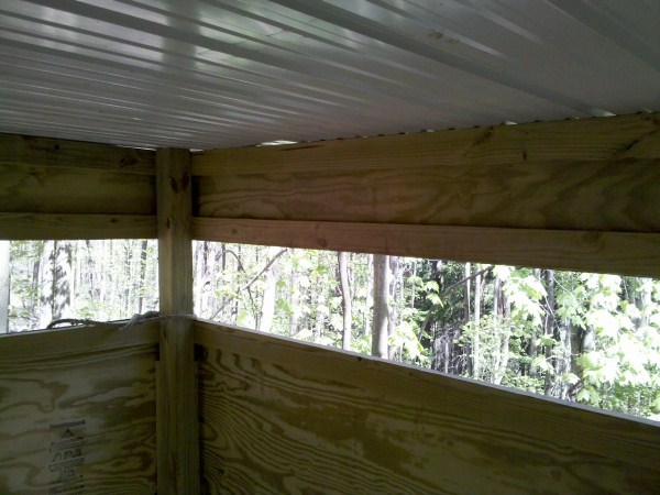

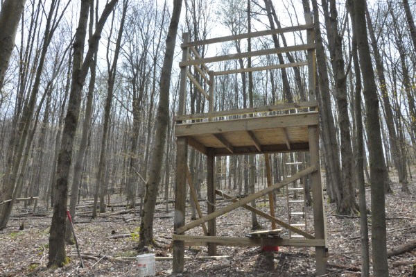

I finished this up a couple of weeks ago. It is 6ftx8ft and built on 6x6's. The bugs were biting but I got her done. Built it all out of PT wood and a metal roof. Should last till my grandkids are old enough to deer hunt. Sure better than the 3 2x4's I used to stand on .....The finishing touch was hanging the gunrack in there.

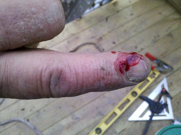

Looks like you even personalized it with your own blood!!!!

That's what I would call a "Condo". Extra sturdy.
If I could make a suggestion, fasten some 1x10's or even better some 1X12's in the openings of your shooting windows. Make a shelf/table top to lay your rifle on when you're shooting. You'll be amzed how much steadier you are when using it compared to just the 2X4 under the forend. Put some old carpet on it to make it soft and quiet. Put you some overhead shelves to hold your water bottles, heaters, extra propane bottles, flashlights etc. Are you going to put some awnings over the windows to keep most of the rain out and block the sun? Carpet on the floor (to dampen sound) and a couple of swivel chairs with arms would finish it off perfectly.
CB
/ Built me a new Deer Blind
Thanks for all the suggestions. I have about a 14" overhang on the roof on all sides so that will help with the weather. I may velcro clear plastic on the openings but haven't decided whatto use yet...

Nice blind!!! I see you are from western NY, not too far from me in Oneonta. From the pics it looks like there are no ceiling/roof rafters holding up the metal roofing?? Looks like it is attached to the top plate on the walls only. I am sure you get quite a bit of snow where you are located. You might want to slip in a few rafters to hold up the metal roofing while it is under a snow load. Unless that metal roofing is super thick. You and youre family will have many years of memories hunting out of that blind.
#20
I have an 2x1" steel I beam running down the middle of the entire roof. No pics at this time but will post some when I take em.........Good observation though........
