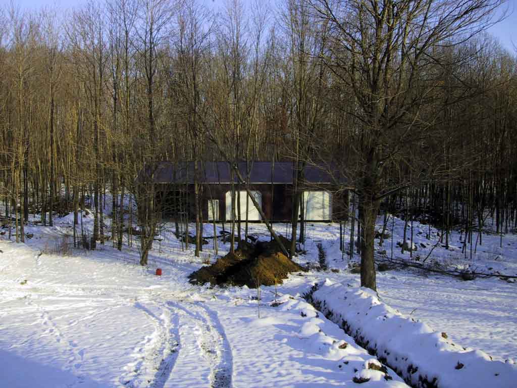

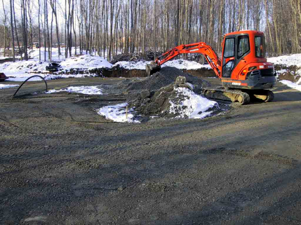

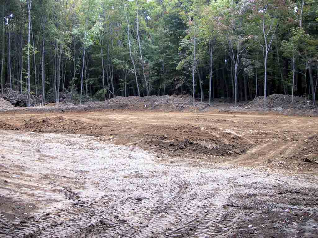

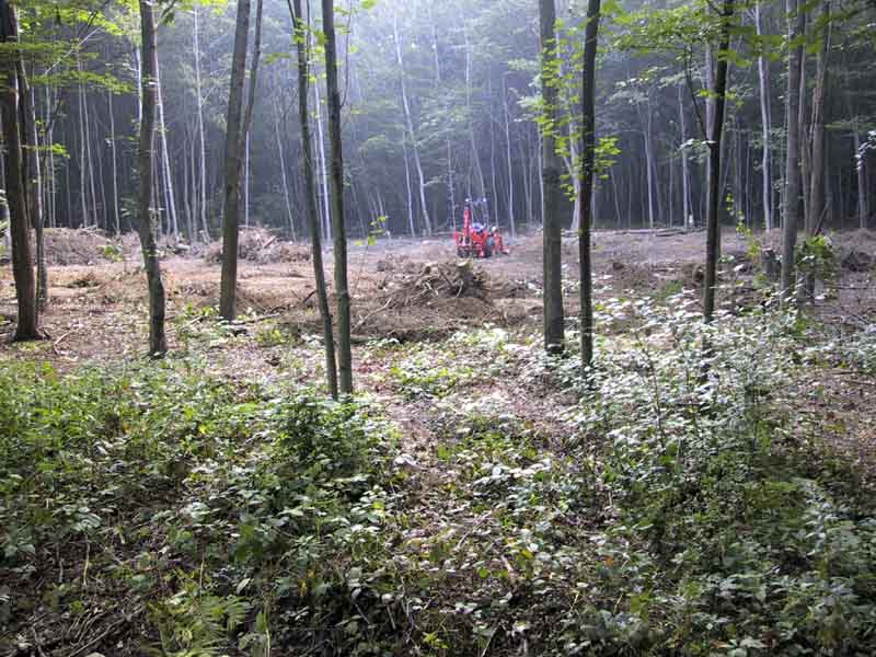

That's pretty much what we had to deal with here - the site where I wanted to put the polebarn was in the woods and it sloped to a gully in the center of the parcel, which was draining a fairly big area (my guess would be probably 4 or 5 acres at least) Image No. 958 shows the area after most of the stumps were removed before being graded. Overall, there was probably a 10' difference in elevation from the northeast corner (+5') of the pad to the southwest corner (-5') - we used the clay spoil from the northeast to fill the southwest and level out the rest of the pad.
And we still carted off I don't know how many 1 ton dumptruck loads of topsoil. Image No. 999 is just after we started removing the topsoil.
If you look at Image No. 1046 you can see how it ultimately wound up - in the right and rear of the photo we dug into the hillside probably 4' or 5'. The front and left of the image is filled in to a depth of 5'.
This was done on and off with a variety of equipment over a period of maybe a month or so. TBN'ers Pineridge & JASTN70D graciously came over and contributed their tractors, boxblades and time and my neighbor and grandson brought over a JD 310 TLB and a 763 Bobcat. It was amazing how much dirt there was to be moved. The spoil material was spread out in small lifts and compacted just by driving all the equipment over it.
Image No. 1077 shows the framing up and Image No. 1108 shows the completed product.
I still have to handle the overall drainage for the area. This will entail finishing the french drains around the building, final grading on the cut into the bank, and some upslope grading to redirct runoff away from the site. Once I get that done I'll finish leveling and compacting the gravel inside the barn and pour a floor .... finally ! :D
