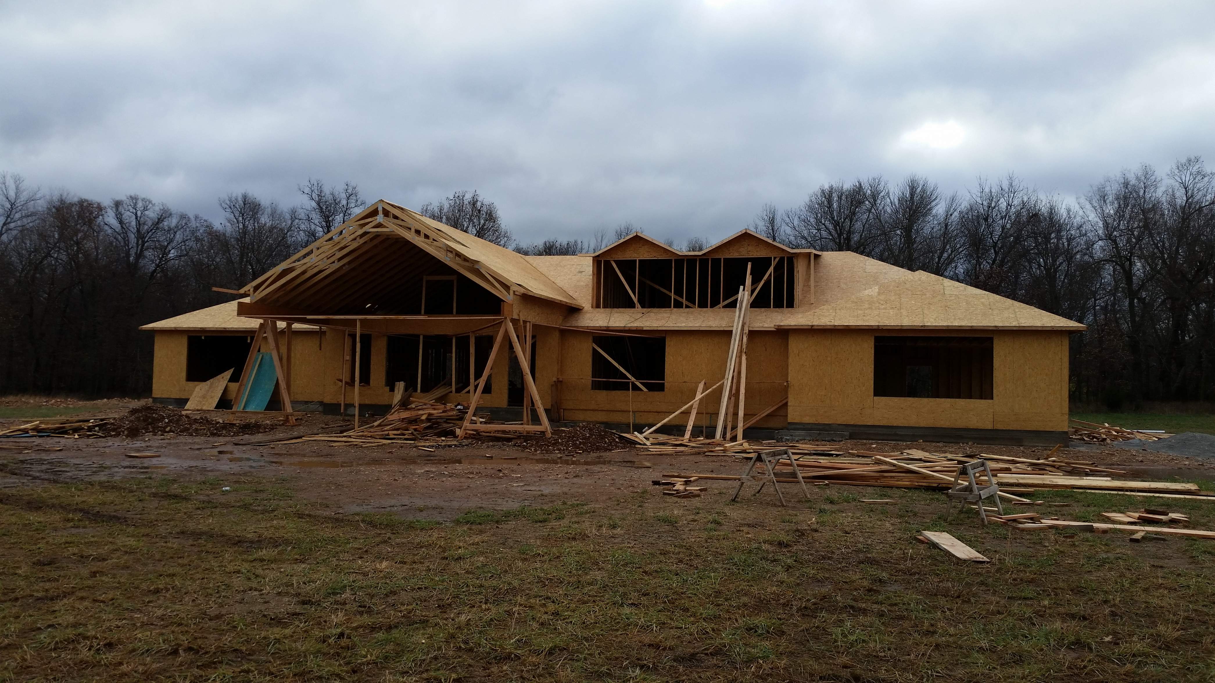

I saw in one of the pictures they left a lot of mess laying around.
Yes. No argument. They are, in fact, PIGS. Turns out, it is a father and his 3 sons. They do have a good reputation but I guess that reputation came without any regard for worksite cleanliness. Perhaps this is unimportant to many - but - I will never give this crew a recommendation.

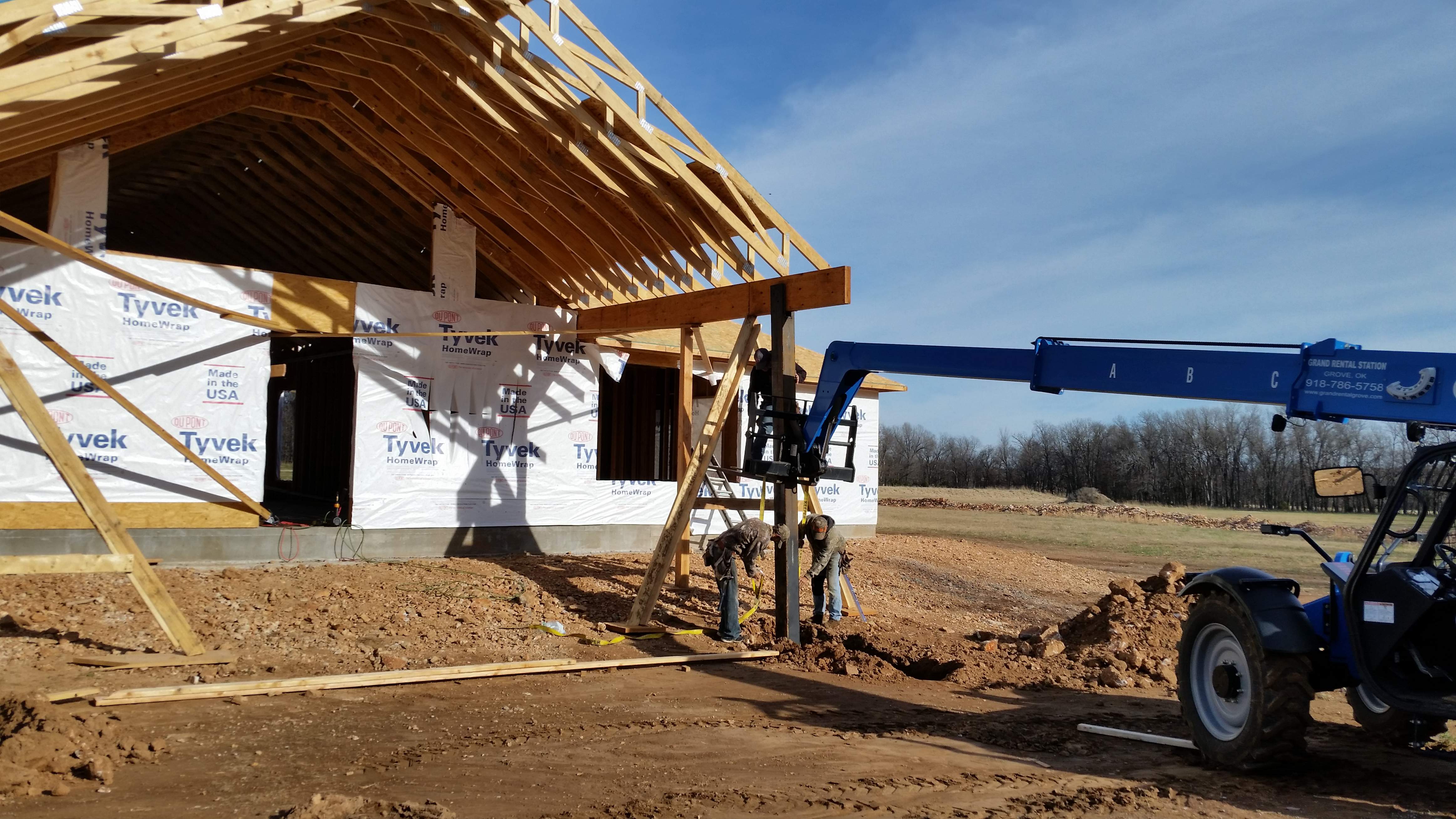

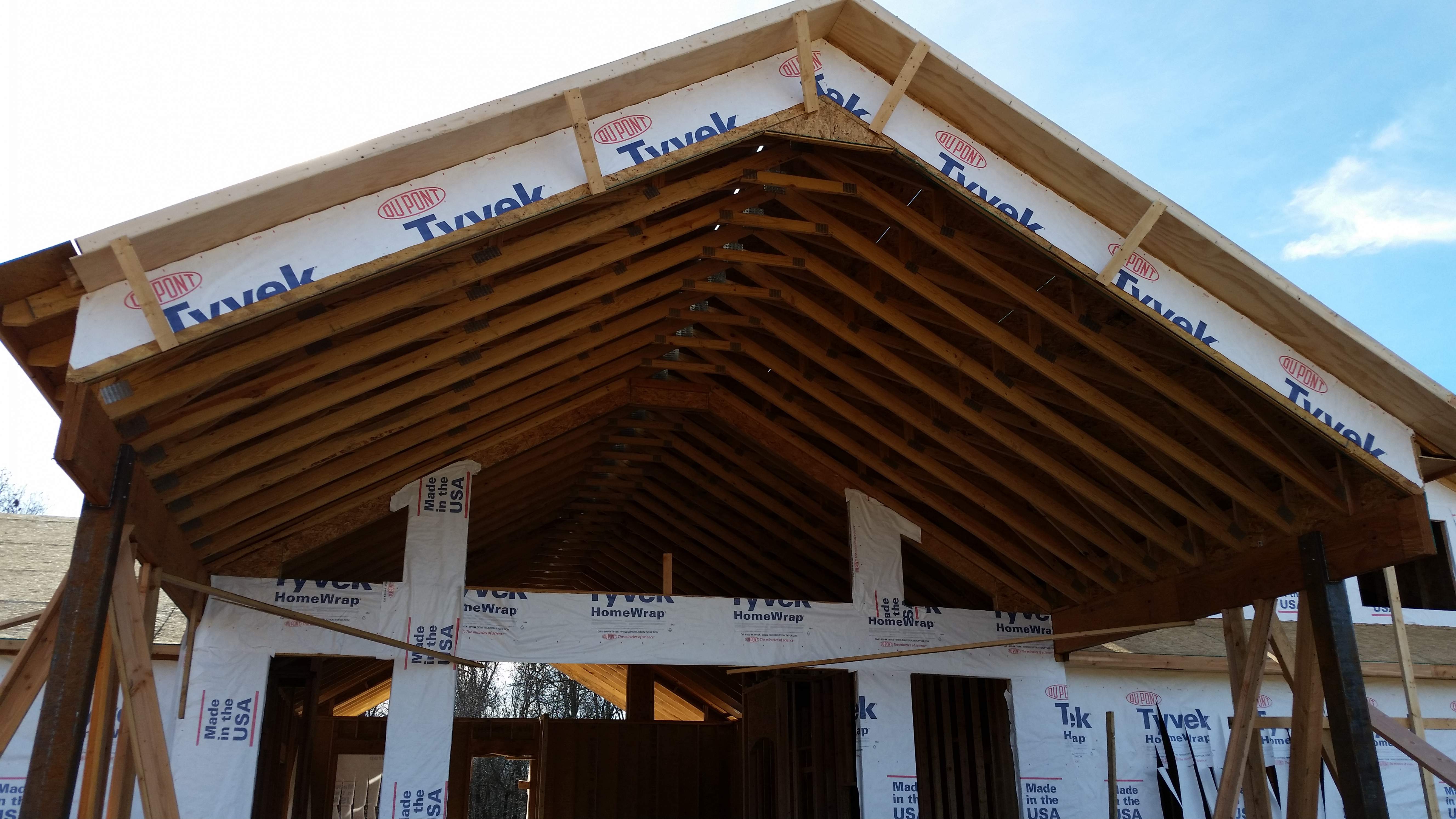

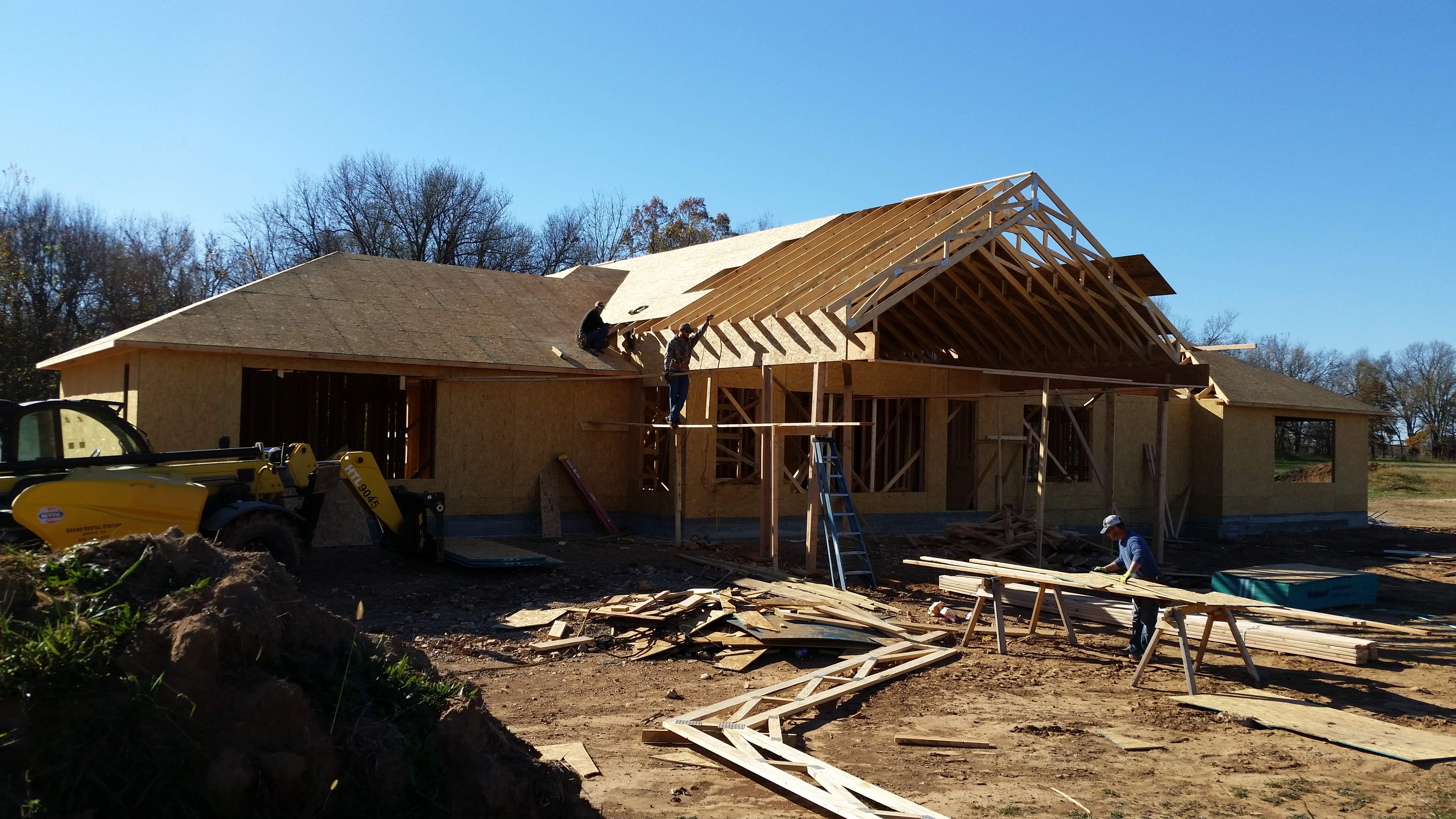

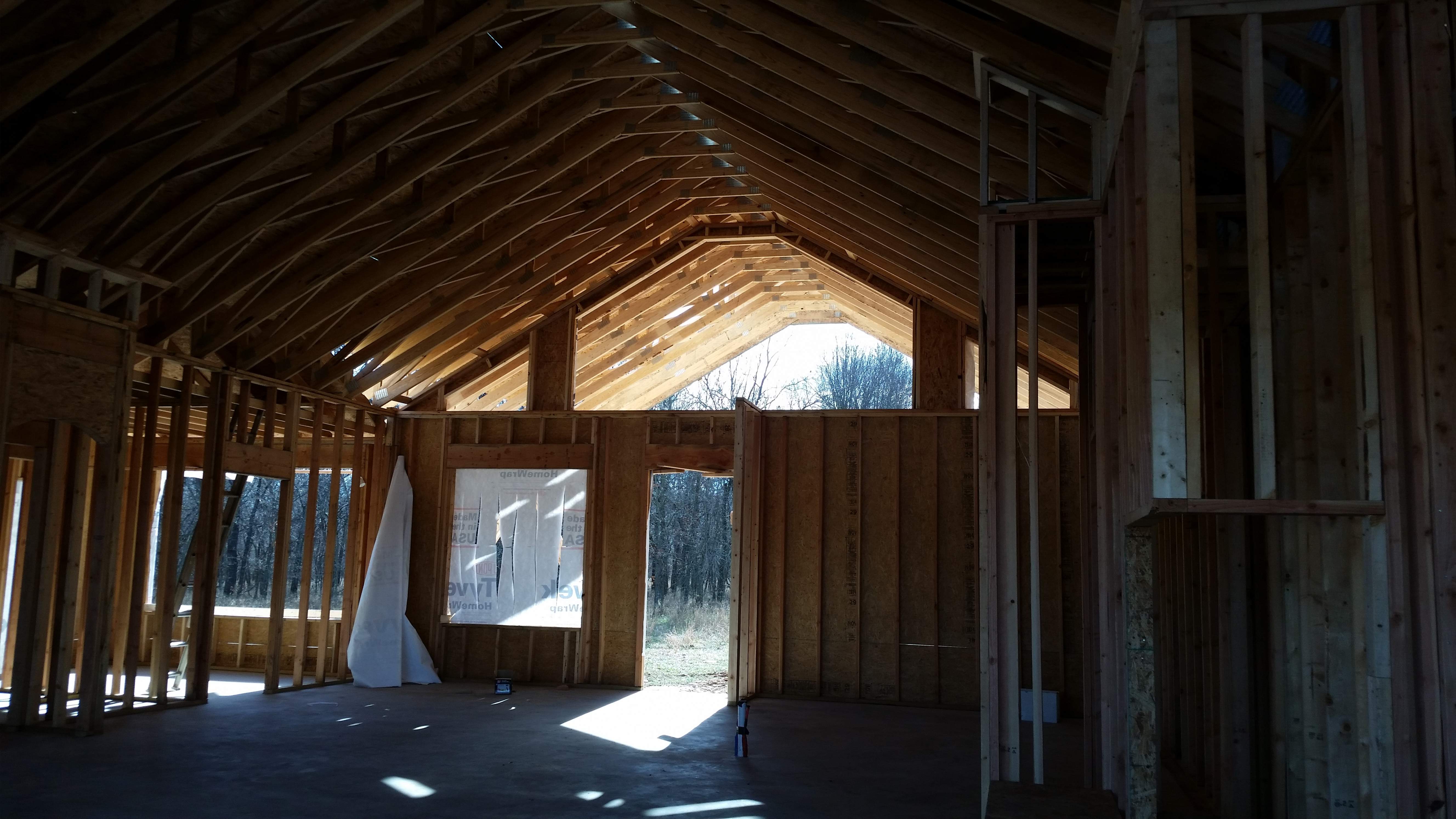

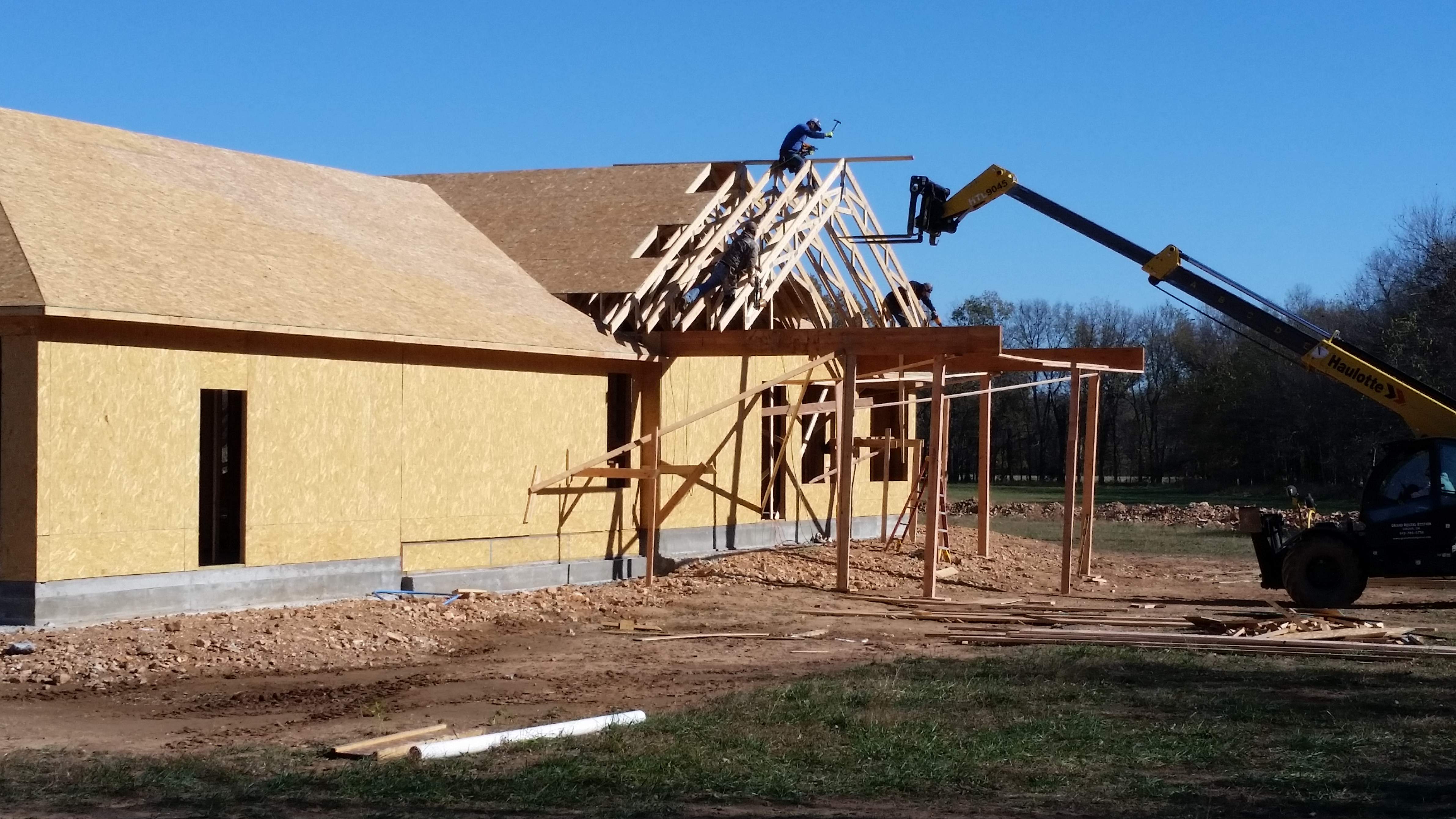

Seems like time to post a progress update.
We installed the steel posts for deck roof support yesterday. Concrete will be poured around the feet, about 5' deep, then concrete porches will add support for another 2' or so.

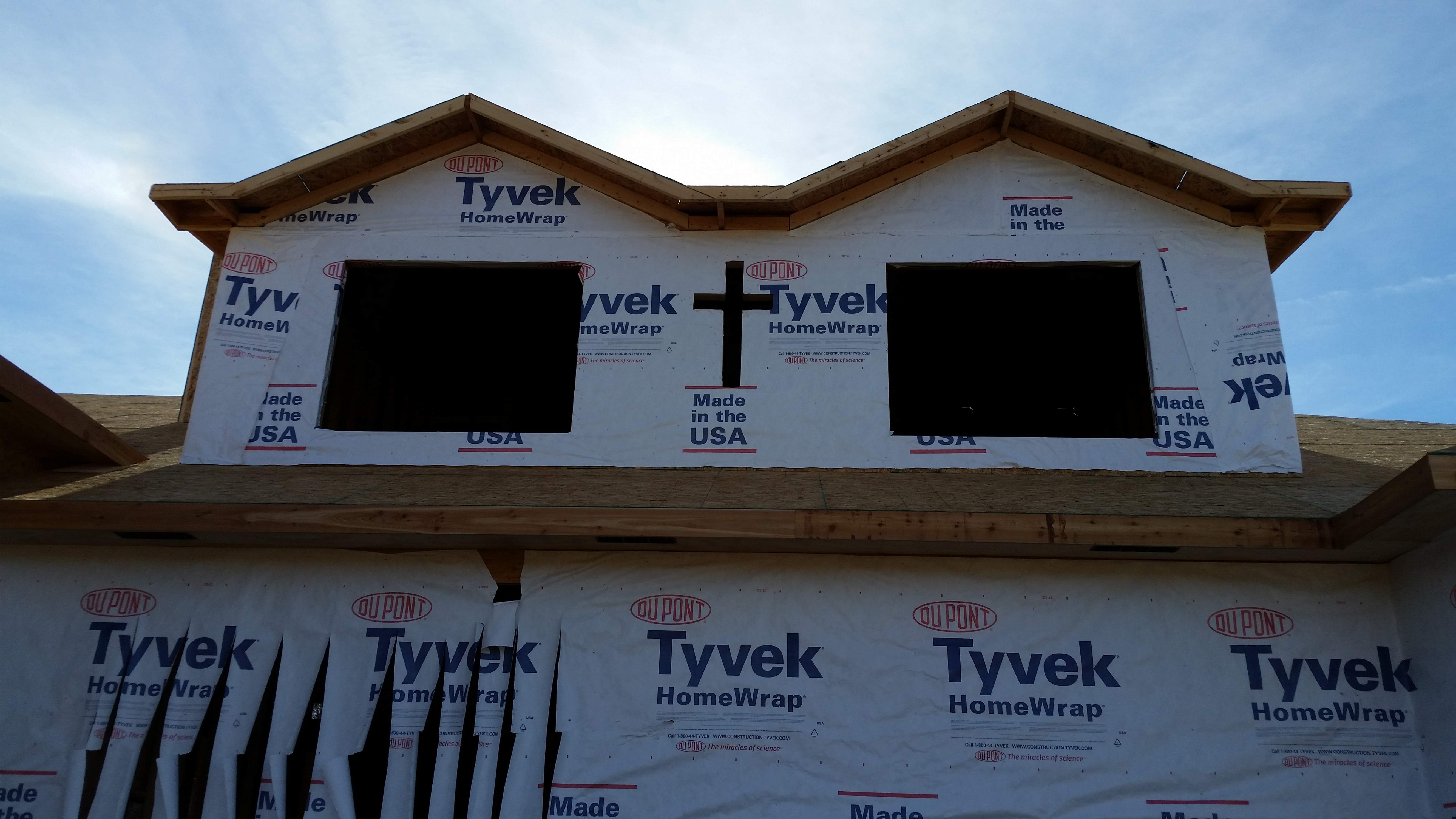

The basement and 2nd floor stairs have been completed and the basement has been framed. We added a "personal touch" window to the upstairs room - a Christian Cross. The one in the attached photo was too small, so we are having it enlarged about twice the size you see.
The framing for the fireplace is finished, and the chimney stack. Today, facia boards, soffit and vents are going up. Tomorrow, the roofing materials should arrive. Friday, with any luck, we'll see roofers - at least I hope so, since rain is slated again this weekend.
The ground floor windows will be installed by the 16th. The upper windows for the great room have not yet been ordered - nor have any doors. We are having a monster of a time trying to get 3'6"x96" front and rear doors.
Here are a few pics ...

Why is the tyvek wrap sliced up in the 5th picture?
Wind penetration through the open windows. It prevents the wrap from violent flapping when the wind blows.
