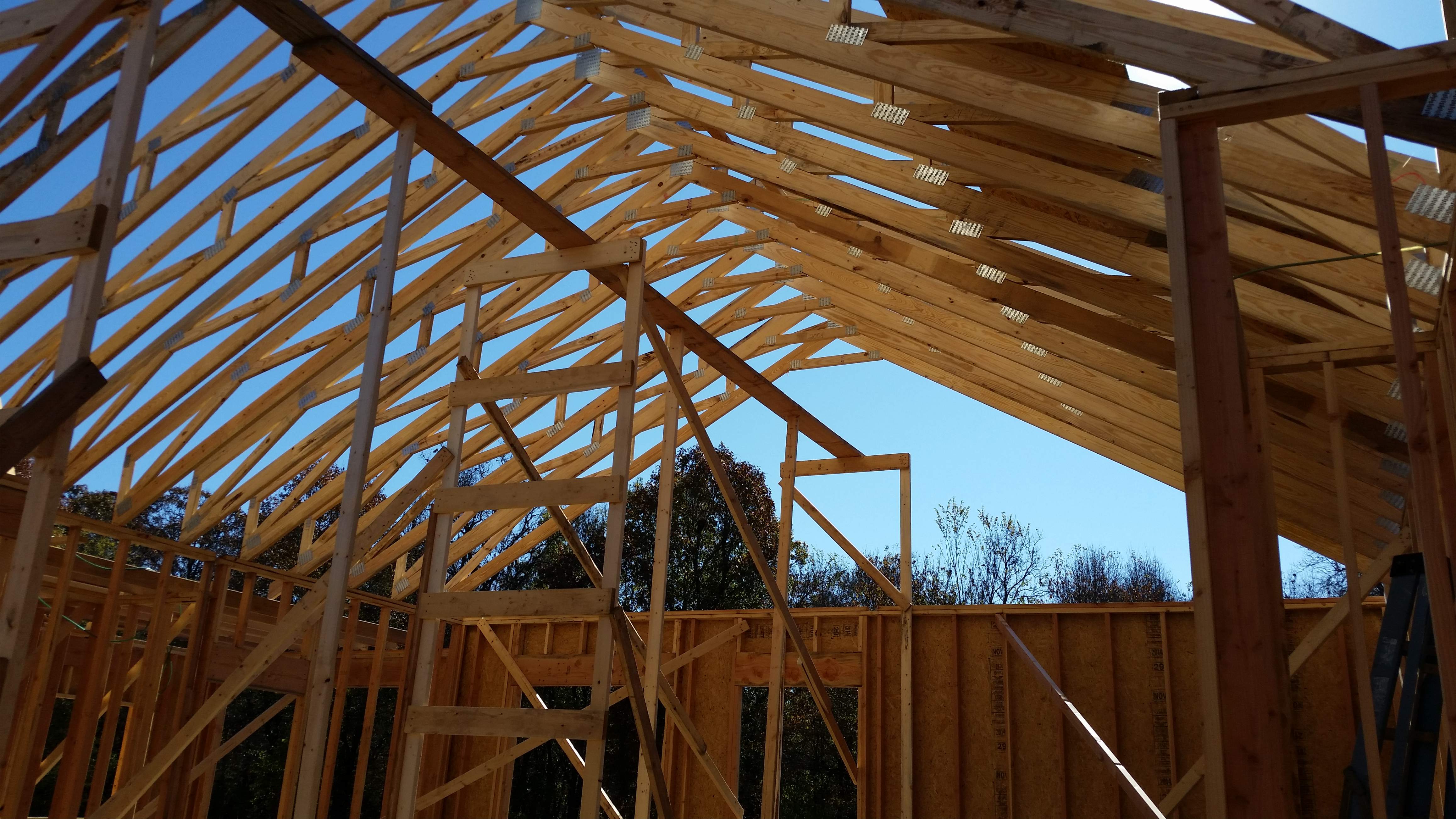

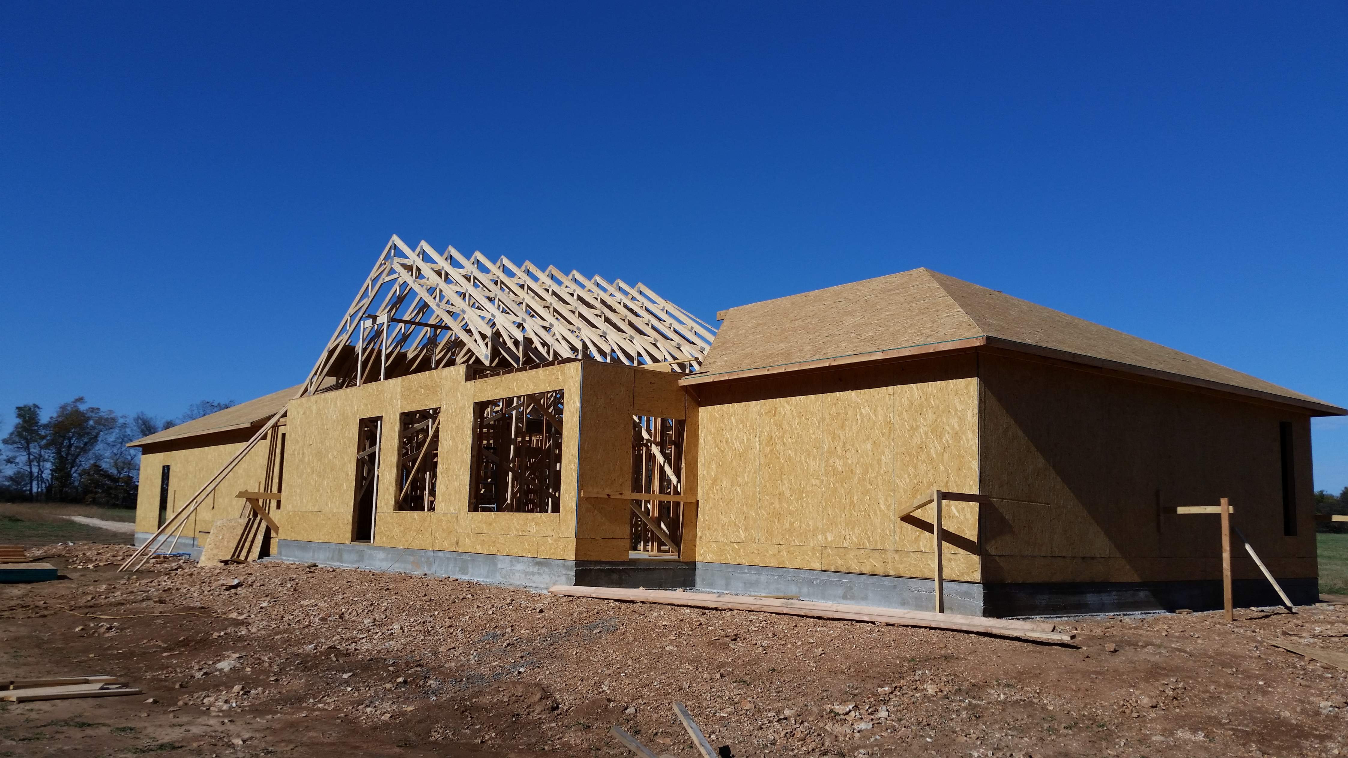

Great Room trusses went up today. Not sure if we'll start on the porches before Thursday because a storm/wind is expected on Wednesday. Without the steel corner posts in place, it could be a little risky. The 2 pics here show about 1/2 of the room finished.

Just to keep things interesting, we've decided to proceed with converting some of the attic space into a usable room. We'll add a pair of dormers to the front of the house and wind up with something close to 20'x20'.
When this all started, we looked at our little 1600 sq ft home, decided we really liked it and just wanted to make it a bit larger. Well, we did that - LOL. With the additional space in the attic, we will be pushing 4000 sq ft. I am convinced we have both gone insane!
