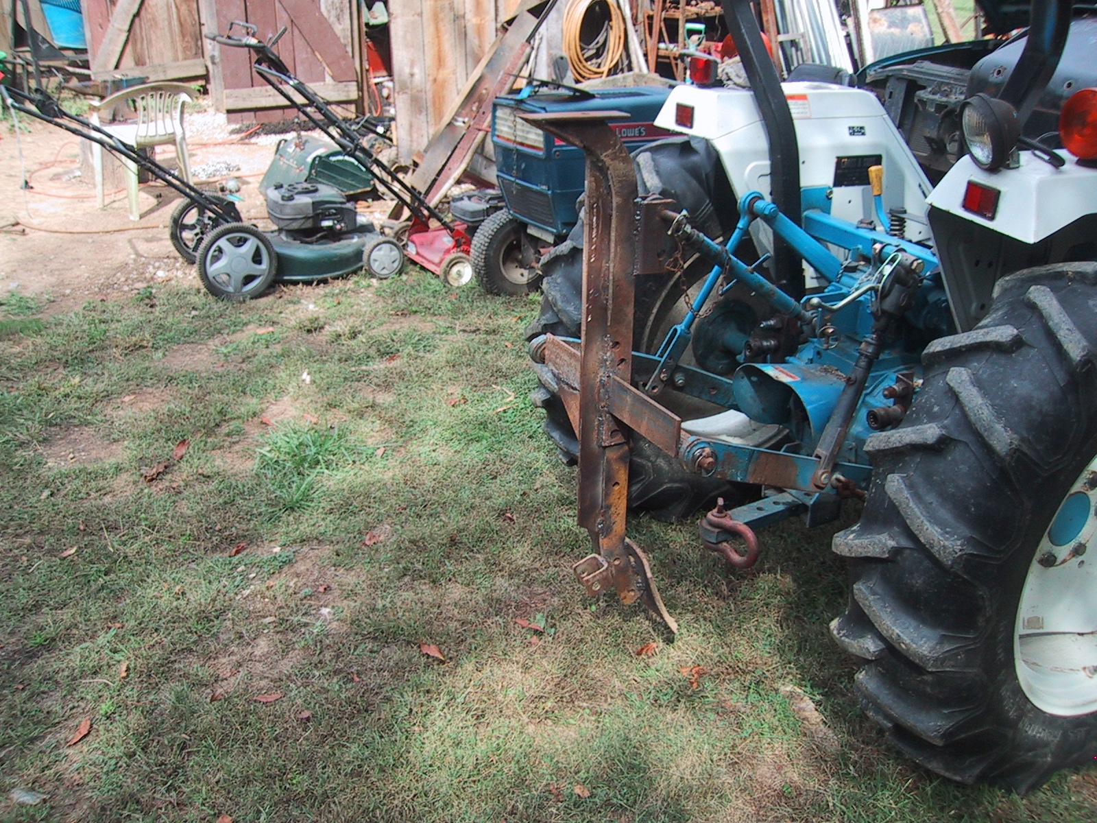

I'm in the process of building a middle buster and subsoiler from the parts of an old middle buster that got twisted a bit somehow. :D I would like to be able to put the plow bottom on for shallow plowing and trenching, and remove it and have a small hardened point for deeper subsoiling and possibly pulling pipe or wire. I'd appreciate any input or pictures of this type of implement to give me some ideas before I weld it up.

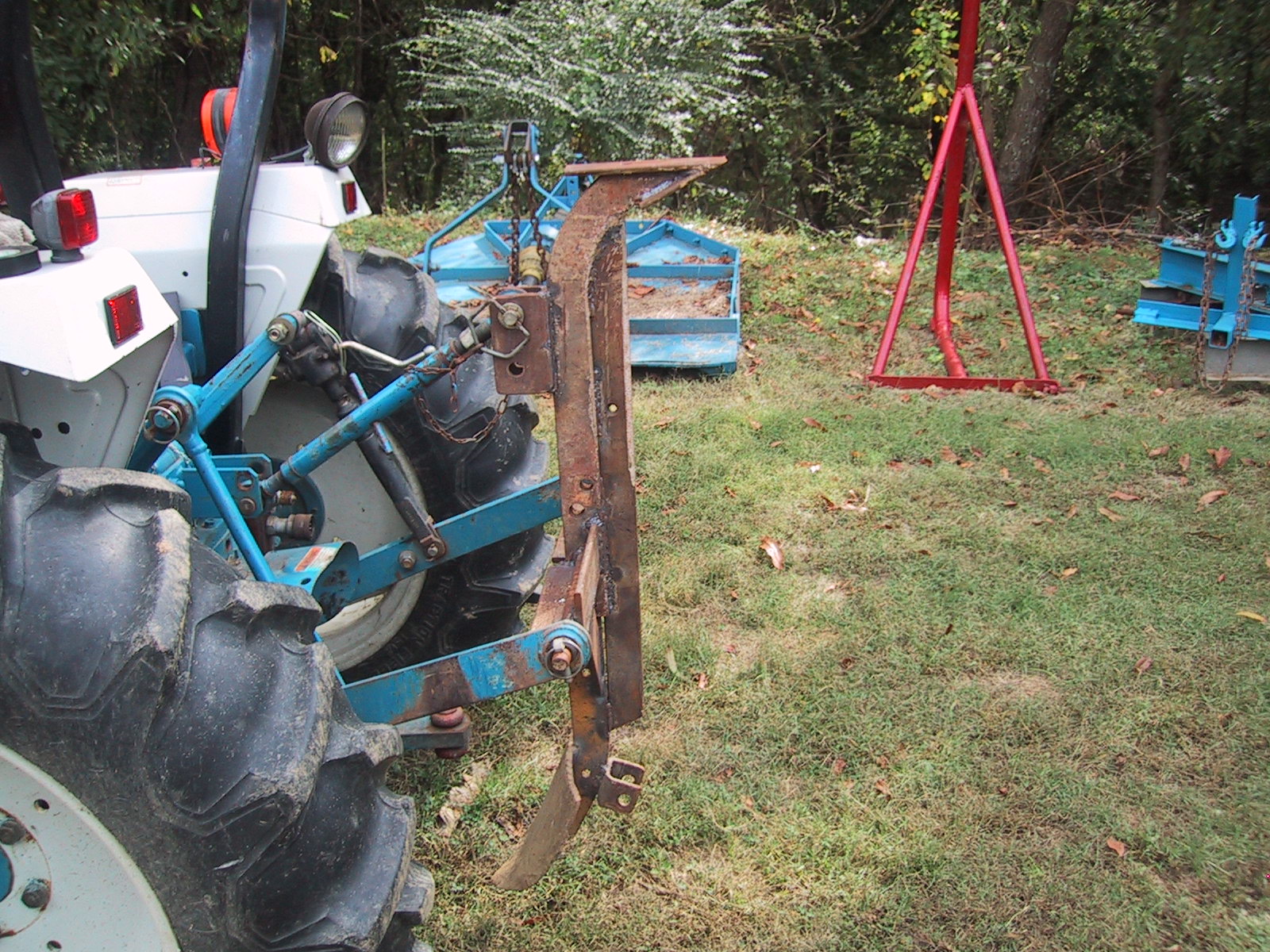

Here are pictures of one I built . Plow on one end Subsoiler on other.

Now that is one cool dual tool there Oldmax! :cool: I have already made a 3 pt. hitch to use with my quick hitch, so I can't do the fliperoo. I'm thinking along the lines of adding shear bolt protection for the subsoiler function as well. Anybody have one with a shear bolt? If so, what size and grade bolt does it use, and how often do you break them?

Thanks djw250 But mine is a toy compaired to some of them . My tractor is only a 1715 N/H - 27 HP FWD so it doesn't half to be as strong as for a bigger tractor . I just built from scraps I had on hand Cutting Tip & front of middle buster are made from Spring steel the rest is mild hot rolled . I made middle buster first then started looking for something to make top out of came up with a lay off plow for a garden tractor . With a little mod that's what I came up with also have a adpt to plow in Wire for it . It does what I made it for . Middle busters are good for busting up ground before digging a ditch sure saves a lott of work with a pick .
