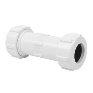

Depending on angles, you may be able to use a PVC compression coupling to put that together.
They'll actually hold pressure, and will work very well in a situation where you have essentially no pressure, though the section you're fixing does need to be mostly straight. I used one recently to fix a 2" line where a tree fell and dislodged/broke a coupling in the ground; in my case there was a bit of a bend in the pipe (it had been laid under tension in a bit of a curve) and when it popped it looked like it wanted a 11° elbow... I used a weed torch to slowly warm up the pipe so that I could gradually bend it to point mostly straight end then used the compression coupling.
In larger size they're not cheap, but could save a lot of digging.
Already fixed and pond drained. This was a 10" line.
