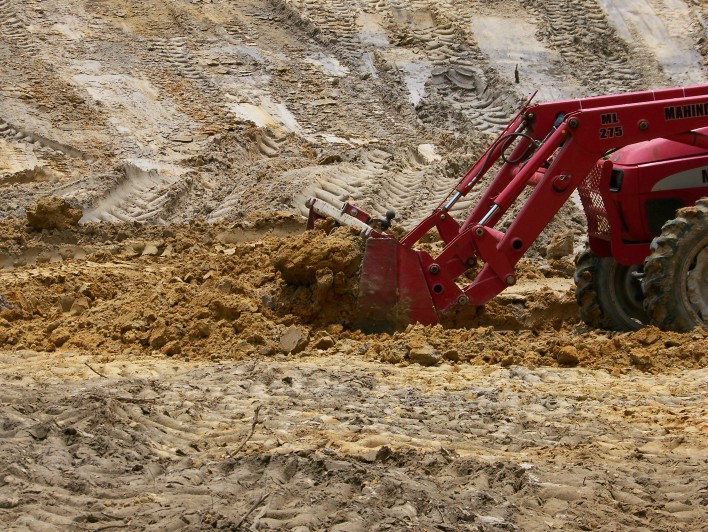

Now you have me second guessing myself. Worked for a couple of hours this morning leveling out the first area of the hillside I started on. Hoping to head back out this evening and start cutting a walk path along the west side of the pond.

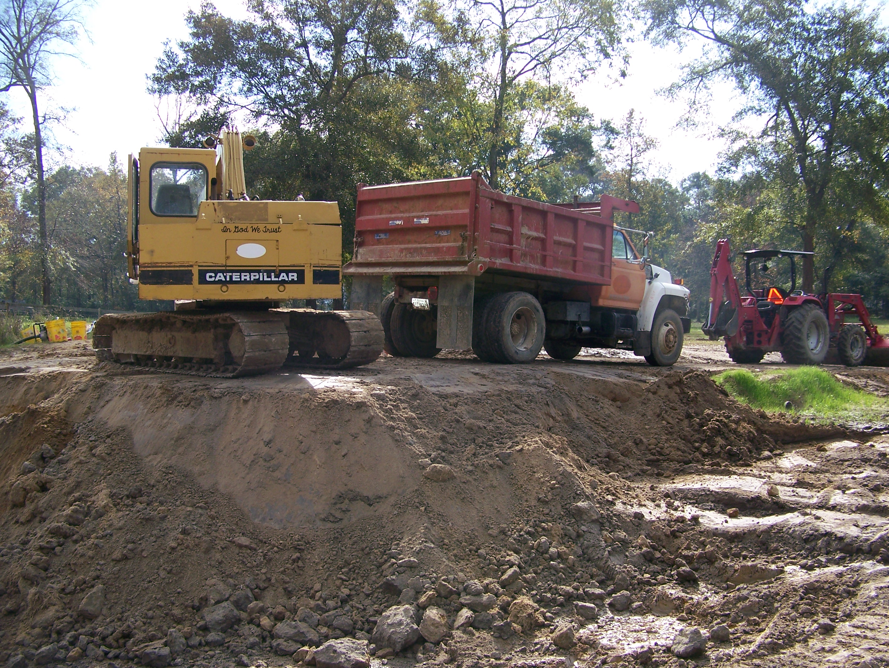

Planning on cutting in a level walk area around most of the pond about 2 feet above the high water line. This will make it easy to mow in the areas with foot traffic. Anything above that on the steeper slopes would be maintained with the track loader and brush cutter. Here's a pic of the cutter on my old machine.
2018-10-31_03-40-23
Finished bringing most of the dam up to final height. Just have about 1/3 to go. It's now close to 3 feet above the highest part of the drain pipe. Will use the dirt from the rest of the walk paths I'm cutting in to bring the slope out so the dam is not so steep.
