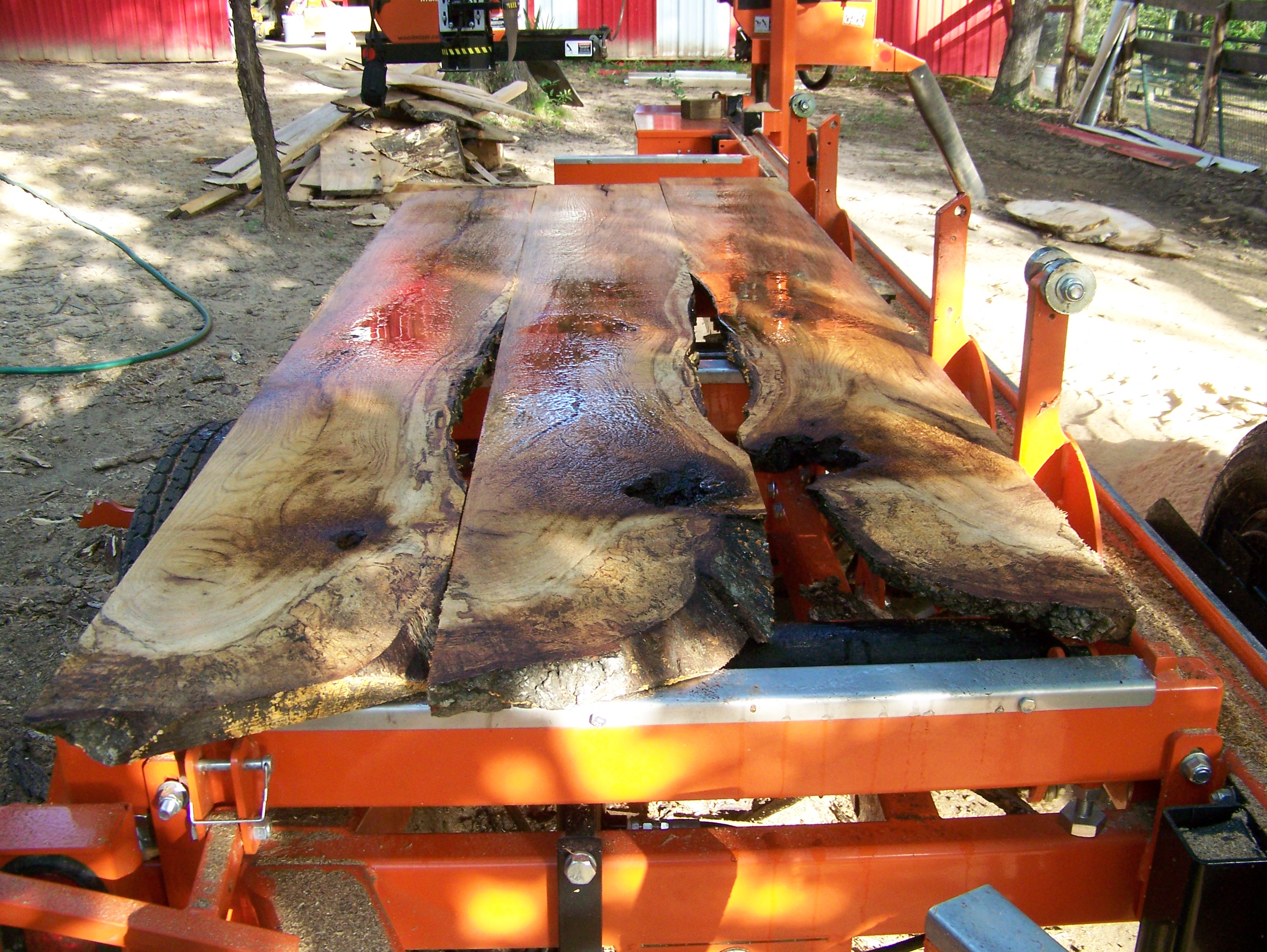

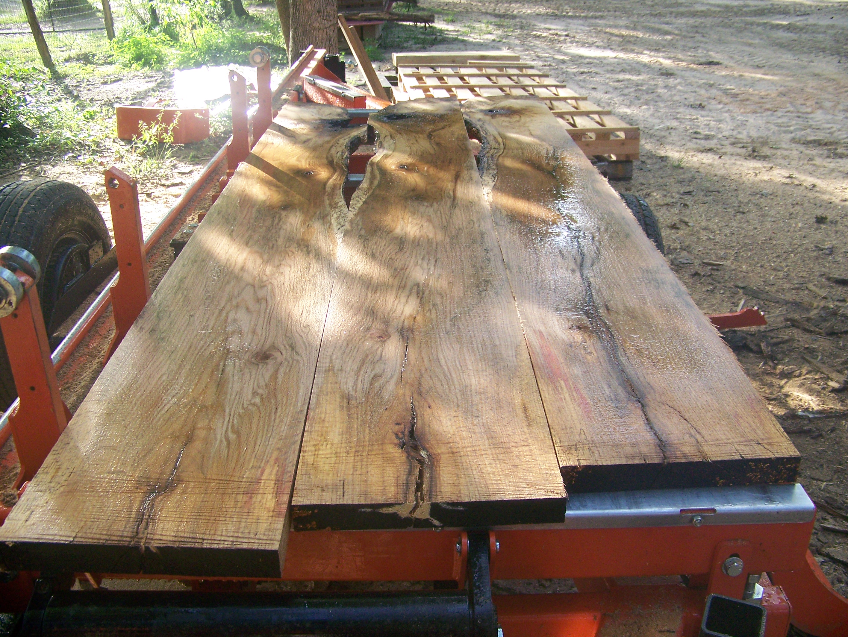

Actually, I am find it easier to sell with rot or deformities. Only problem is I post 3 Red Oak pieces for sale and they all want 6 pieces. Red Oak Table Boards Near.jpgRed Oak Table Boards Far.jpg
