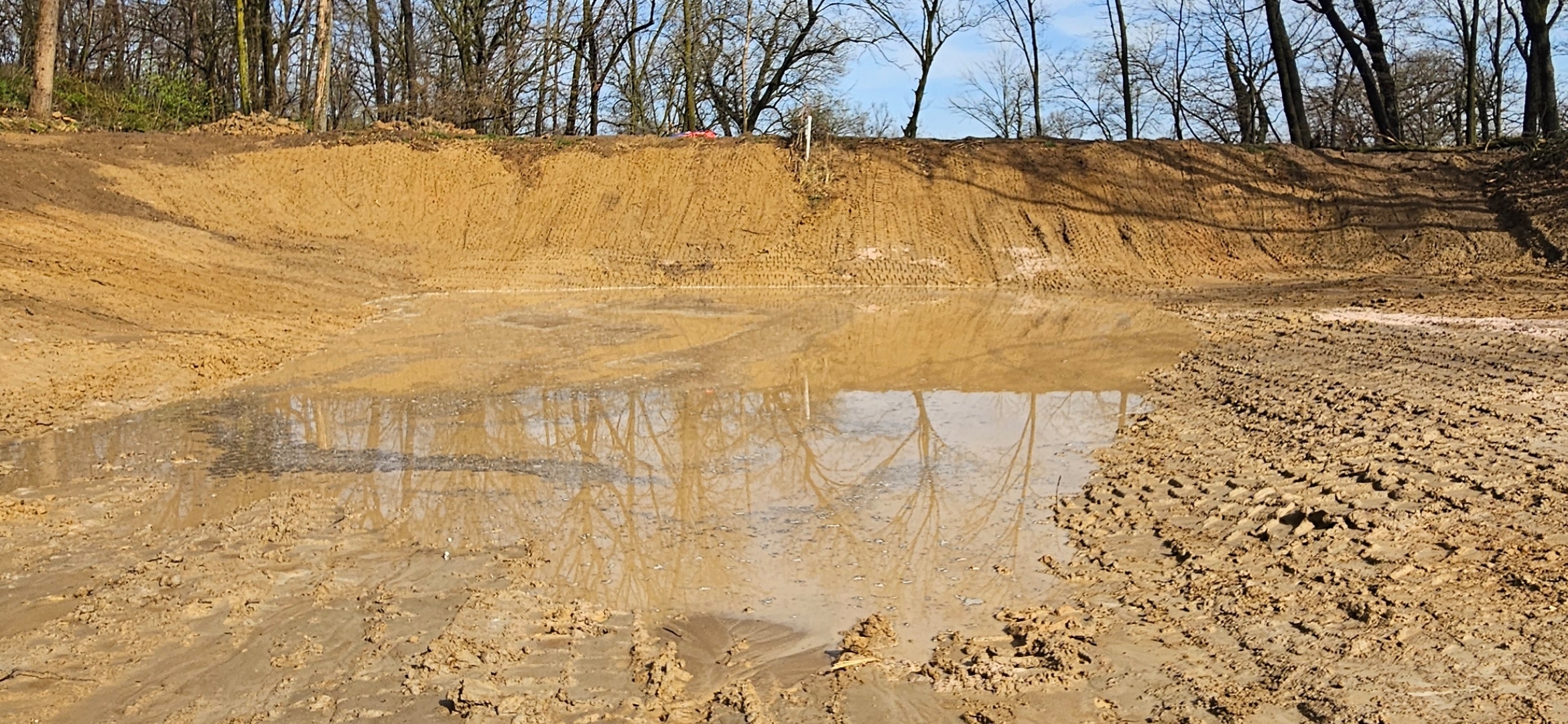

   / Building Lake Corona
#1,254

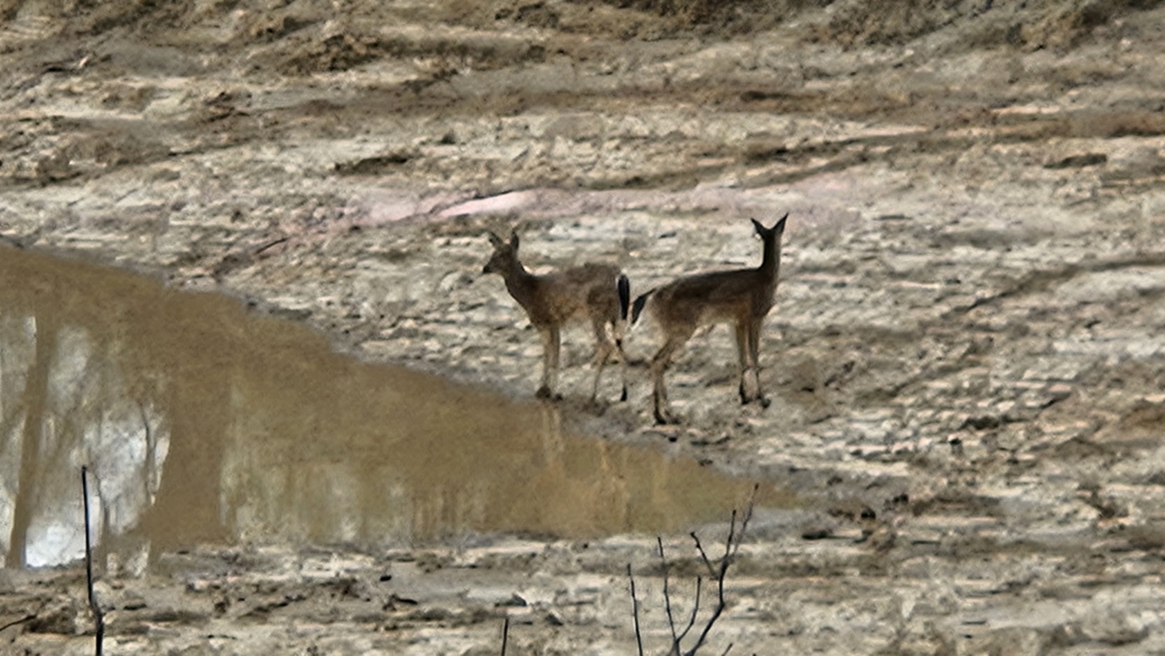

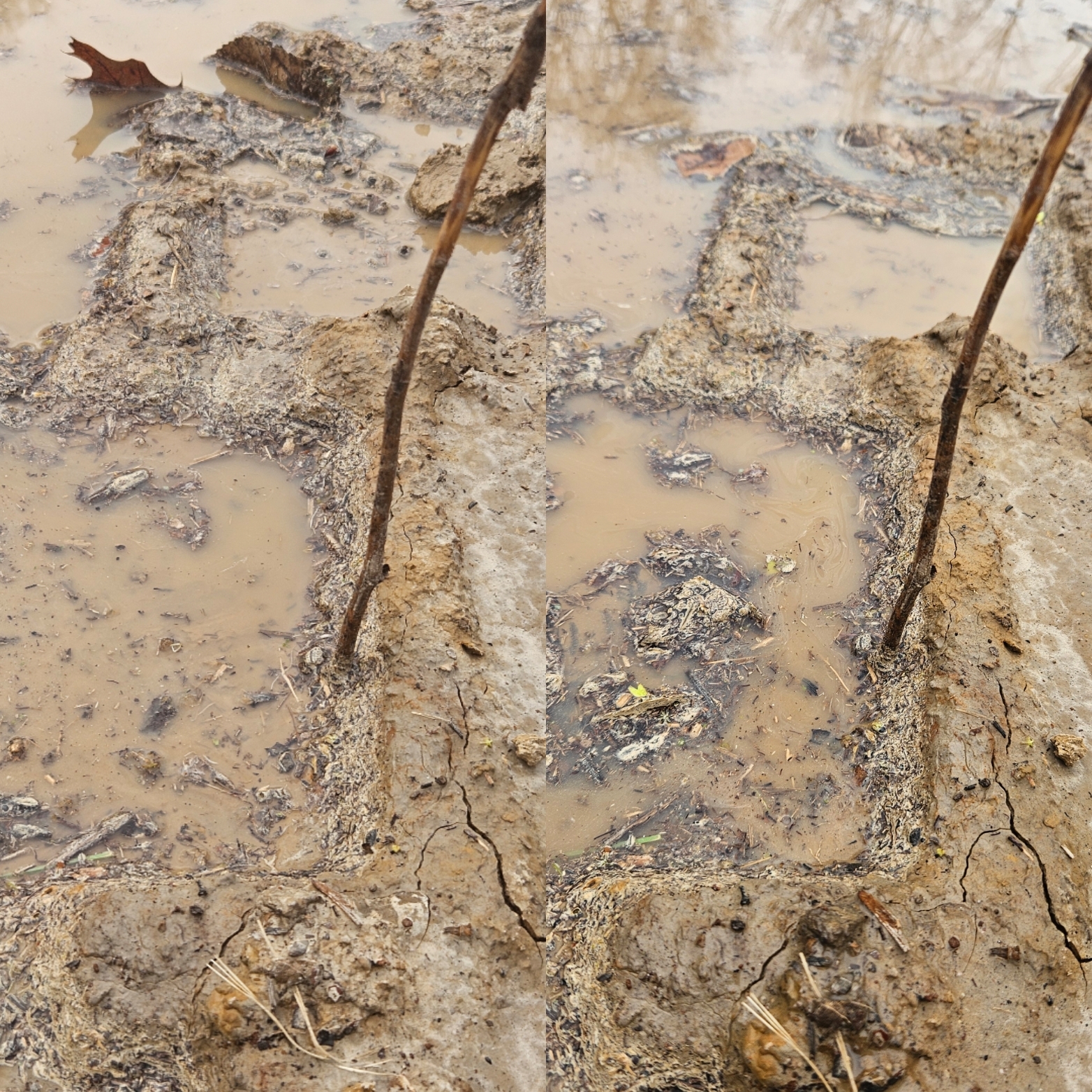

I walked back today to see if water has receded any yet. My very unscientific stick marker I put in yesterday morning hasn't moved in 36 hours. Also the puddles haven't dried up either. Water is shallow so no pressure at the moment but first signs are good news. It also didn't take the deer long to find out their watering hole is back.

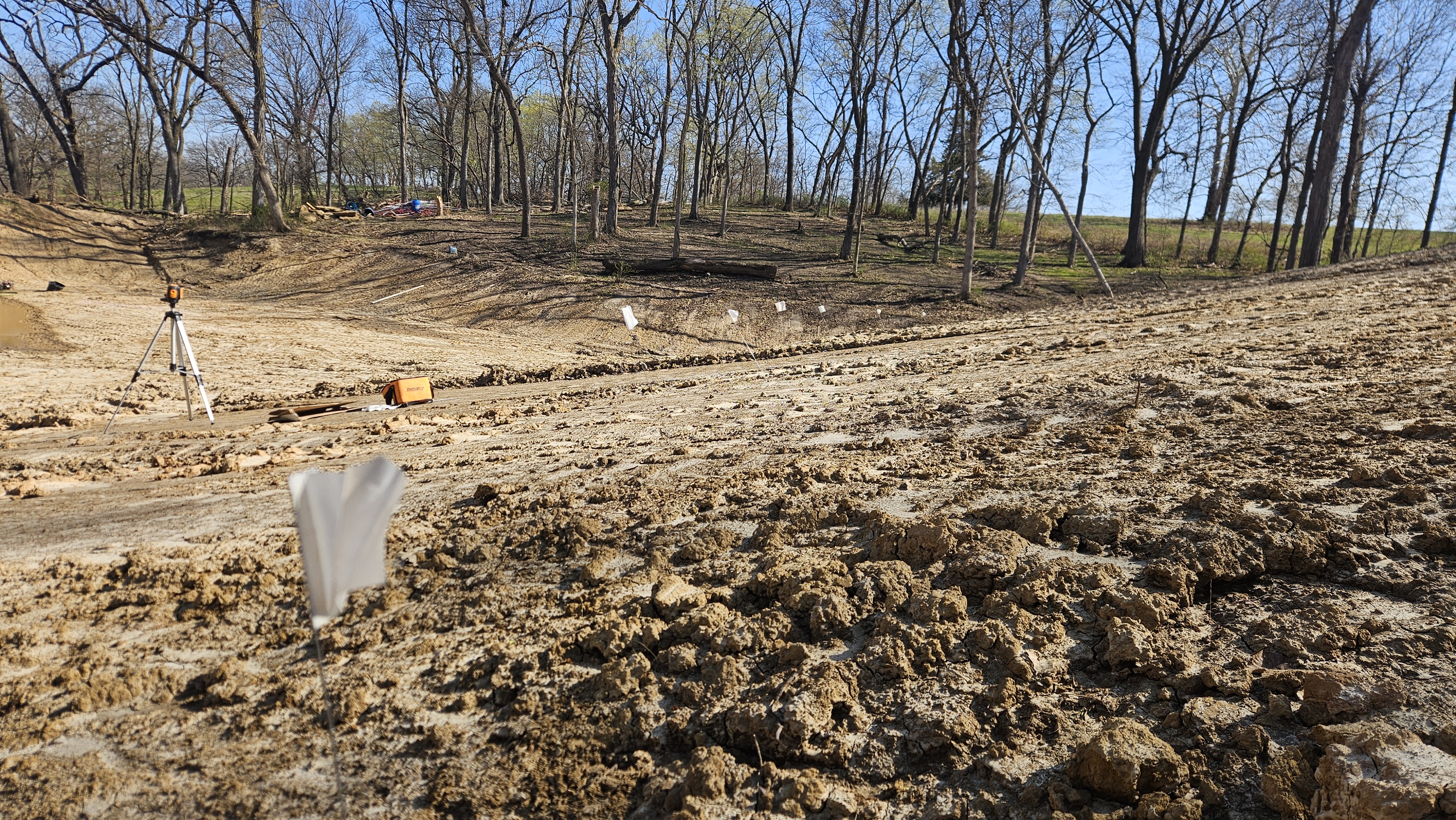

#1,257

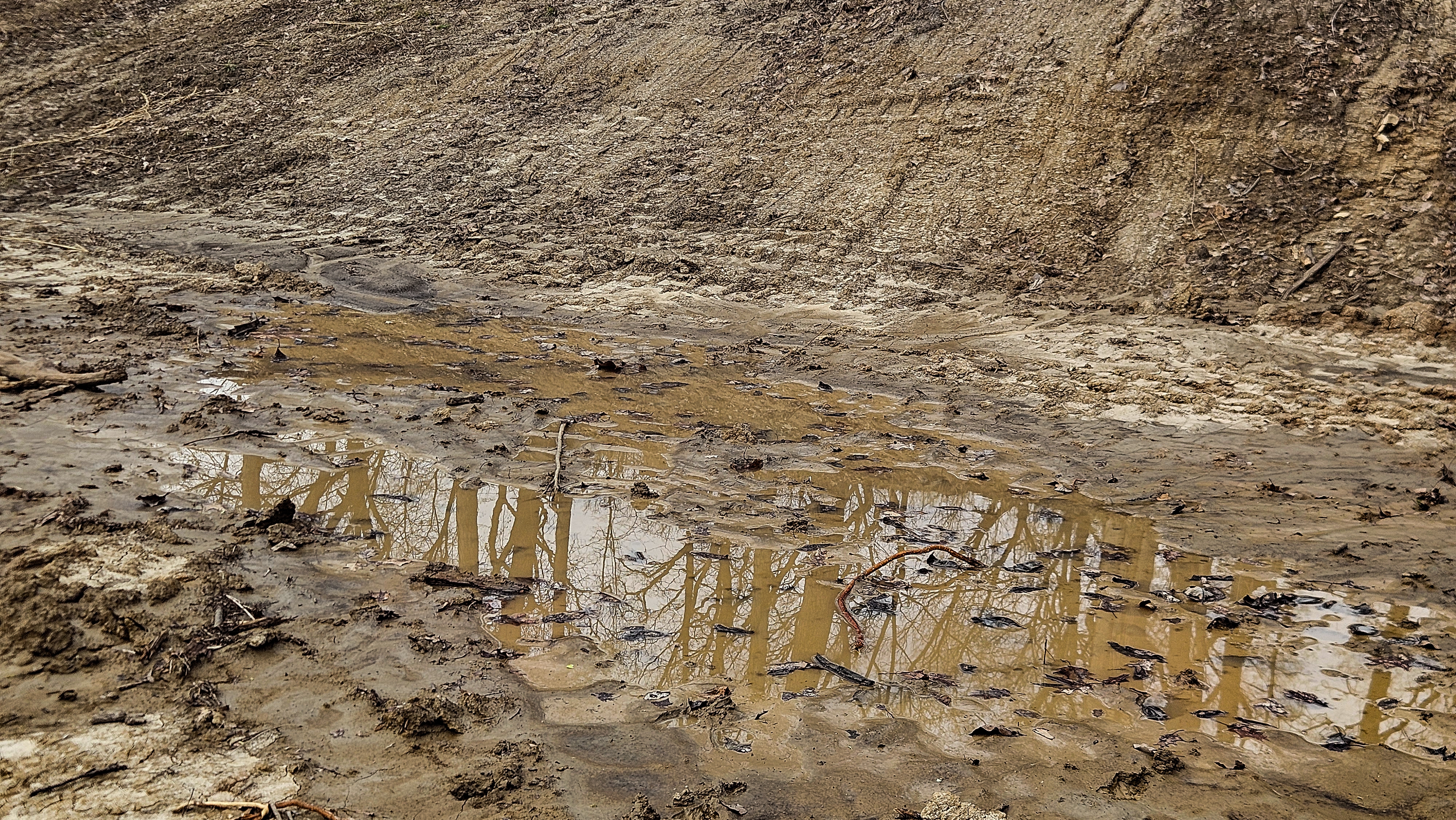

I drained the pond down a bit a couple days ago. Got my flags in for the walk path grade. 6 bags of bentonite total are down now including the 3 under water. 9 more to go tomorrow then will start cutting in my walk path and using that clay to cover.

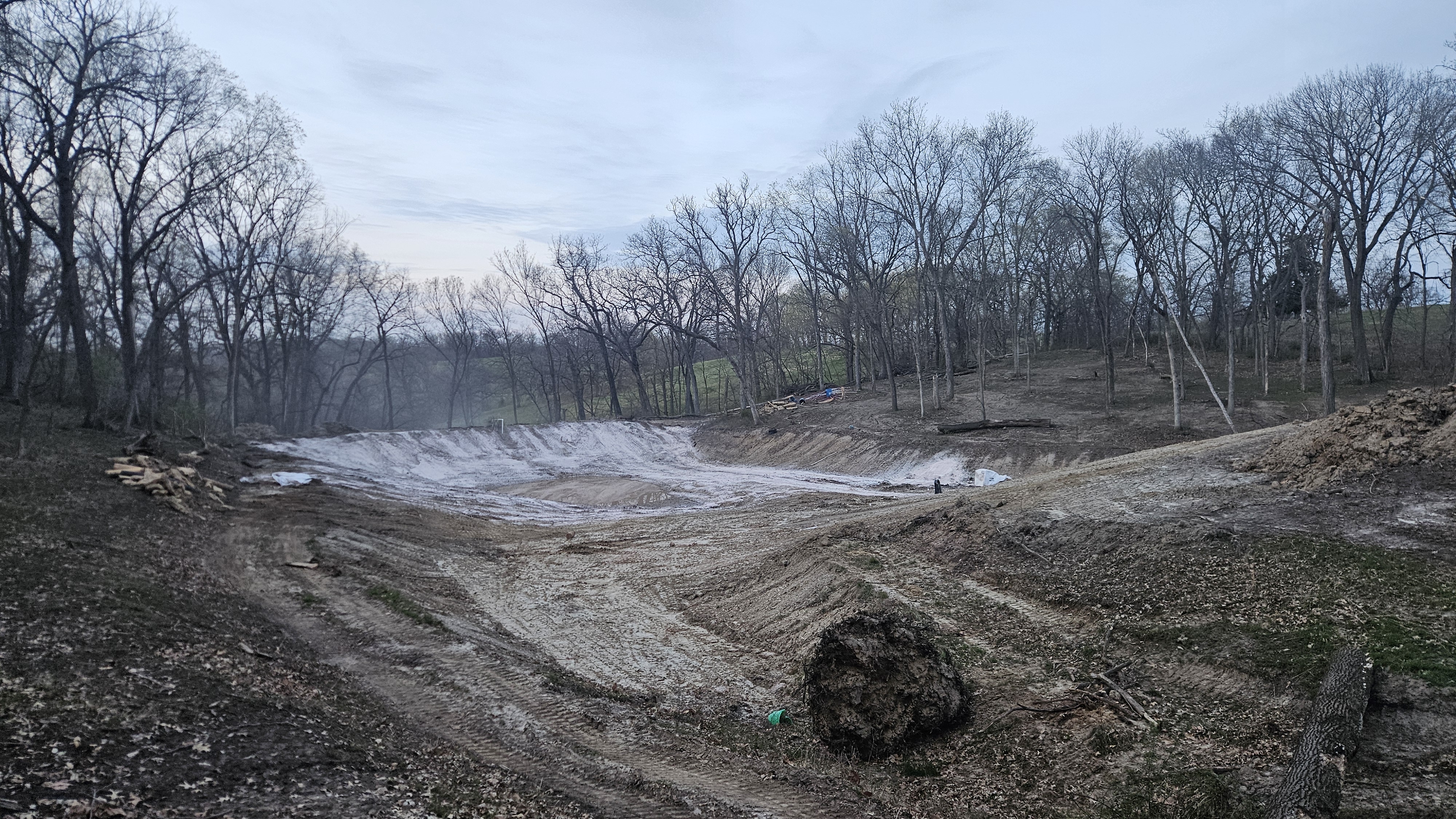

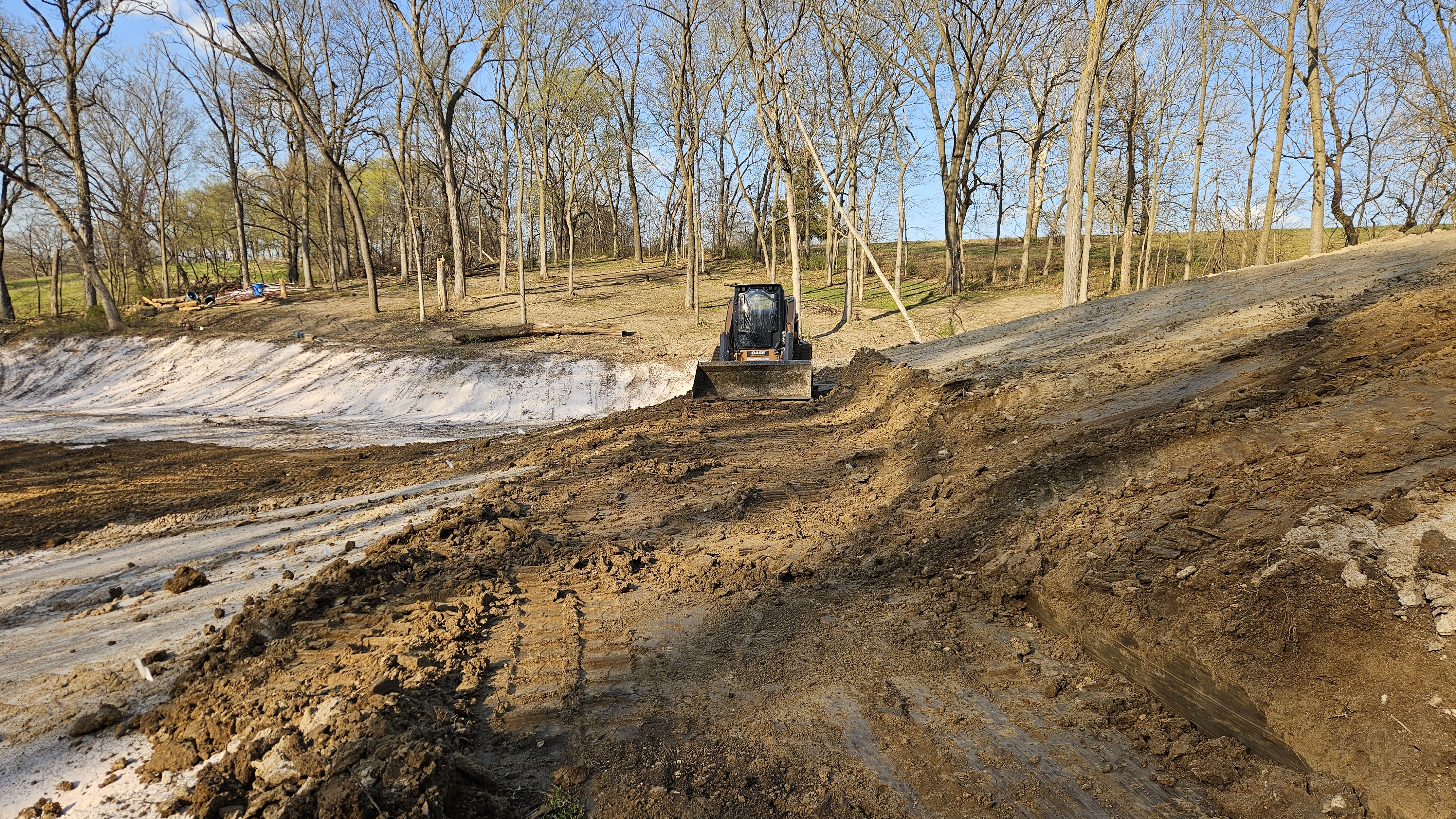

#1,258

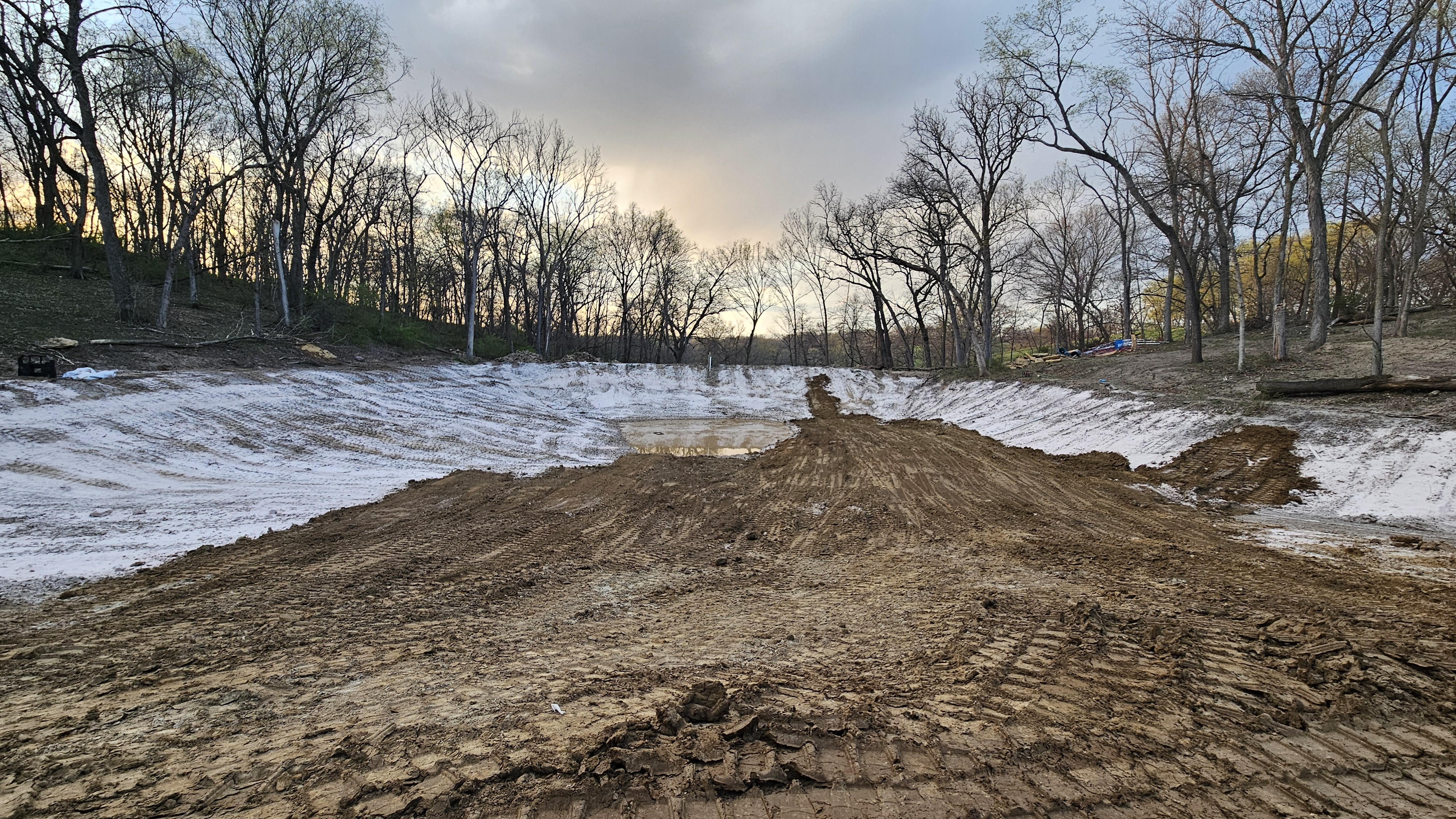

Bentonite is down. I have 1 bag to run at the area bottom of screen after I drag this huge stump out of the way. Going to drag it on top of the finished area. Started the cut in for a walk path today and covered up a good portion of the bentonite. Hopefully I'll have it finished up tomorrow other than compacting.

Thanks I do as well. A lot of time invested in this project overall if it doesn't work. The bentonite ended up being harder to spread than anticipated. Between broken straps and just uneven coverage with a 3000lb bag swinging from the forks I gave up that approach after 3 bags. I ended up just emptying on the ground and using the bucket to spread. This stuff is pretty messy as well. Almost like spreading flour. It's really fine. Even trying to work backwards and moving upwind I clogged my air filter by the time I was done. The reverser fan kept kicking on so I figured it was clogged. When I pulled it, it looked like a shop vac filter after sheet rock dust. The inner filter still looked good. I think I got the machine cleaned out pretty well with the leaf blower. The last thing I wanted was to leave any inside the engine bay and have moisture get to it. It gets really gummy and sticky when wet. Should be done today and compacting tomorrow. Need to wrap this up as I have a feeling my wife is currently biting her tongue giving the other things around here that should have priority.
