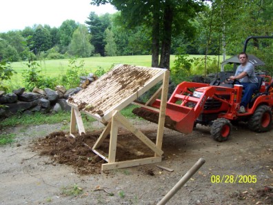

bx-23 ,
Even if it dont work,nothing better than the time spent with kids,what workers they are turning out to be

checking the height

haulong to test site

loam - oops ,dumped a little to quick.works good though

roots and rocks sorted,golden dirt

gravel screening with back hoe

Yes,i built it with intention,of possibly adding finer screens,Ill tell you guys something,THIS THING WORKS AWSOME !!!!!!!!!!!!!!!!!!!!!!!!!!!! i screened alot of loam,and gravel today.Once in awlile,i had to get off andpull off large grass root balls,put every thing else: sticks, rocks,stumps rolled right off Every two buckets id drive under and take away a load.Illtell you one thing,riser screws are tough.When shed start building up id bang the heck out off it with the bottem of my bucket,and shed unclogg itself,stayed on the seat most all day,never hurt it a bit.If i were to do over,i woulnt change a thing

I aint got a clue about the angle,i built it by eye ball construction company.The slats are 2by 4 kd spruce cut in half for the slats.2.2 inch riser screws,.I believe to have used about 15 2by 4 -8 fters on the hole thing.I STARTED SPACING THEM 2 INCHS,WHEN I GOT A few togeather we tested it,too many rocks that i wanted for ditch filling fell through,I took it apart and spaced them1and 3/8 and it was perfect.I 45ED THE SLATS SO THE DIRT WOULD FALL BETTER,leaving only a half inch flat spot. I F I WERE YOU GUYS, i would by economy grade,you have so many slats i dont think one would fail.( i work in a sawmill operation ,the job has its perks)The more wane the better if you get my drift.You should be able to build one for under 50 bucks easy.Also pick up 4 l brackets to stiffen the screen up.nOW IM NOT GONNA GIVE YOU THE HEIGHTS,that is gonna depend on your tractor,Do like i did and make it useable for your loader,and your hoe if you got one.Id keep it a foot shorter than max,for uneven ground,and you want room to...."twich it'
build one folks you will love it.I almost forgot,my 23 has a 4 ft bucket so i made it 5 ft wide ,so i can get in to scoop up the screened stuff.Its also high enough so you can put my atv cart on the other side to catch the screenings.I ADDED A 2BY 4 TO THE INSIDE SO I CAN DRIVE RIGHT in and pick it up and haul it off with no chain[after you build it you will see what i mean.]It is not so heavy you cant drag it by hand either.Thought about 2 by 6 constuction,but it would be exspensive,and over kill.One more thought:I see no reason i cant haul this over my fel on my trailer,it will probably go where BOTA goes

The front legs are 32,set in about 6 inchs,so the edge of my cart can be put underneath it,to catch it.
The rear legs are 53
The screen is about 4 ft long
I didnt have any "clods" except a few grass balls
When the screen clogged i banged it with the bottom of my bucket,and it would sift again.
I didnt have any dirt to speak of at the bottom,just grass,rocks,and roots.
This design was absolutely perfect for screening my gravel,and loam.Mabey my dirt isnt as heavy as others.
