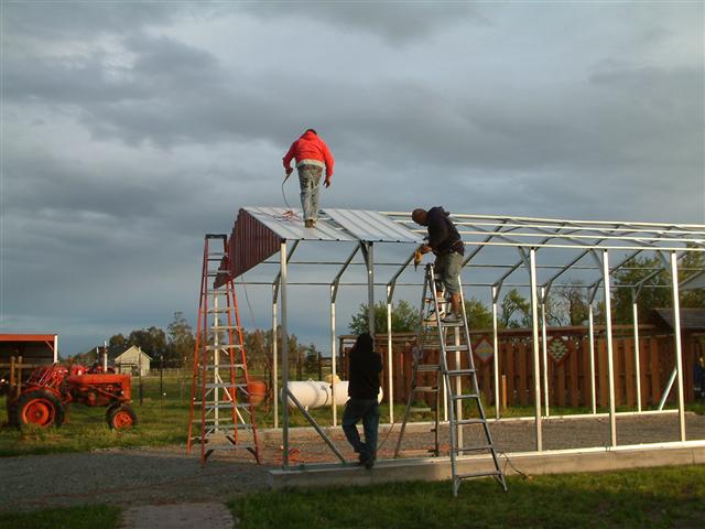

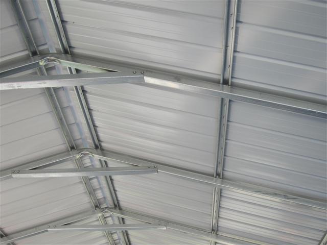

My 20x36 ft carport frame (9 ft walls) is built from 14 ga 2-1/4 x 2-1/4 inch steel tubing.
Don't know what's the size of the C purlins. You can estimate it from this photo.
In this county this type of carport has to be engineered. It's designed for 90 mph wind, 2 psf roof dead load, 30 psf roof live load, ground snow load 30 psf, seismic category D.
Good luck.

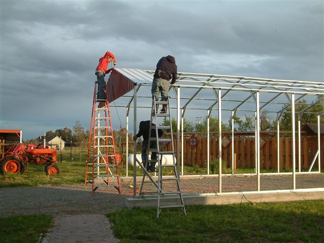

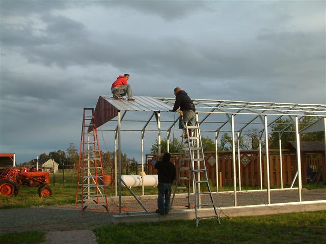

Just curious, once those boys got that end panel done. Was the rest of the roof installed from the ground?
/ building carport need help #9
Yes and no.
Hope you're shoulder is on the mend:thumbsup:

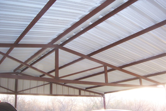

I took a picture of mine ... the poles are 4x4 metal with prefabed trusses set on the poles (welded together) and purlins on the rafters (welded to the rafters) and the metal screwed to the purlins ... no problems since 2004.
