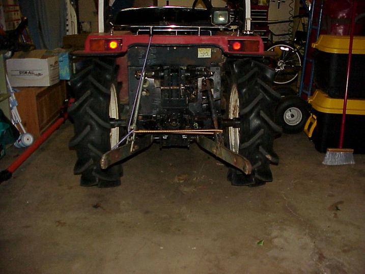

I am going to make a homemade boxblade. Has anyone made one and what are your suggestions. Also, if you made one and then after using it decided you should have done something different. All comments are appreciated.
Here is a photo of the tractor it will be used on

I made this outta some sheet steel I found along side of the road.
One of these days,I'm gonna cut loose the brackets holding the "wings" on and make them pivot to the rear so I can use it as a straight blade too.

Haven't made one yet but want to also. You can get box blade shanks at a reasonable cost shipped from Agri-supply.(they have a few different styles) I've seen plans for one somewhere also. Agri-supply
I plan on making mine 4' with 4 rippers and some scrap steel I have.

I built one out of 10" I-beams I had laying around, with a piece of 4x4 square across the front/top which I welded 3x3x3/8" angle iron as uprights for the top link. Didn't have any problems with the build, just a little welding.
The bottom flange of the I-beam is sometimes a problem but it is great for some projects so I leave it on.
