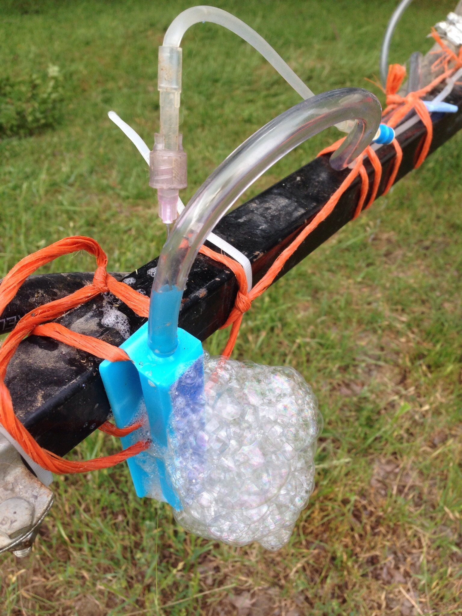

I just figured out how to make a foam marker system under $30: I used a large 4" aquarium bubble stone powered by an 12V air mattress inflator. I then filled an old hospital IV bag with foam solution and hung it from the tractor's roll bar. The trick was to use the IV needle to inject the solution into the air hose just before the air stone so the air pressure pushes the solution through the stone and makes copious amounts of foam on its way out. I was going to put the stone in a container to hold and shape the foam but found out that it was not necessary so I just tied the stone to the boom keeping it vertical so the air and the fluid flows from the top down. I found out (the hard way) that you must wrap the IV bag to the roll bag with duct tape, or the whole thing will go flying away at the first hard bump!
I purchased the 12V inflator ($8), some air hose and the 4" air stone($2) at Walmart. The IV bag was left over after giving my cat some fluids. I use commercial foam fluid because it lasts longer but dish soap might work too.
After adjusting the fluid rate, I get a 1" foam blob every 10'-15'. Very easy to see even on a field of 1' high vegetation.

Thanks, I tried to make the foam marker with the bubbling tank approach as described in the earliest posts but found out that the long tube (from the tank to the tip of the boom) really slows down the flow of the foam. I used the cheapest large tube that I could find, a vacuum extension, but I think the corrugations on the tube increase the laminar friction too much. I was getting one blob every minute or more.
I then setup to make the foam at the tip of the boom, I tried several approaches using a 3D printer to make the custom parts. After many tries I discovered that injecting the solution into the air supply uses the force of the air pressure to move the solution through the stone, which does not do if the fluid is simply dropped on top. The size of the bubbles is proportional to the air pressure and the mix ratio, too much air makes the foam bubbles too large. Too much fluid keeps the foam from forming properly and makes it runny.
The IV tubbing is very flimsy, I don't expect it to last more than a couple of weeks. I'll be looking for other ways to hold and supply the liquid. I will also look into using a more conventional 'T' coupler to inject the fluid but worry that I'll have trouble adjusting the flow. Takes very little solution to make the foam and the flow needs to have a fairly fine adjustment. There is not a lot of difference between too little and too much.

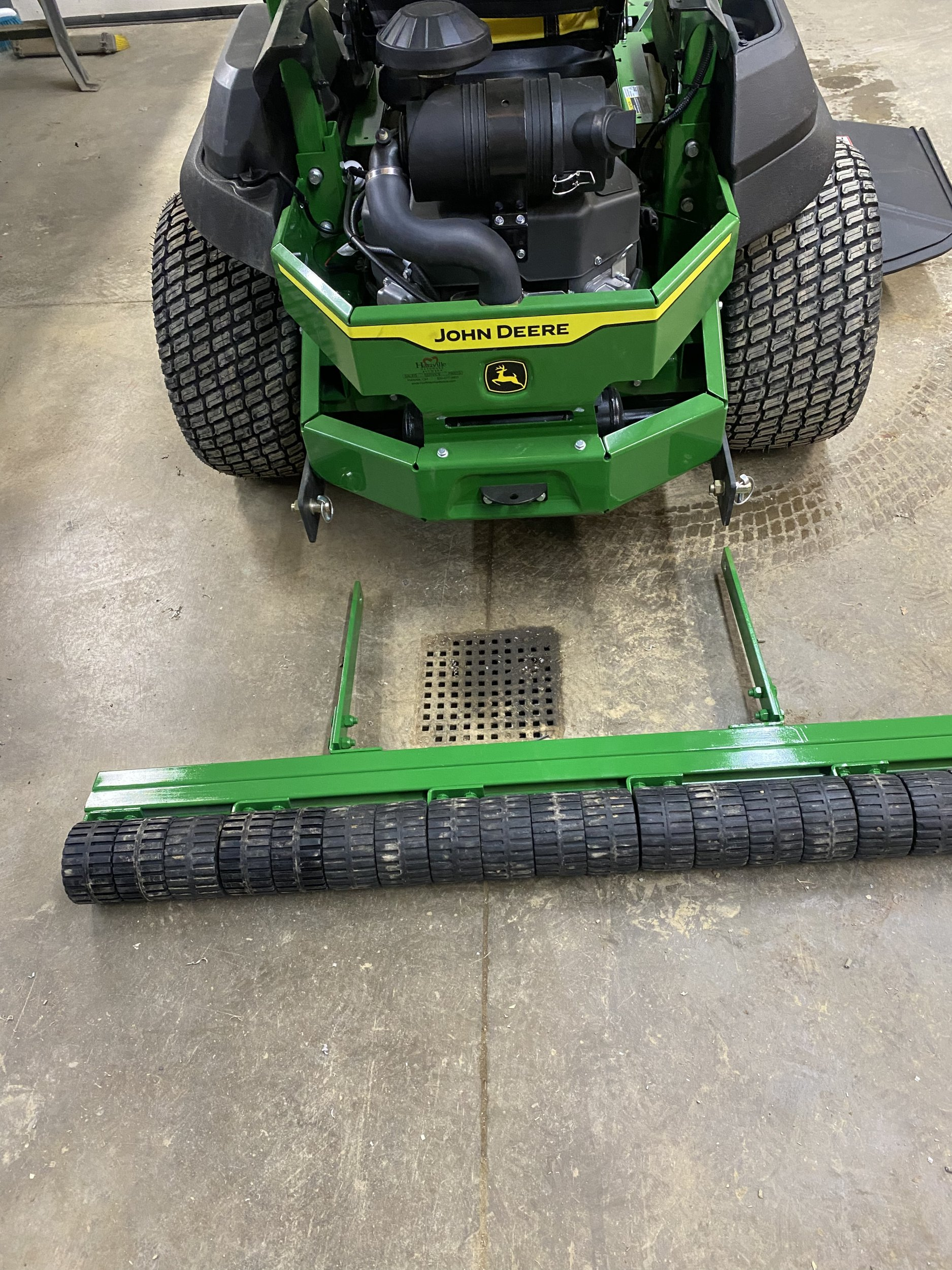

I ended up using a 5-gallon plastic carboy. Purchased a 12 volt aquarium air pump and connected a large air stone to it and dropped it in the carboy. When the pump is activated it generates foam that is then pumped through a short length of 2” PVC pipe that is stuffed with stainless steel wool. The resulting shaving cream consistency foam is then piped to the ends of my spray boom. It’s pretty simple and works really well.
BTW The Z655 has been sold and was replaced with a Z740R. Wish it would quit snowing so I can try it.
