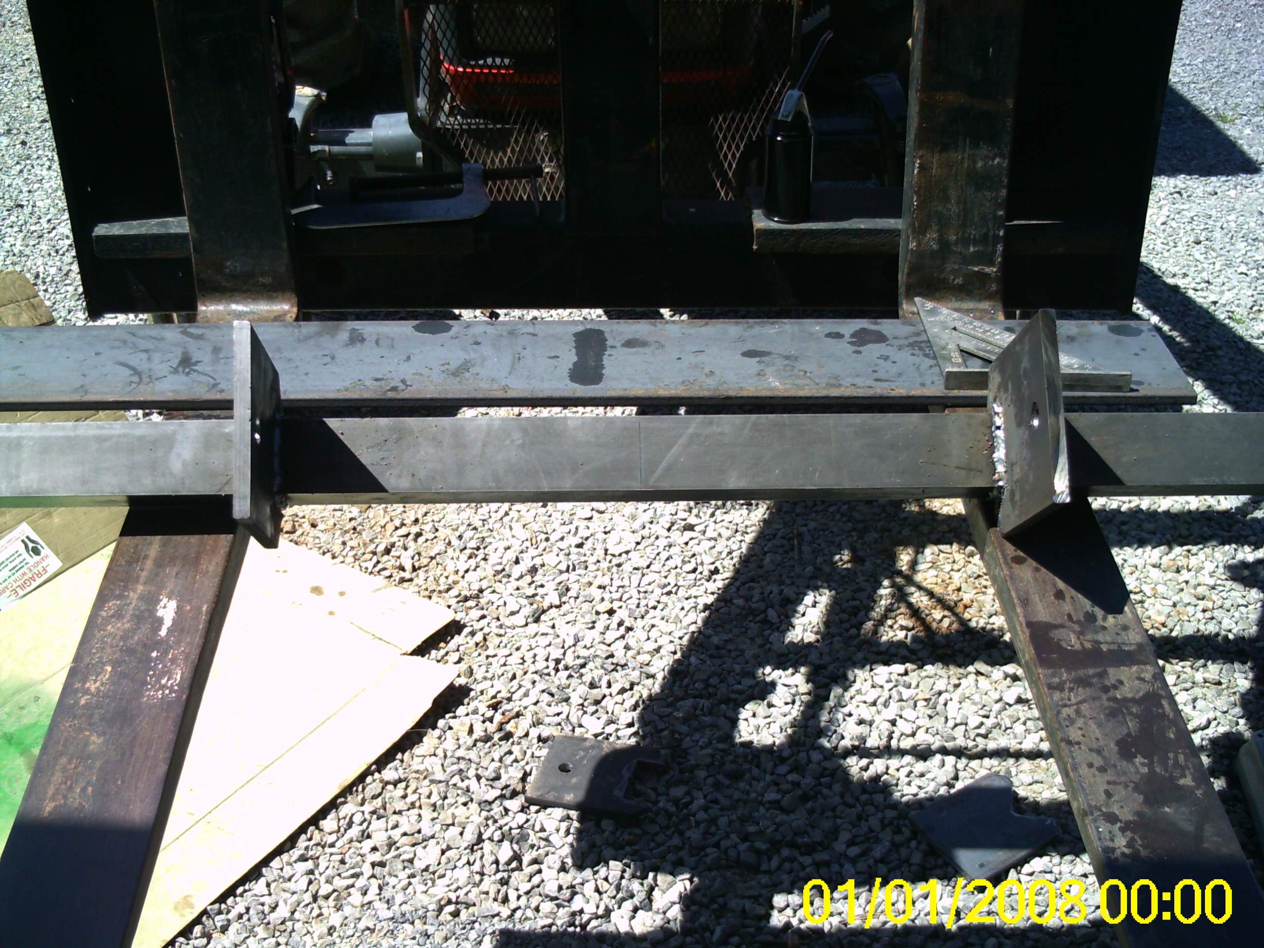

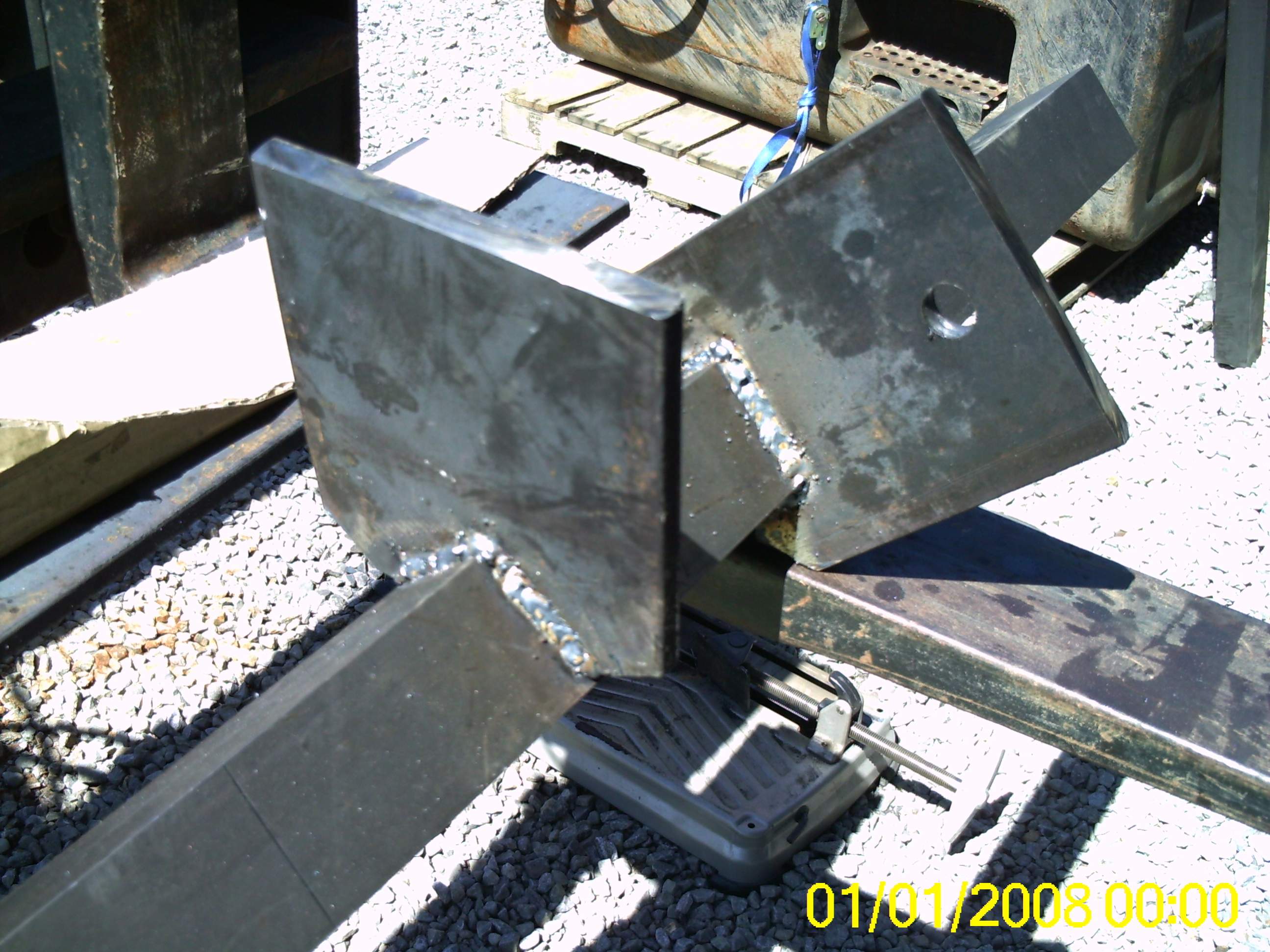

Back during the winter I bought a couple JD 71 Flex Planters. They did not come with a toolbar.

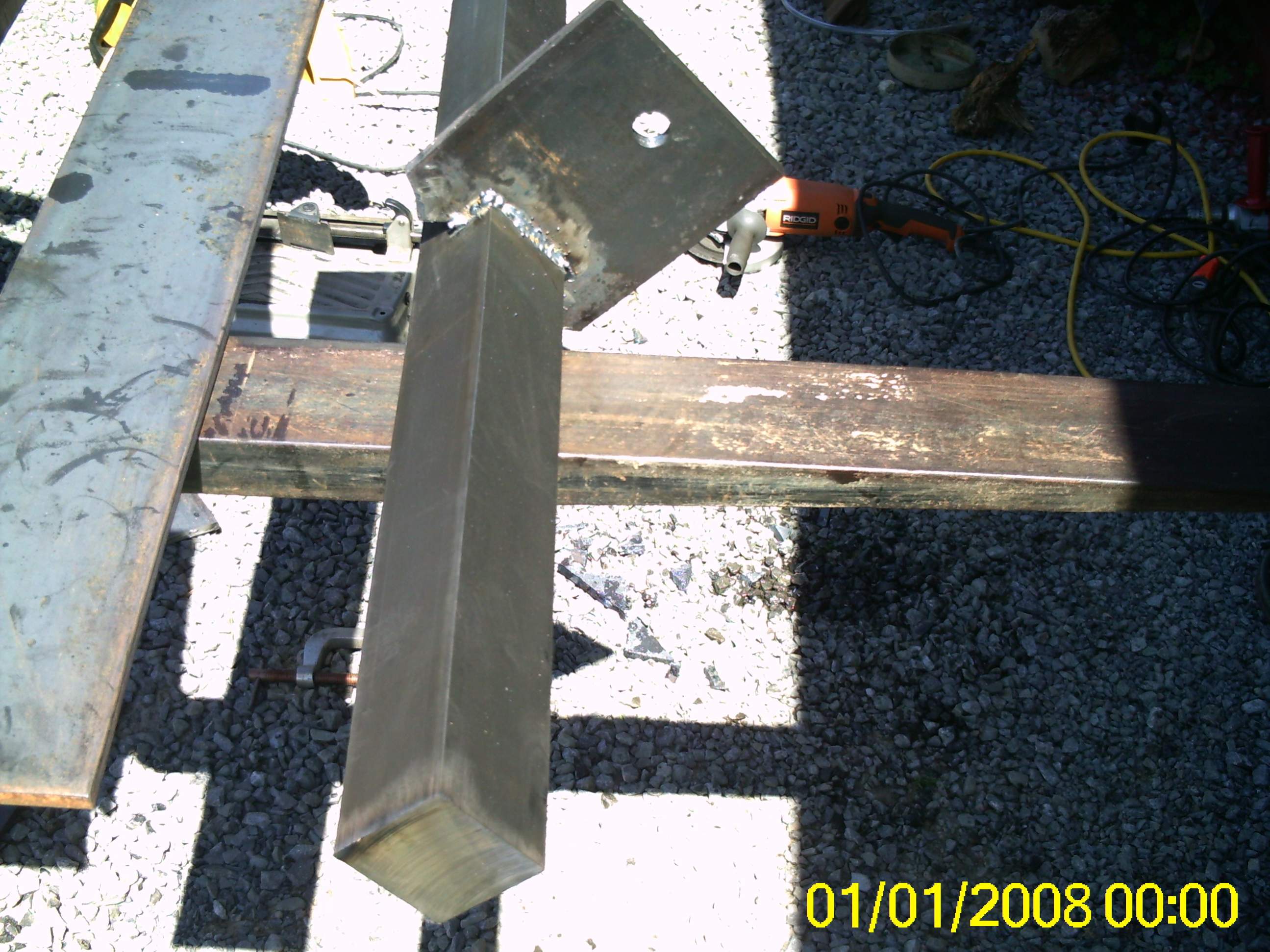

I found a used toolbar and bought it from another farmer. The problem is the mounts for the 3pt hitch were exactly at 30". I wanted to mount my planters at 30", but settled on mounting them outside the 3pt mounts. This gave me 36" rows. The problem is the planter was almost planting in my tire tracks (tractor set up on 60" centers).
I decided to build my own toolbar. I called a local steel supplier and order a 6' piece of 2 1/2" (1/4" wall) square tubing. I went to pick it up on Friday and they didn't even have 2 1/2" square tubing in the thickness. I had already paid and after grumbling about driving 50 miles the "guy in the back" told me he had a piece of 2 1/2" cold rolled bar he would give me if I didn't "tell the boss". Well we loaded it up and I was on my way. I also purchased a piece of 1/2" x 6" flat and a piece of 1/2" x 4" flat. $81.00 later I was on my way.

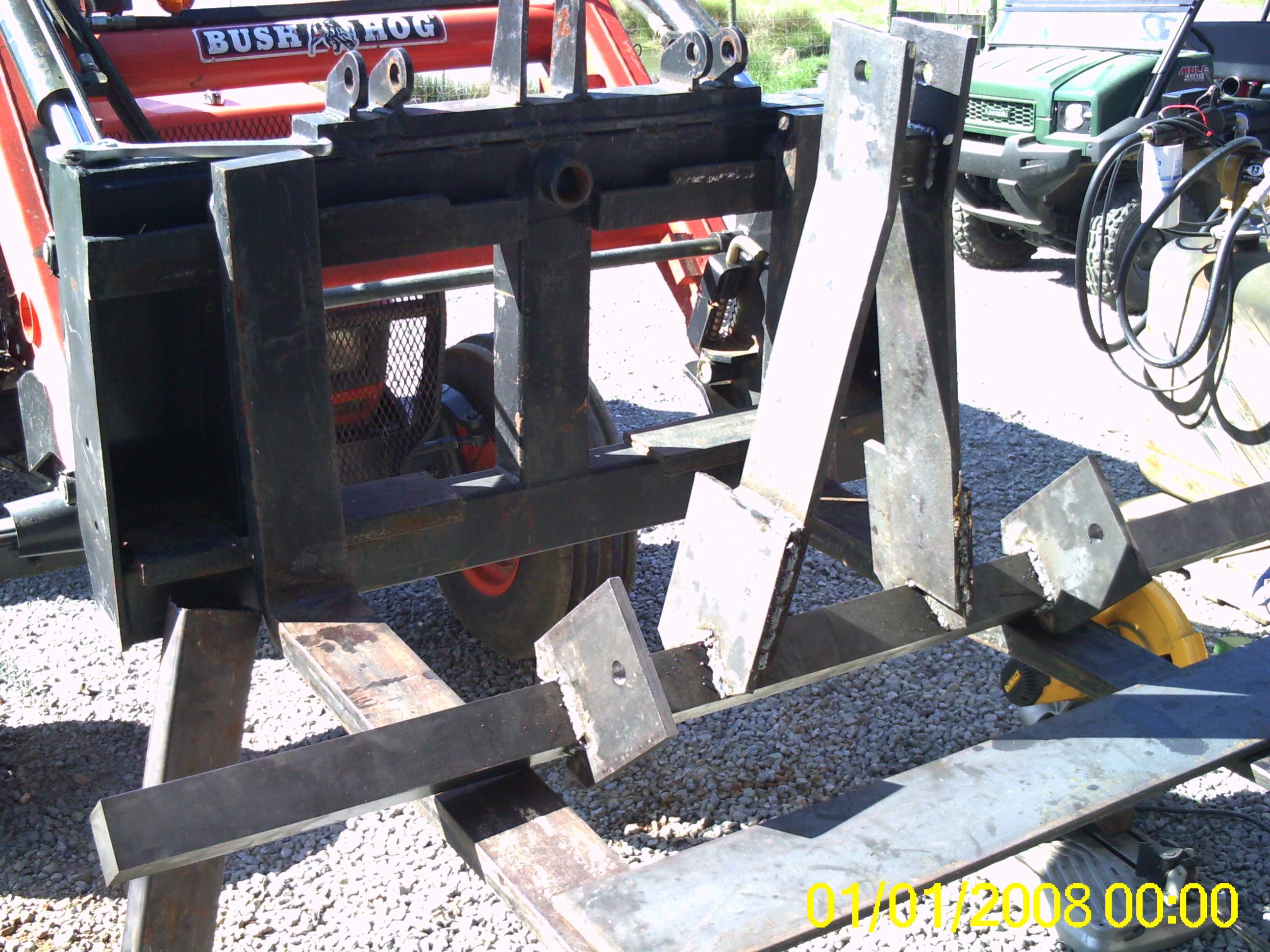

I copied the tollbar that I had purchased (Massey), but made it a lot stronger and so that I could mount my planters on 30" centers or wider and I also can mount one on the center of the toolbar and plant on 60" centers.

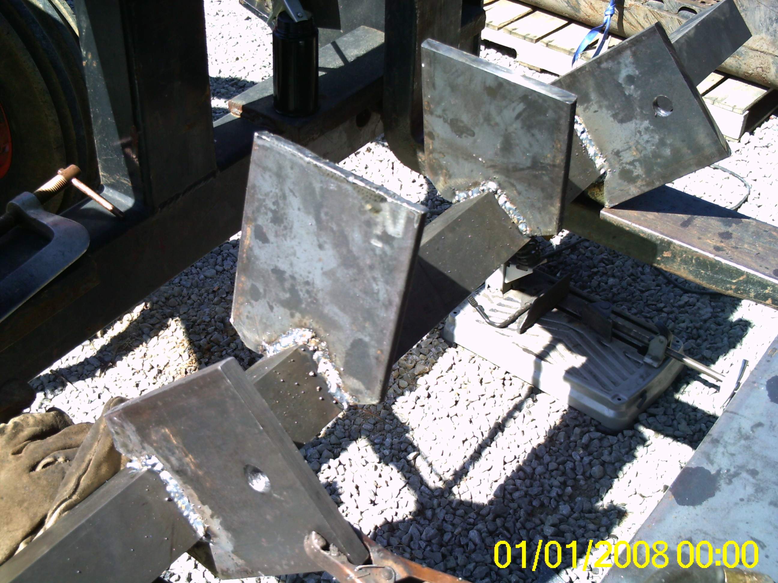

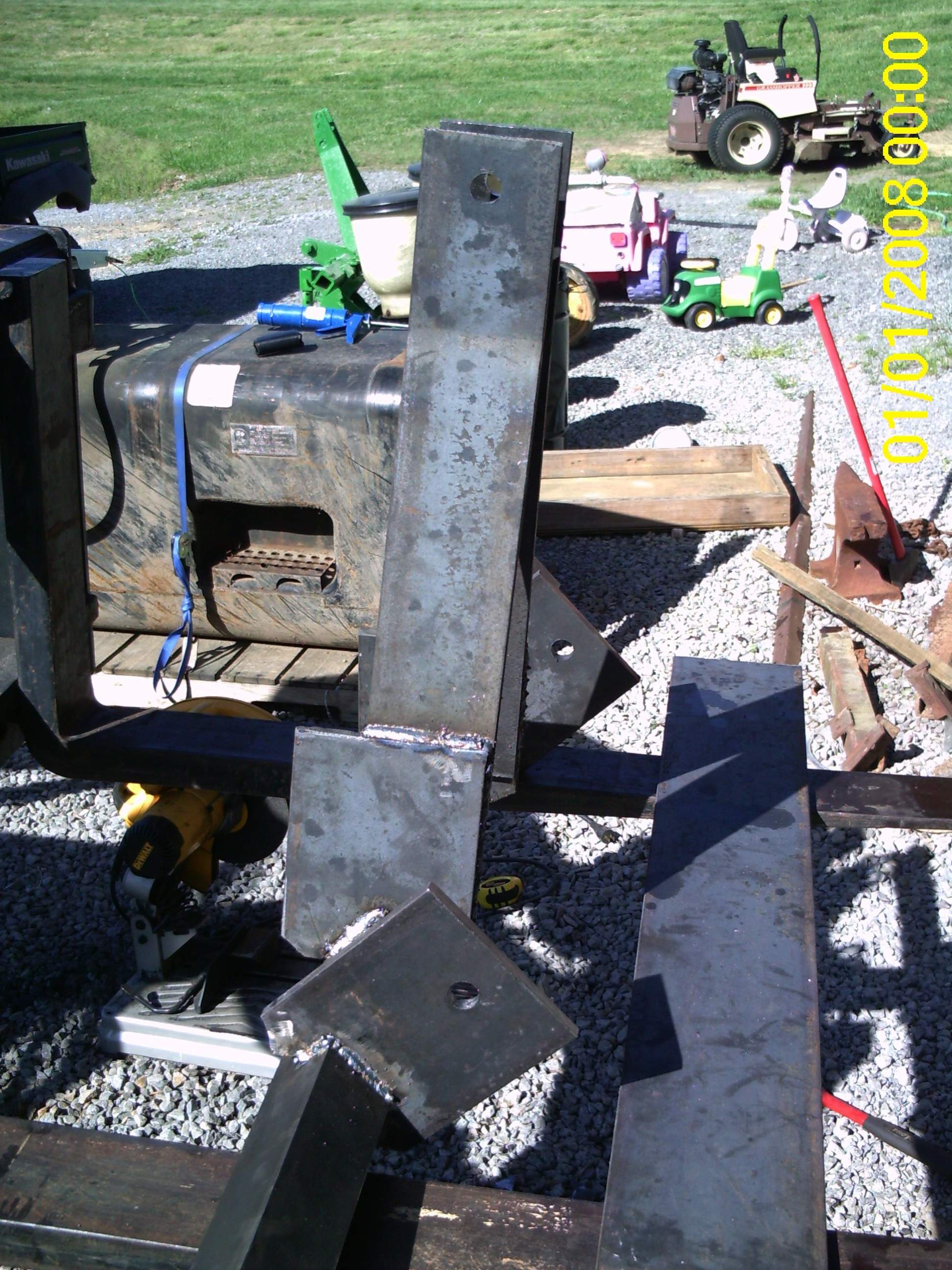

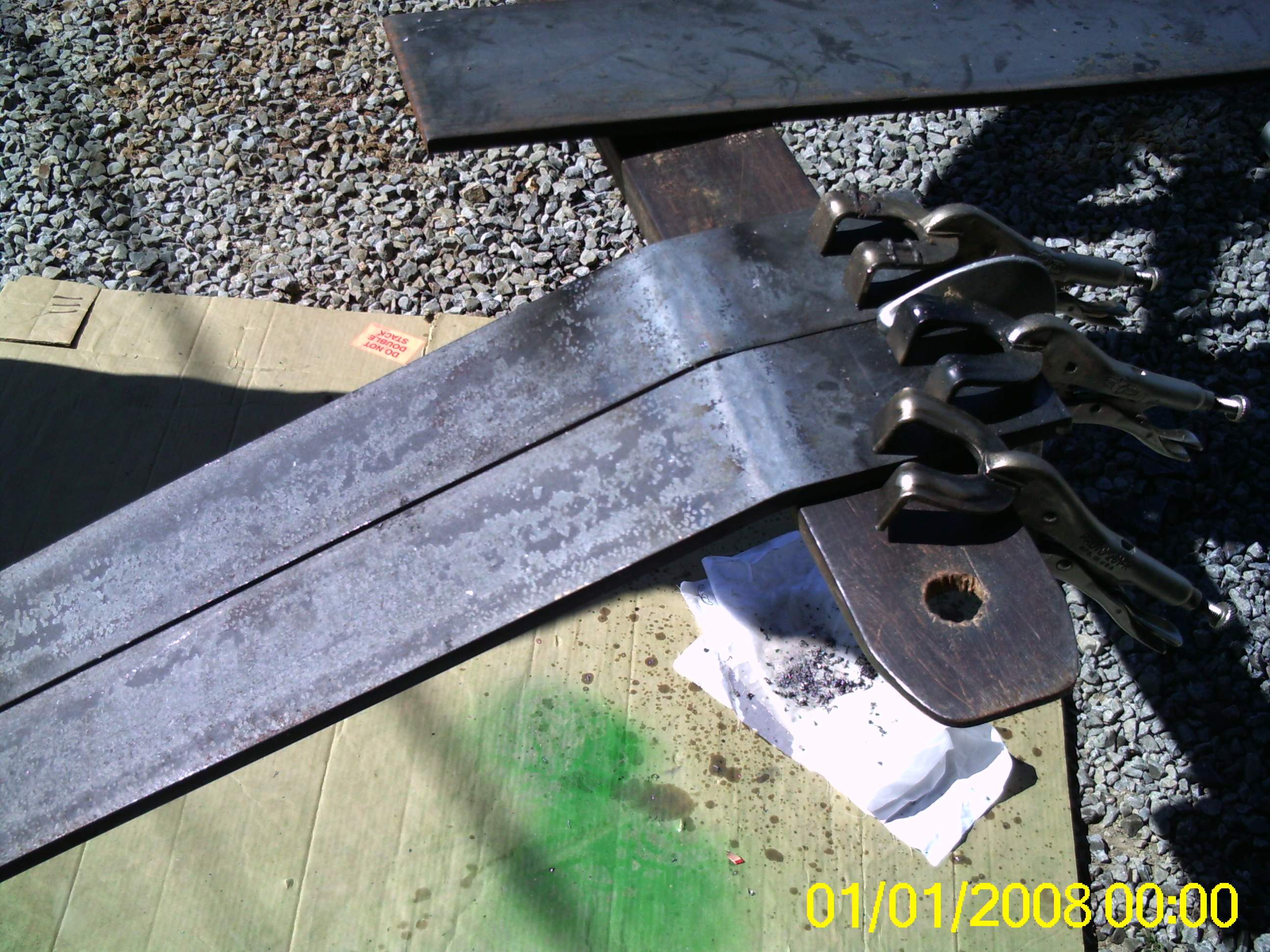

The first picture shows how I notched the 1/2" x 6" and welded it to the bar stock. The fifth picture show how we bent the uprights for the top link mount. The last two pictures are of the finished toolbar minus paint.

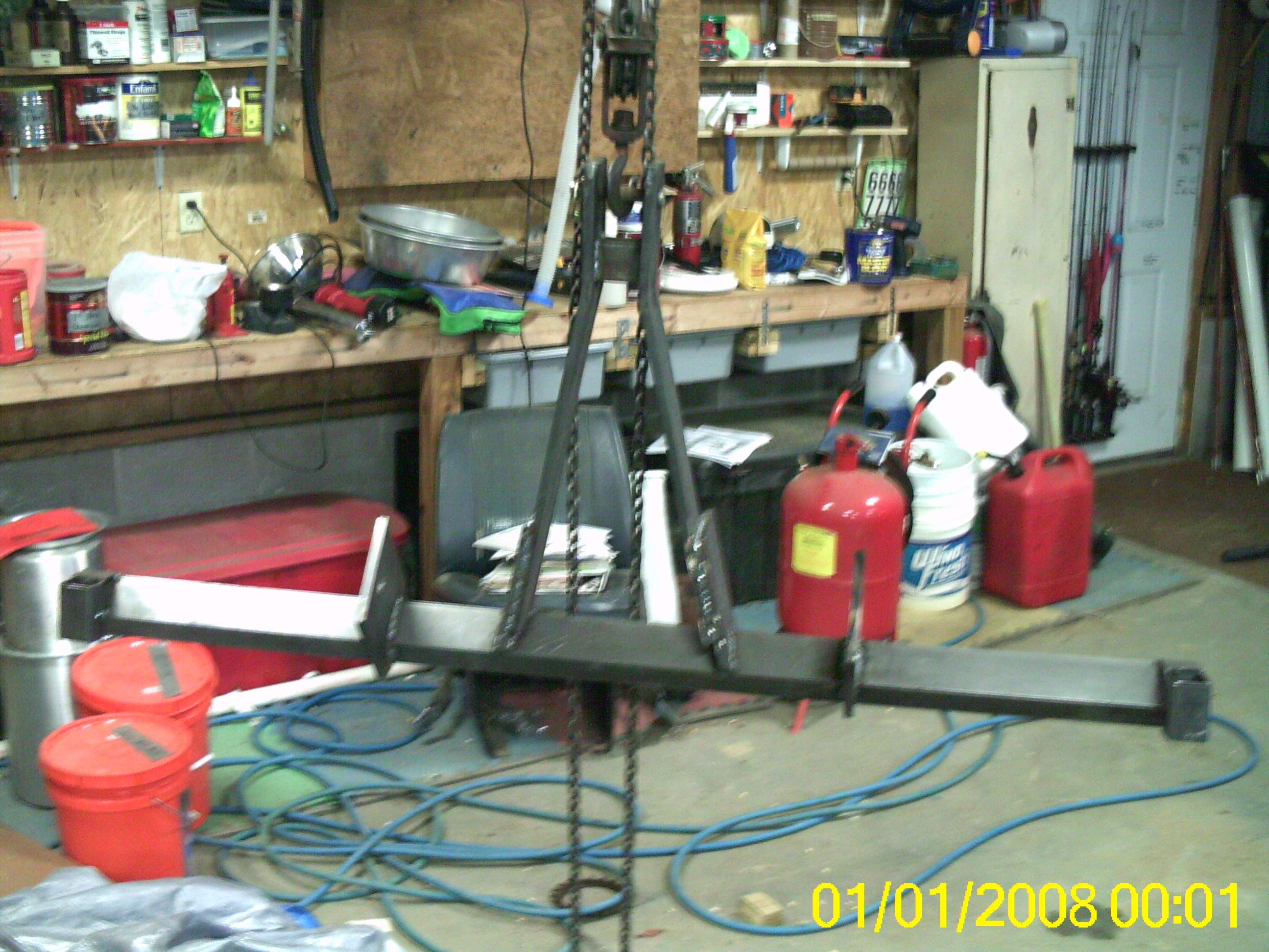

I primed it last night, but the pictures I took are kinda blurry. I will post more pictures after I paint it JD Green.

Materials List:
2 1/2" square bar -- 60" long
1/2" x 4" flat -- 60" long
1/2" x 6" flat -- 60" long
Cut 4 pieces of 1/2" x 6" x 6" long. I drilled holes with a 7/8" drill bit for the category 1 pins. I first drilled the holes 1/4" then 7/8". The measurements for the holes were 1 1/2" from the end and centered.
I then notched 2 of the pieces with a 2 1/2" x 2" square notch. I mounted these two pieces to the square bar 12 1/2" from center.
I then notched 2 of the pieces with a diamond notch. The are the reinforcement plantes for the top link mount.
I then cut 2 pieces of 1/2" x 4" x 24" flat. I drilled 7/8" holes 1 1/2" and centered from one end. I then took the same end and marked it at 6". I clamped the pieces to the forks on my loader and began to heat them. My neighbor (Jim) preceeded to sit on the other end of the 24" piece as it bent slowly. When we got it bent to our liking (I'll measure for you) we stopped. We then clamped the other piece of 1/2"x4"x24" to the fork beside the first. This way we could get our bends the same.
I used a piece of 2"x2" square tubing cut 2 1/4" long to space between the top of the top link mount.
I used 2 pieces of 2"x2" square tubing 3" long for stand mounts. Notice them on each end of the toolbar. I"ll get better pictures tonight. I took a chain link fence post and cut it in half and welded a piece of 2" x 1/8" flat to the bottom for stands. Drilled holes at the top and bottom.
It took about 4 hours to build.
I'll post one of the pictures from priming the toolbar. Notice I have it suspended from the ceiling with a chain hoist. It is too heavy to pick up by hand.
BTW: That 7/8" bit cost me $35.00 at the local hardware store. I like aprox. 50 miles from Harbor Freight so I had to buy locally. :thumbdown:
