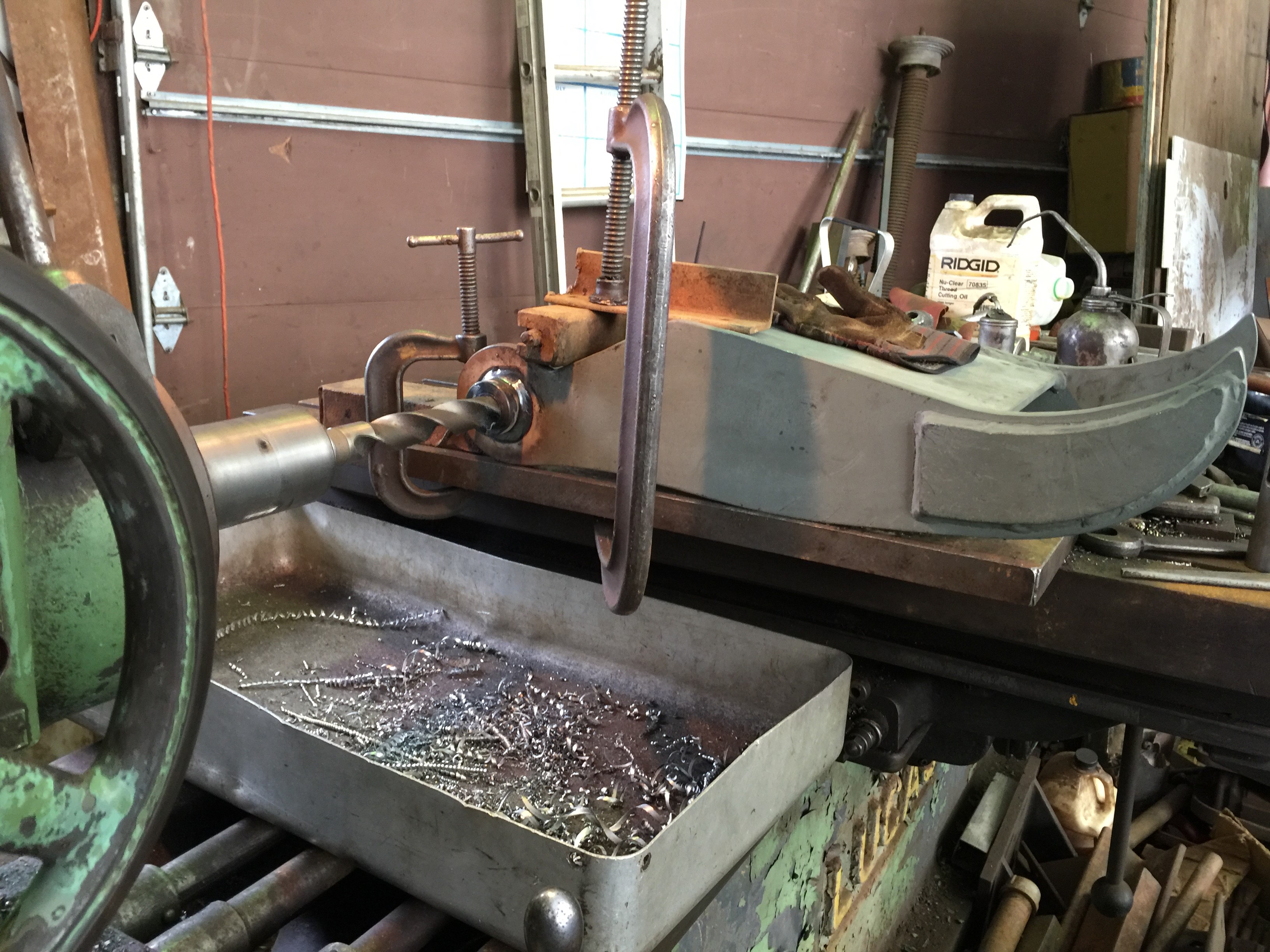

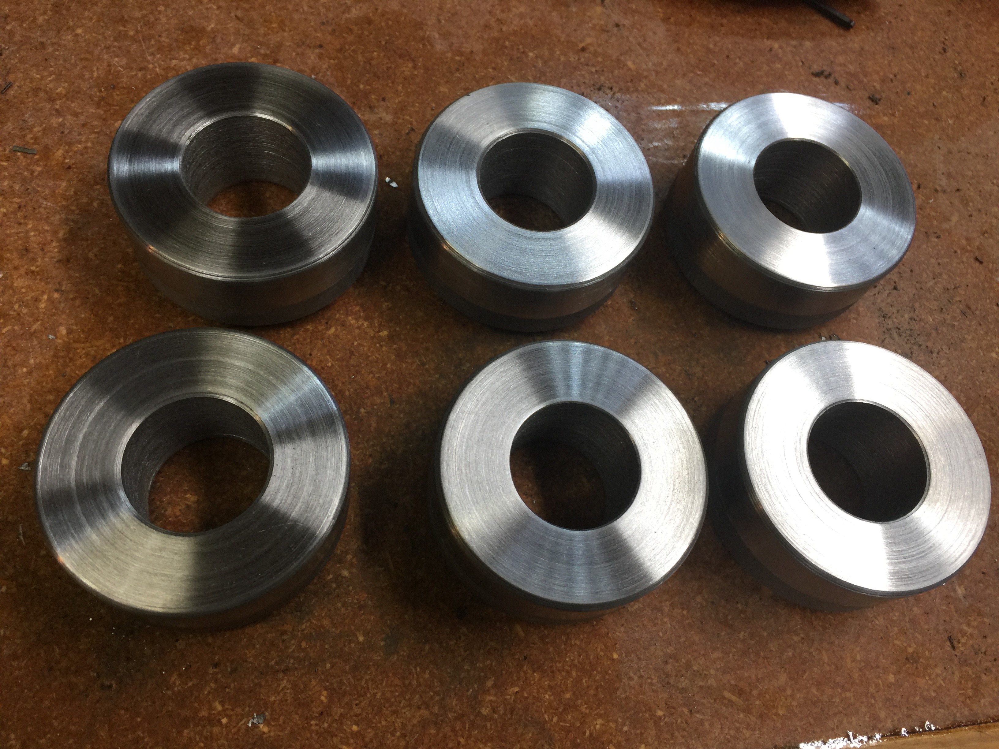

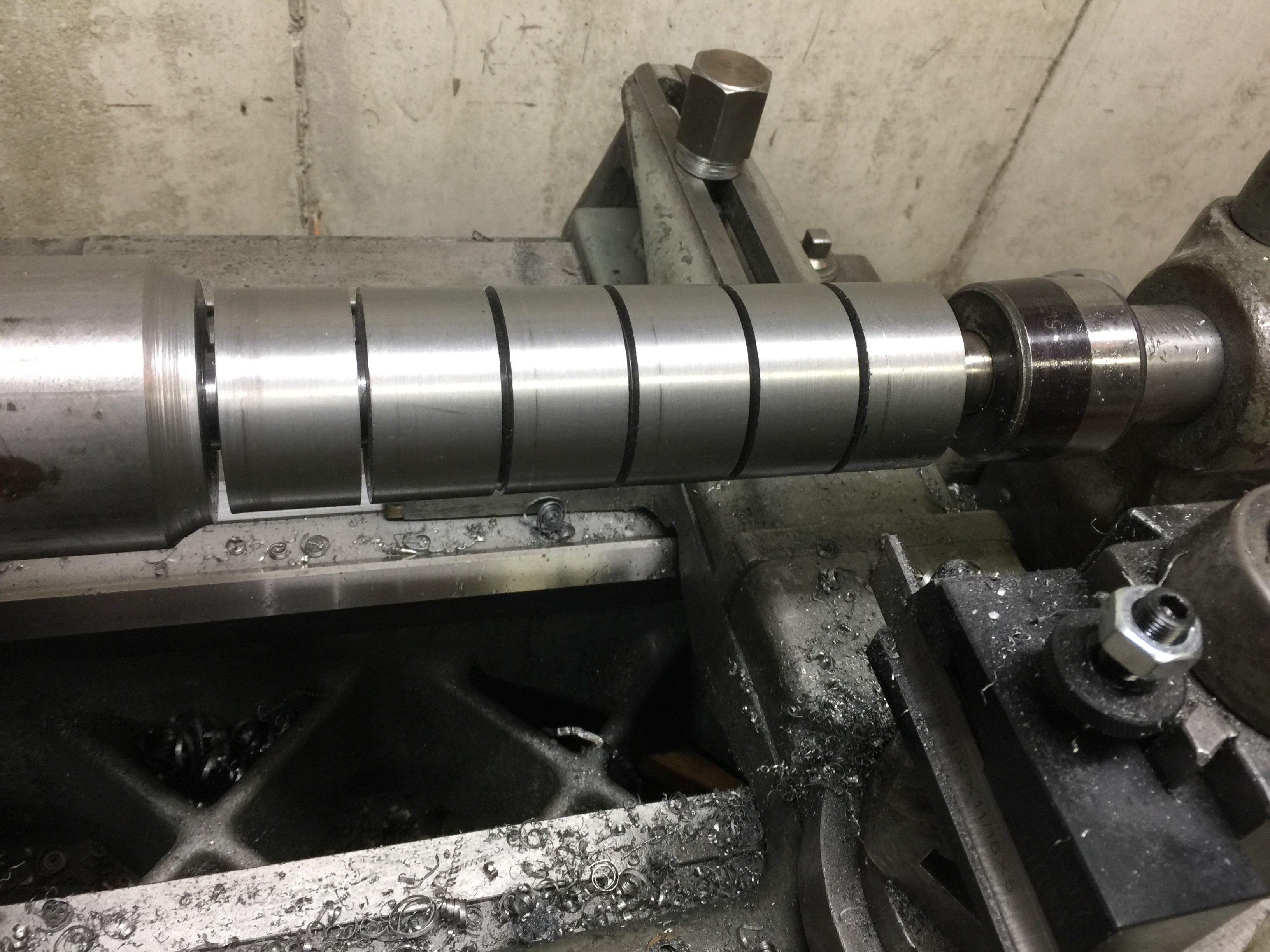

I have finally been able to get back to work on the backhoe thumb. I used this project as an excuse to go out an buy a decent lathe. I ended up with a South Bend 13"x36" machine that reportedly lived in a VoTech school. Here are the bosses for the thumb pivot right before being cut apart, and then after drilling a pilot hole.

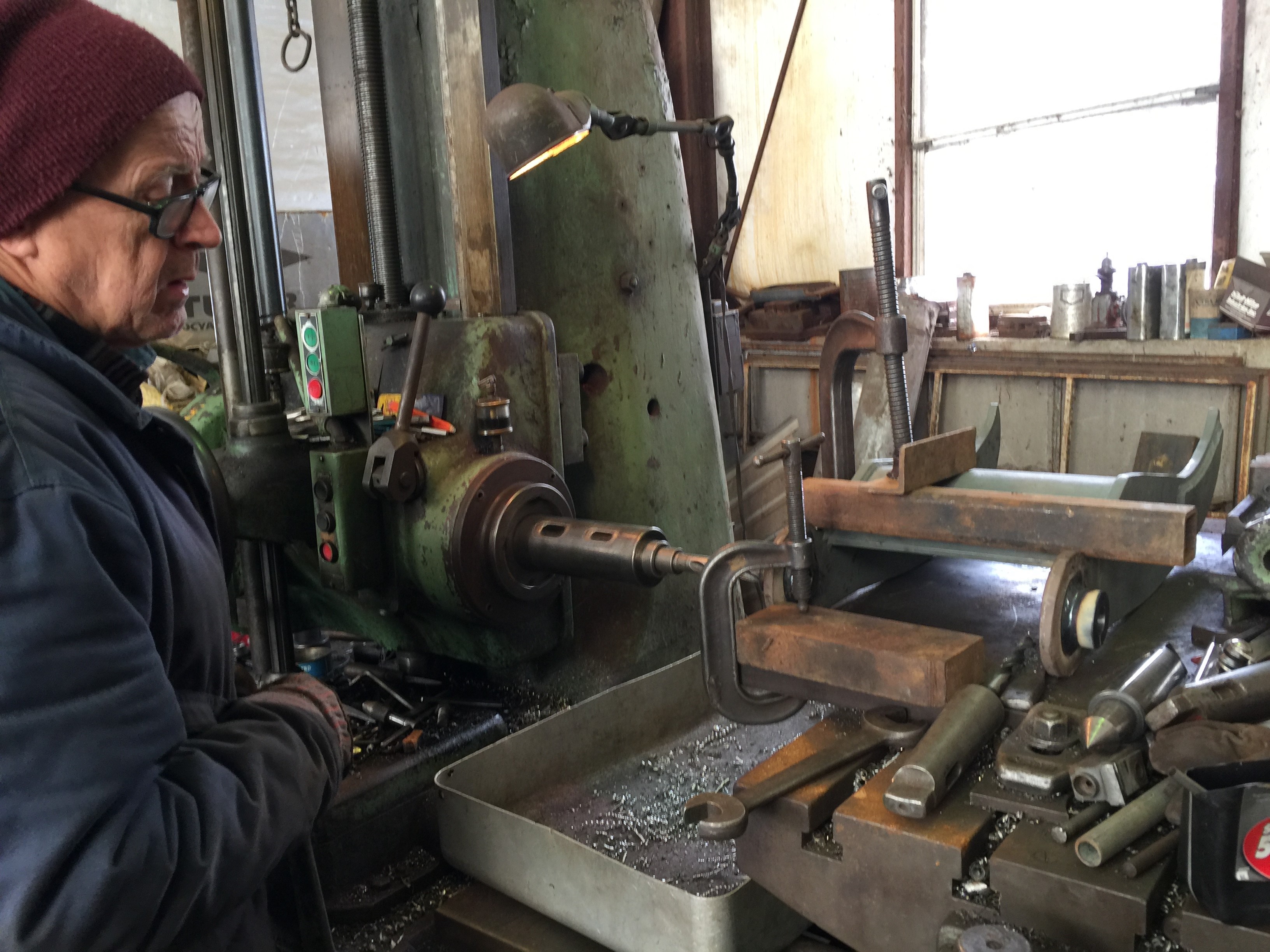

Over the weekend I took it over to a good machinist friend. He has much bigger machines and a better welder, so he welded the bosses onto the thumb and bored the pivot hole. This is a large Lucas horizontal mill.

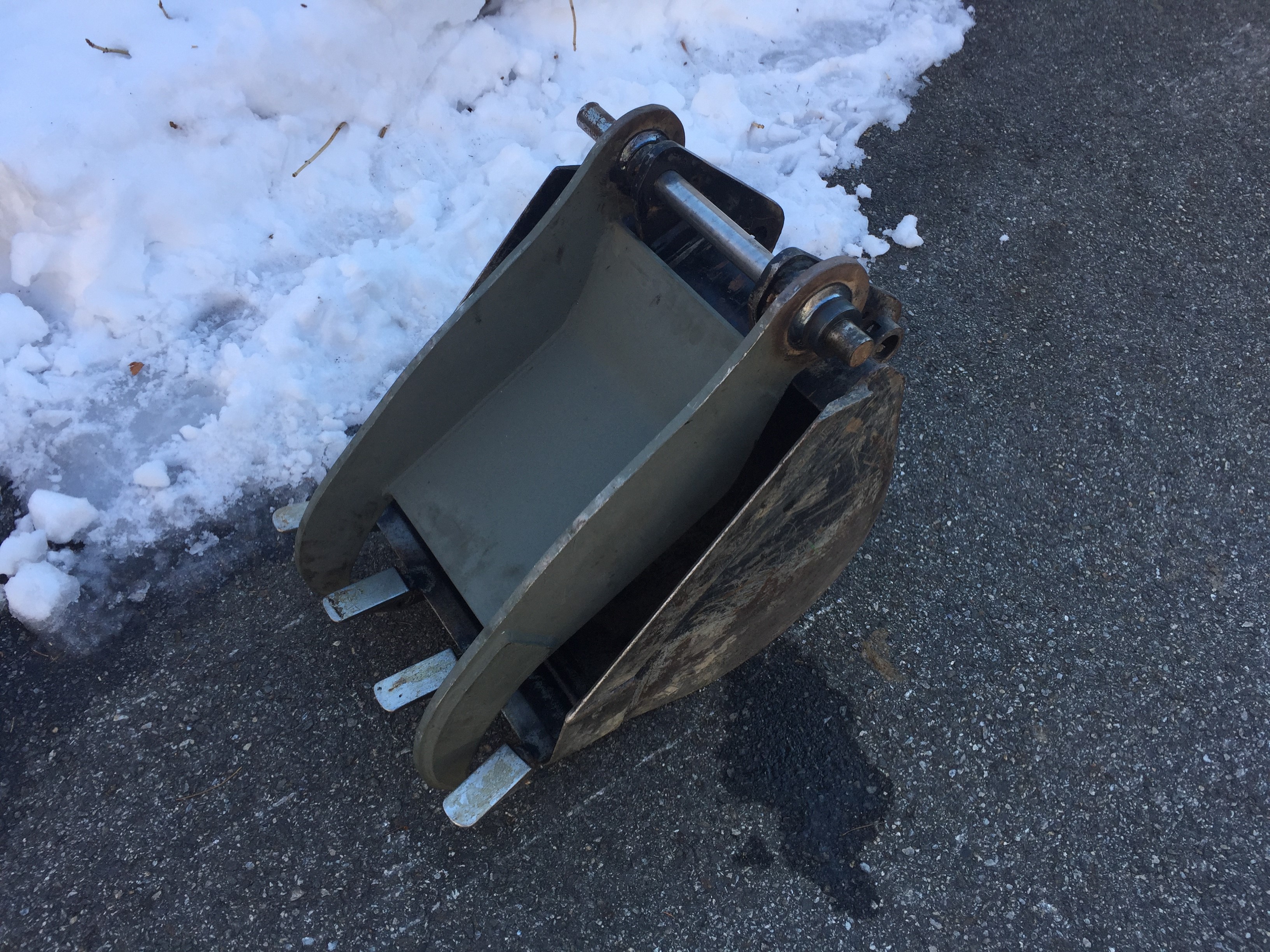

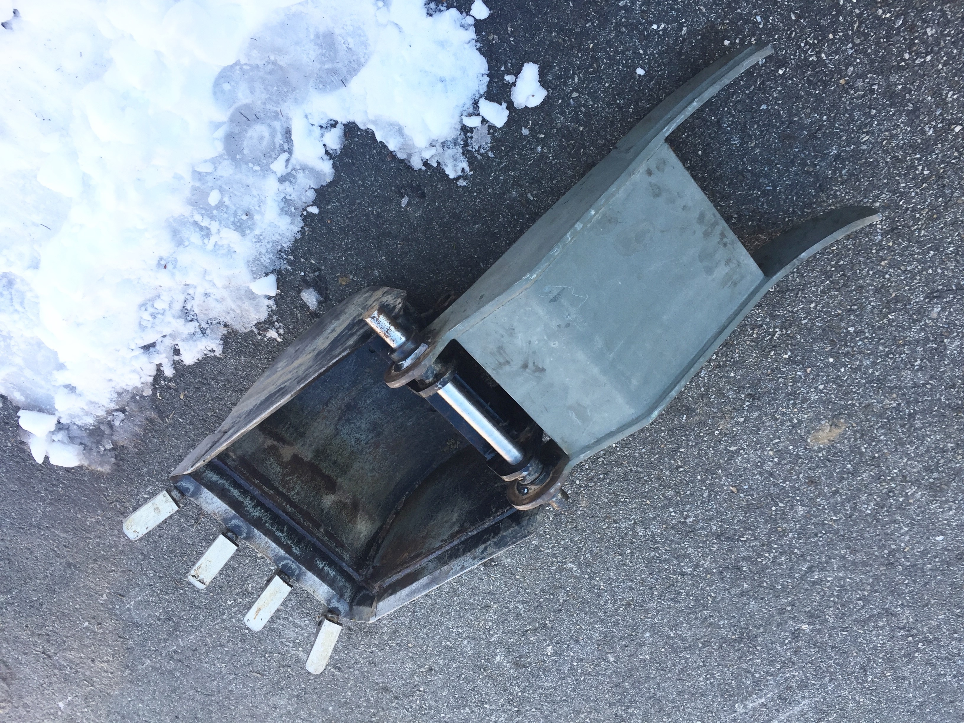

Backhoe bucket now with the thumb attached at the pivot. I'm very happy with this.
As for hydraulics, I think it will be easiest and cleanest to use a double-acting electric hydraulic pump. Then I don't have to cut into any existing hydraulic lines and I don't run the risk of slowing down the flow to the backhoe, and a whole slew of other issues.
