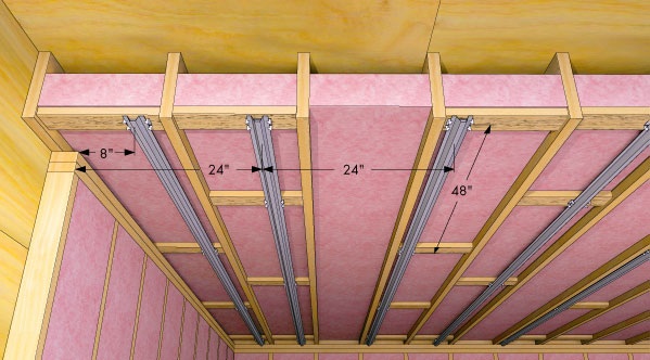

Builder, does that rc1 stuff look like this?

Oh, so that's what you meant by floating, eh? Only one SIDE is not screwed to the truss. Do you think this system could be attached over present Sheetrock ceiling? I have that ridiculous "popcorn" mess, and I want to make my ceilings all smooth.
Only one side is screwed as it only has one leg to screw in.
If you are looking to cover up your popcorn you can just apply another layer of 1/2" drywall right over your existing ceiling. You do not need to install the channel. You can also dampen your popcorn with a light mist of water from a bug sprayer, Let the water soak in alittle and follow with a scraper. Scraper can be from 6" to 12" wide. It makes one **** of a mess doing this so the whole room needs to be covered with plastic. It will take you alittle time to figure out the amount of water you need to apply along with the amount of time to let the water soak in before trying to scrape. Once you figure that out it should go pretty well.
So to answer your question NO you do not need to install channel if you are looking to cover your existing ceiling.
