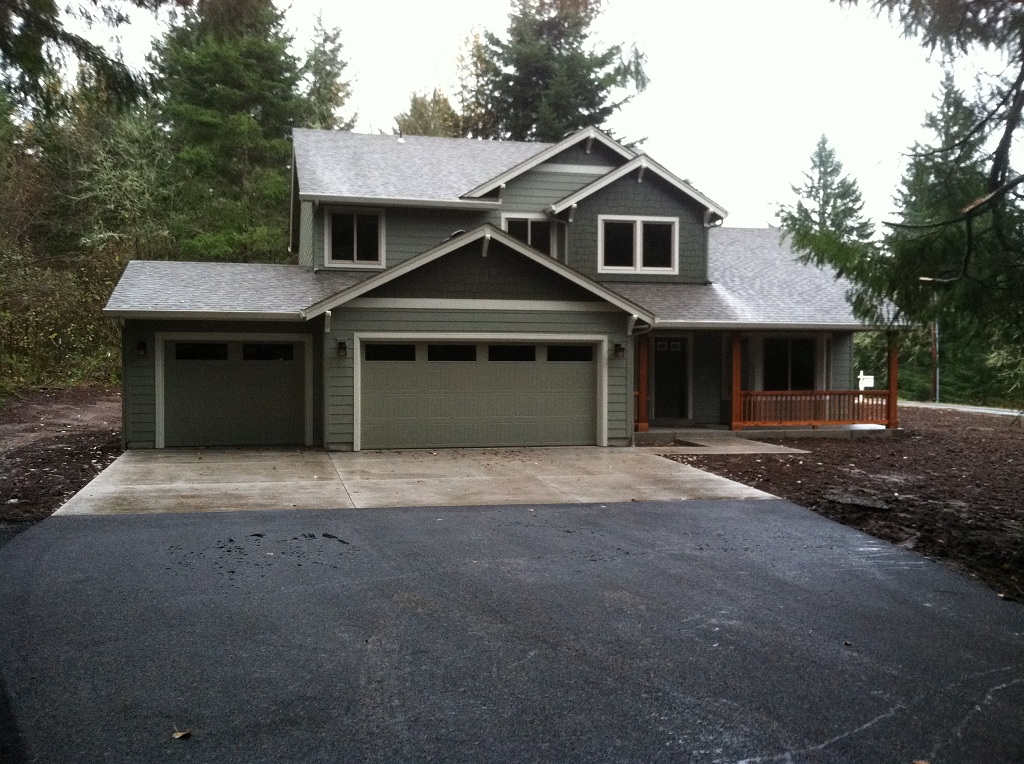

Pclausen - they finished construction on my new house here in Battle Ground, WA 4 months ago if you want some numbers to compare to.
My House - $295,500 on a 1 acre lot. Price includes 2,100 sqft 2 story, 3 beds, 2.5 baths, plus office and loft, 3 car garage, covered front/rear porch, electric furnace plus heat pump, 2 tank septic system w/electric pump and alarm e.g. not gravity fed, 20 feet of swept concrete driveway pad x 3 car wide, aprox 140ft of paved blacktop driveway from the road in to the concrete pad, concrete sidewalk, front porch, rear patio. Hardiplank siding, 30 year comp roof, plus my upgrades listed below.
Note - I do not have a basement or fireplace, also this was a spec home about 30% complete when I purchased it so the builder financed the construction e.g. they look to make more profit vs when the purchaser obtains the construction loan.
Garage - Your 2nd car sounds a bit high at $7,600, my builders price for adding a 3rd car garage is $5,500.
Vaulted Ceiling - my builders price $1,500 per room in sheet rock, I see you are going with stained T&G pine so the added labor and materials for yours sounds about right, they sheet rock VERY fast.
Fireplace - my builder charges $3,800 for a gas fireplace so your wood burning sounds reasonable.
Plumbing/Lighting - Watch this area closely, my builders 'standard' lighting and plumbing fixture allowance were way low, bascially the cheapest China fixtures available so upgrades added up fast. My lighting allowance was $1,200 for like 28 fixtures, that's less than $50 a fixture and one decent ceiling fan at $400 chomps a big hole in that. I spent close to $2,300 on lighting fixtures and that's a mix of going cheap in some areas and nice in others, certainly not high end. Lighting could have easily been $3,000. The plumbing allowance was the shocker, wow my builders 'standard' plumbing fixtures were the absolute cheapest things out there. Bathroom faucet allowance was like $15, toilet allowance was $50, and so on. I upgraded to American Standard stage 4 toilets at $275 each vs his $50 Chinia toilet allowance and that was $825 right off the rip. I upgraded the kitchen sink from stamped stainless to granite composite $300, only modest upgrades to the faucets. Anyway this was the big red flag area to watch out for, flooring was the other.
Flooring - your flooring sounds high at $14,000. My builder was going to install about 500 sqft of Pergo type flooring in the wide/long entry hall, kitchen, dining, back hallway, and half bath. I upgraded to #2 oak 3/4 inch sanded and finished in place and tile in the half bath for $2,600.

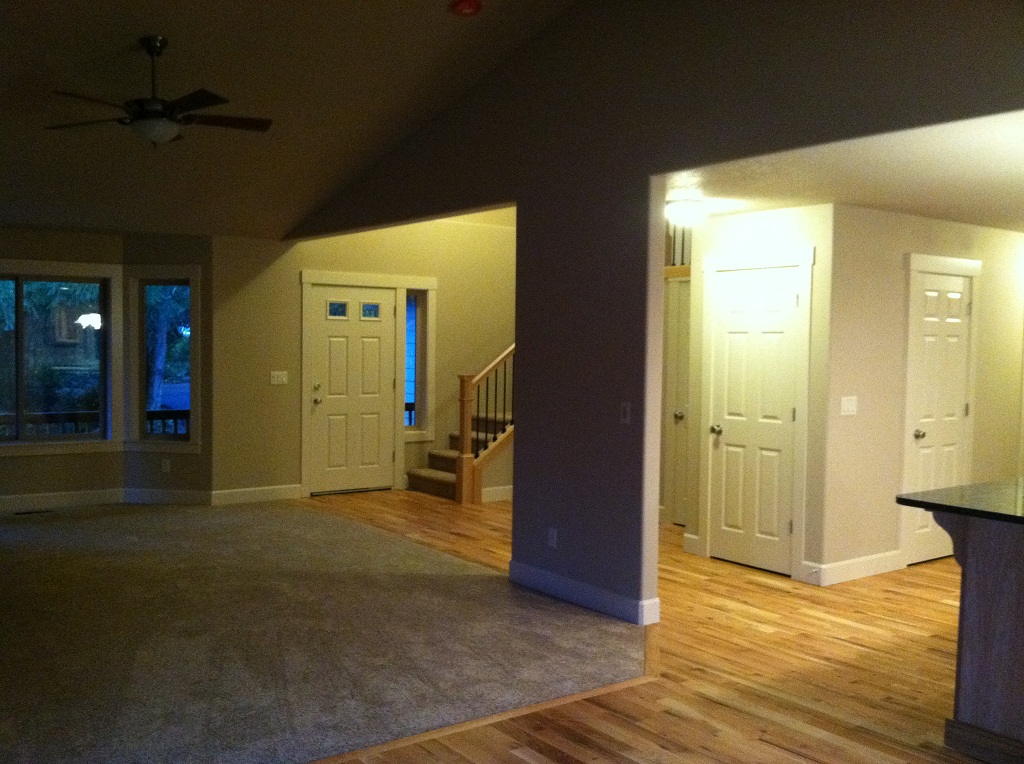

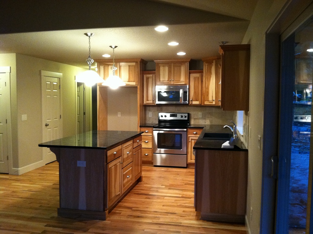

Some pics and suggestions.
1. I went with charcoal granite in the kitchen, it looks awesome. I went with some desert brown in the main and half bath and uba-tuba in the master bath just to be different but would go with this charcoal throughout the house if I had it to do over
2. This #2 oak floor I wasn't sure about, builder suggested it he's got it in his house. This flooring has lots of knots and variations, I have to say its gorgeous, I have had clear oak floors before this is way nicer.
3. I was drooling for Hickory cabinets forever, they will outlive the house Hickory is tougher than Oak, they look great but honestly Cherry would have been a better fit. Cherry fades quickly and is the most expensive but my sister has Cherry and it looks outstanding.
